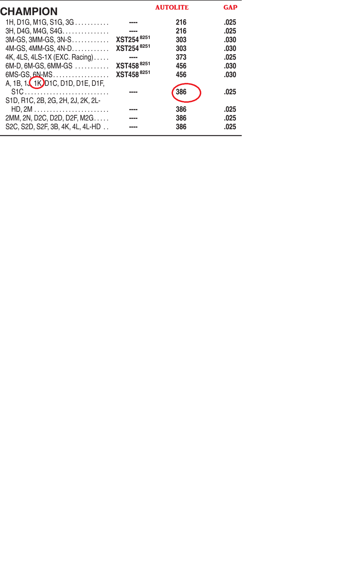

      I recently adopted two Champion Blue Ribbon K1s. I have downloaded the so called manual. It only refers to the spark plug by the Champion part number.
      Looking for a plug number. Any make will do. I can cross reference it.
      #255786
        Here’s the Autolite number. You should be able to cross reference it
        to Champion online.
        Champion-K1-Sparkplug

        JOSEPH BRINCAT
          Champion D-16 … that is from a Champion ref chart. I run one in my Champion J1 , seems good
          Joe B
          #255794
          Ronald Smith
            Thanks.  That should get me there.
