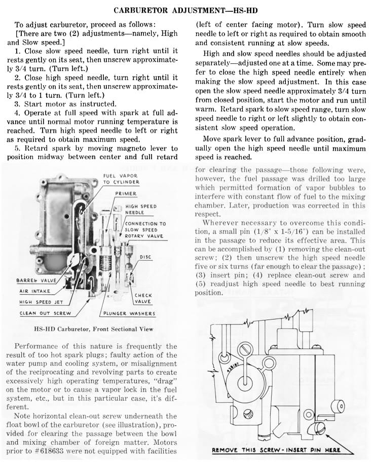

      #227983
        Have you ever noted the page from the service manual regarding vapor lock on these motors?
        Kind of interesting…….
        HD_TD-pg-02-Carb-settings

          #228509
          aquasonic
            Thanks Buccaneer. I have seen that page from the service manual. My HD-25 is from a much earlier serial number 570699, and does not have the clean out screw where a small section of brass rod can be inserted to minimize the fuel capacity within the carburetor. One could probably be drilled, and tapped there though.
