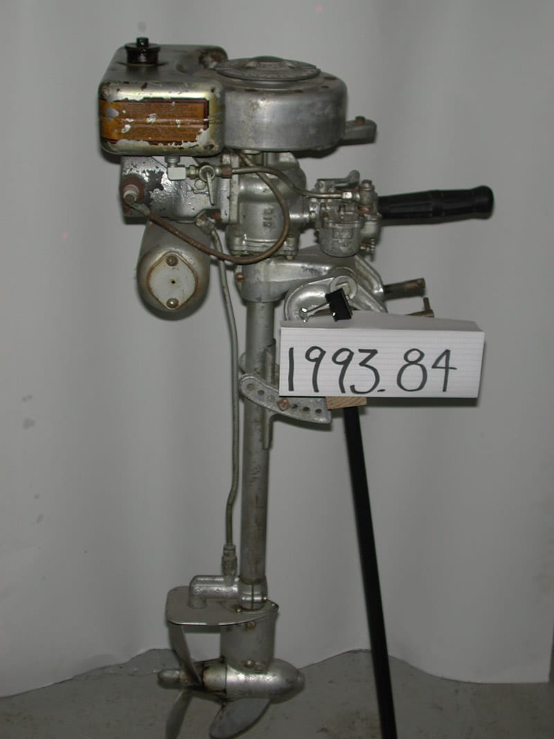

      On this model and year Champion S1D single was the center exhaust tube a Factory option or aftermarket add on?
      Thanks,

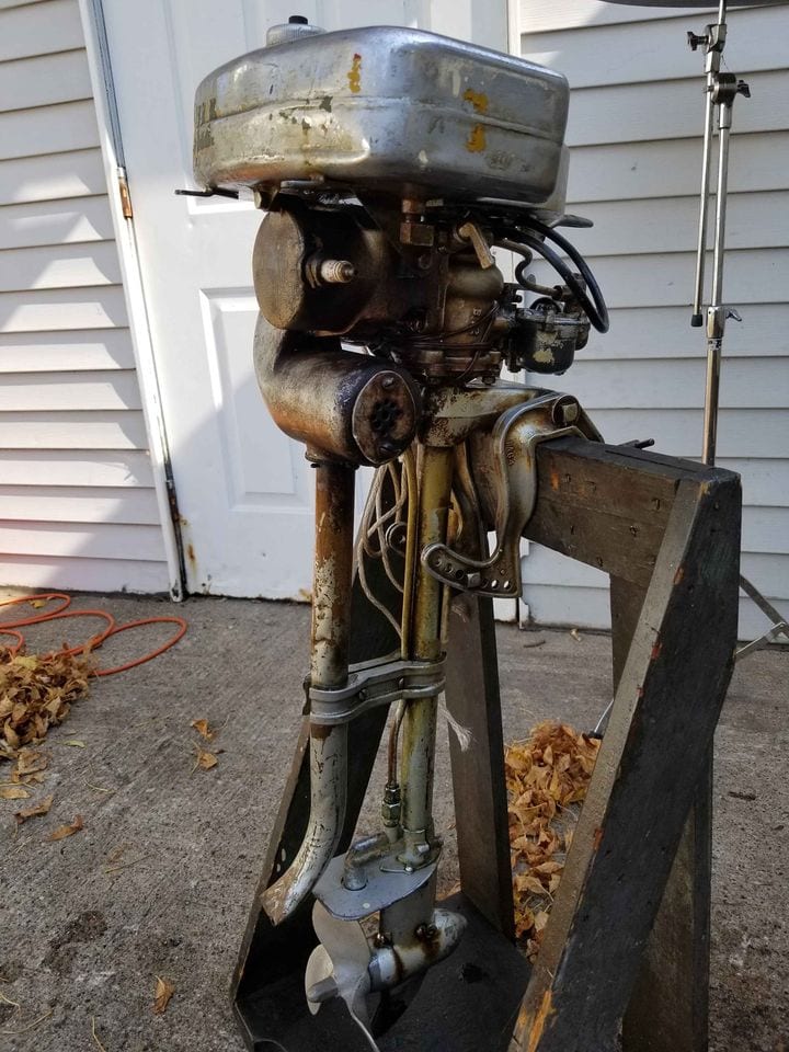

        ROBERT LAFAYETTE
          Thanks Tubs for quick answer!
          My motor does not have
          The center exhaust tube?
          Strange? Although mine
          Is not the deluxe model
          With bigger tank and 3
          Blade prop.
          Maybe only deluxe
          Model had exhaust tube?

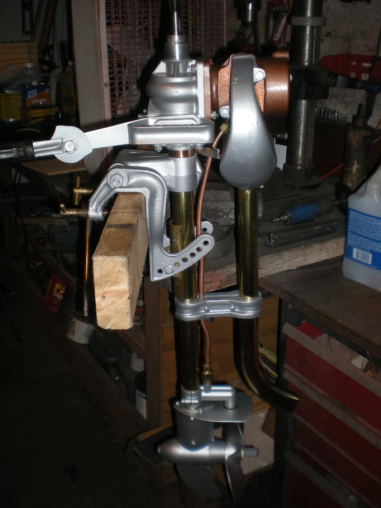

            I have a file photo of a S1D that has no underwater exhaust.
            I have two D1D’s and both have the underwater exhaust.
