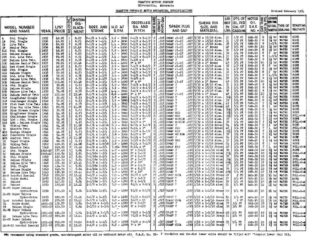

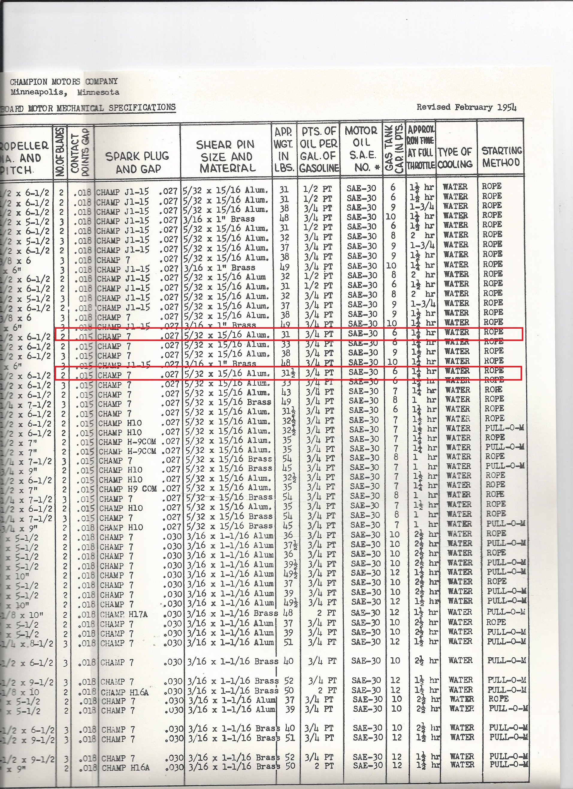

        Dale, I can’t give you a 100% correct answer, but I have some information that may lead you to a correct assumption.
        S1E Champion motor was a Single cylinder
        S1F Champion motor was a Single cylinder
        #82377
        cajuncook1
          #82378
          cajuncook1
            #82379
            cajuncook1
              #82401
              daleh
                Perfect, thanks. Interesting that the only change to get the little extra bit of HP was in increase in RPM.
