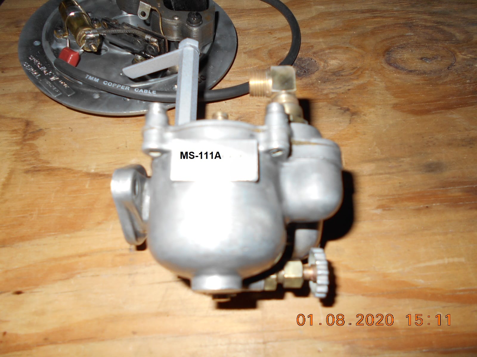

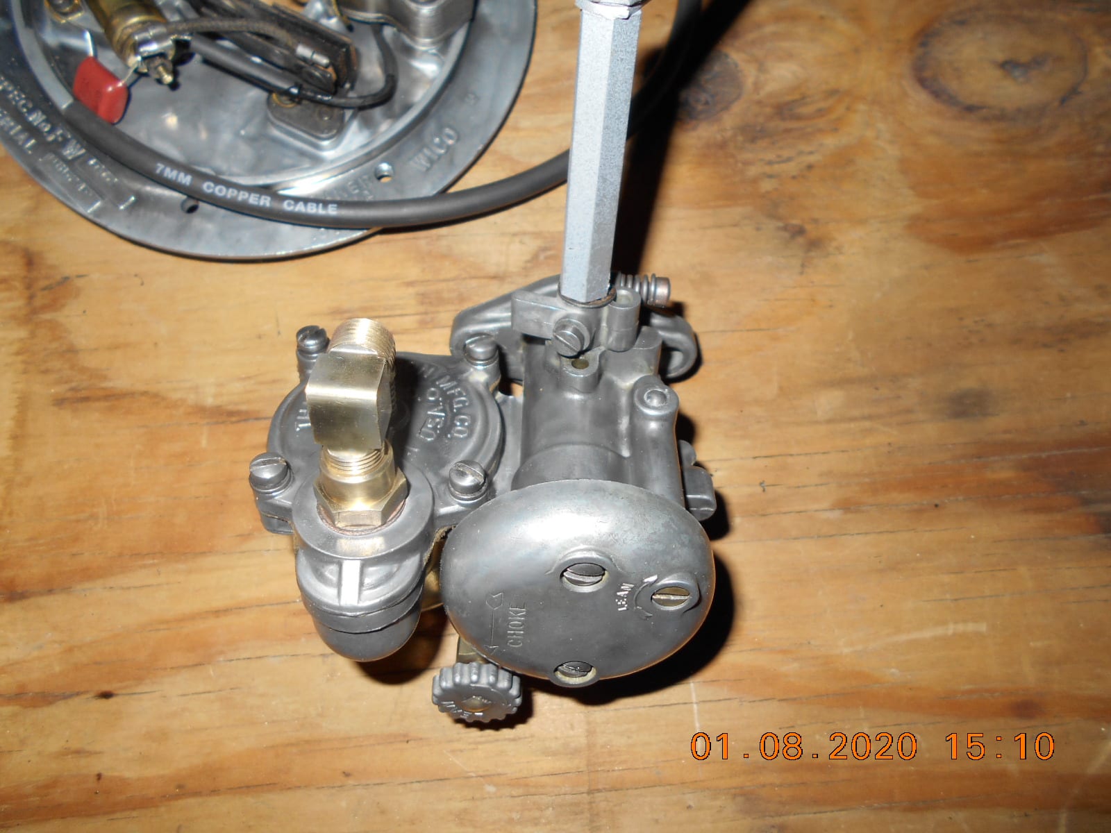

      #232280
        This carb is from a S1F Champion, probably the same thing?
        DSCN8542
        DSCN8543

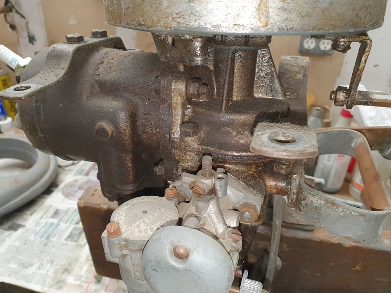

        DAN UMBARGER
          Looks close Buc but there are some differences. Now I find out there is no float/needle and seat. All the bolts and nuts were loose so someone has been in it. It’s a Tillotson AJ2A carb.
          Champion-carb
