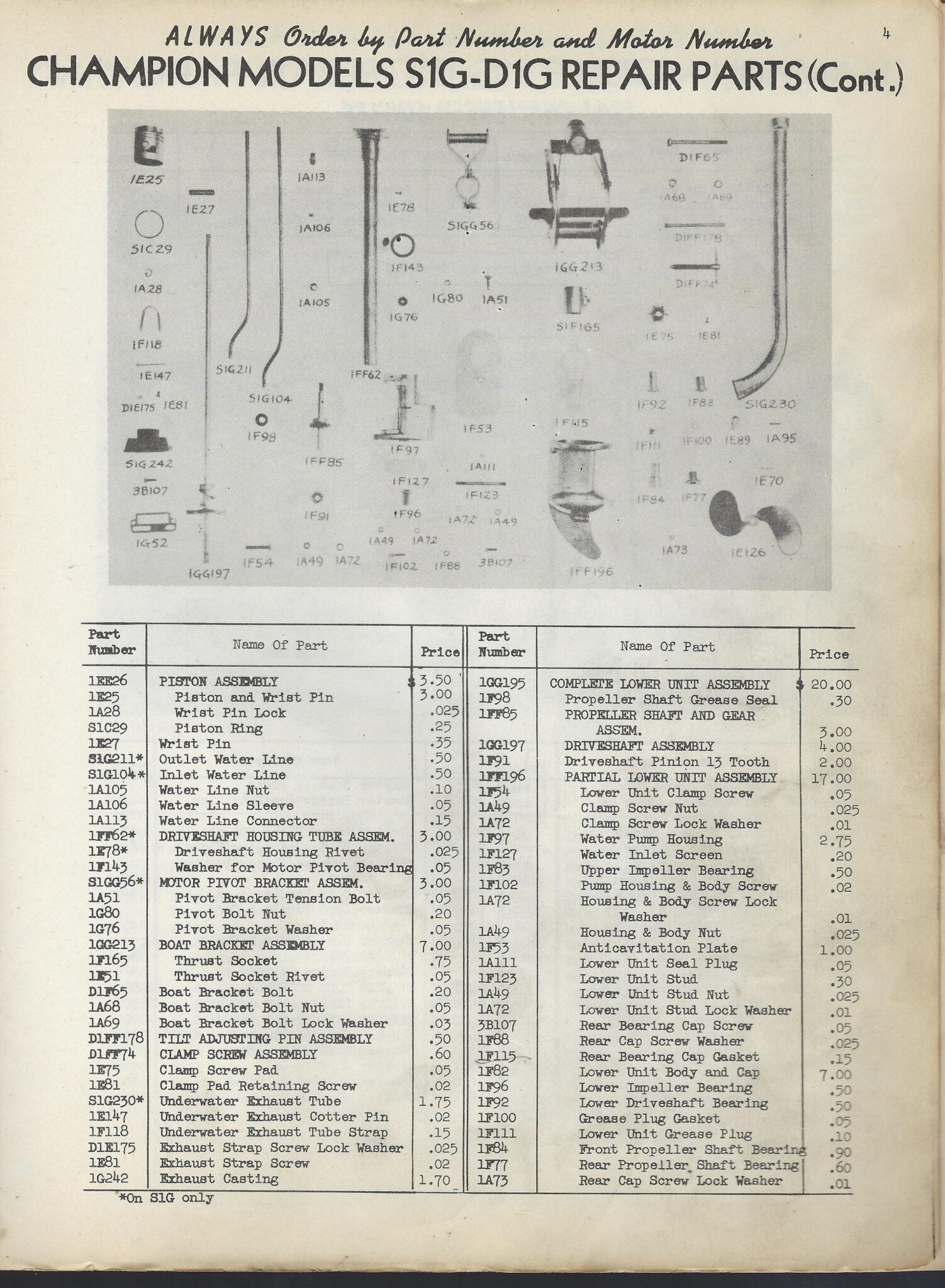

      Not sure where to put this so I’ll start here. I have a Champion S1G that runs but I have some gear case issues. I’m looking for someone that might have a parts diagram for this motor. I got a propshaft cover and bushing assy from Penn’s but now am seeing there’s a lot of damage internally then I thought. Needing to see if I’m missing any parts or is it going to be a wall hanger or a parts engine.

        Hi Dan, I do have a parts list for the S1G but am having trouble scanning it into my computer. If I have no success I will make a copy and send it via snail mail. I did have your contact info at one time but can’t seem to find it now. You can send your contact info to my email at wdm@trcable.tv and I will get it to you one way or another.
