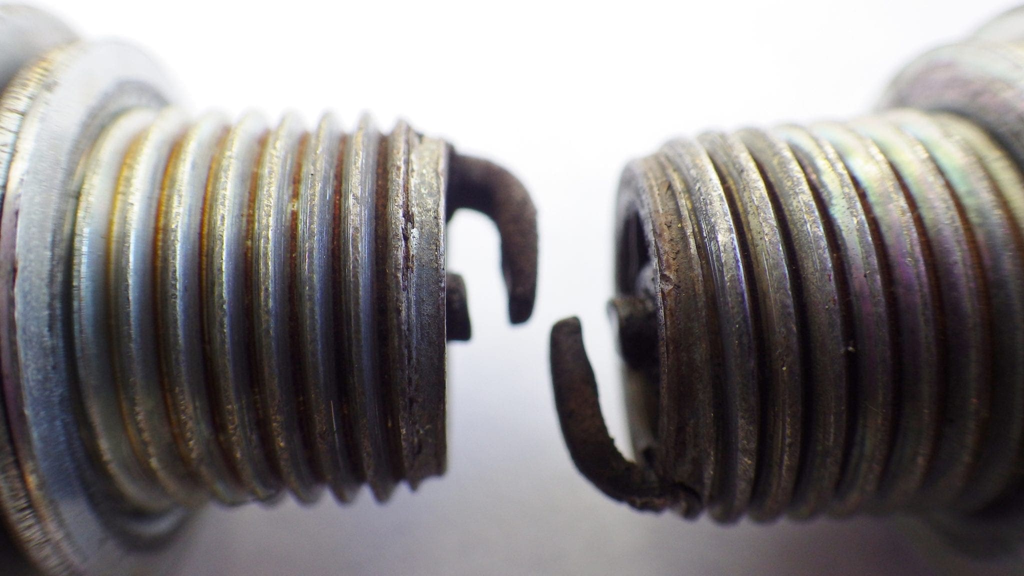

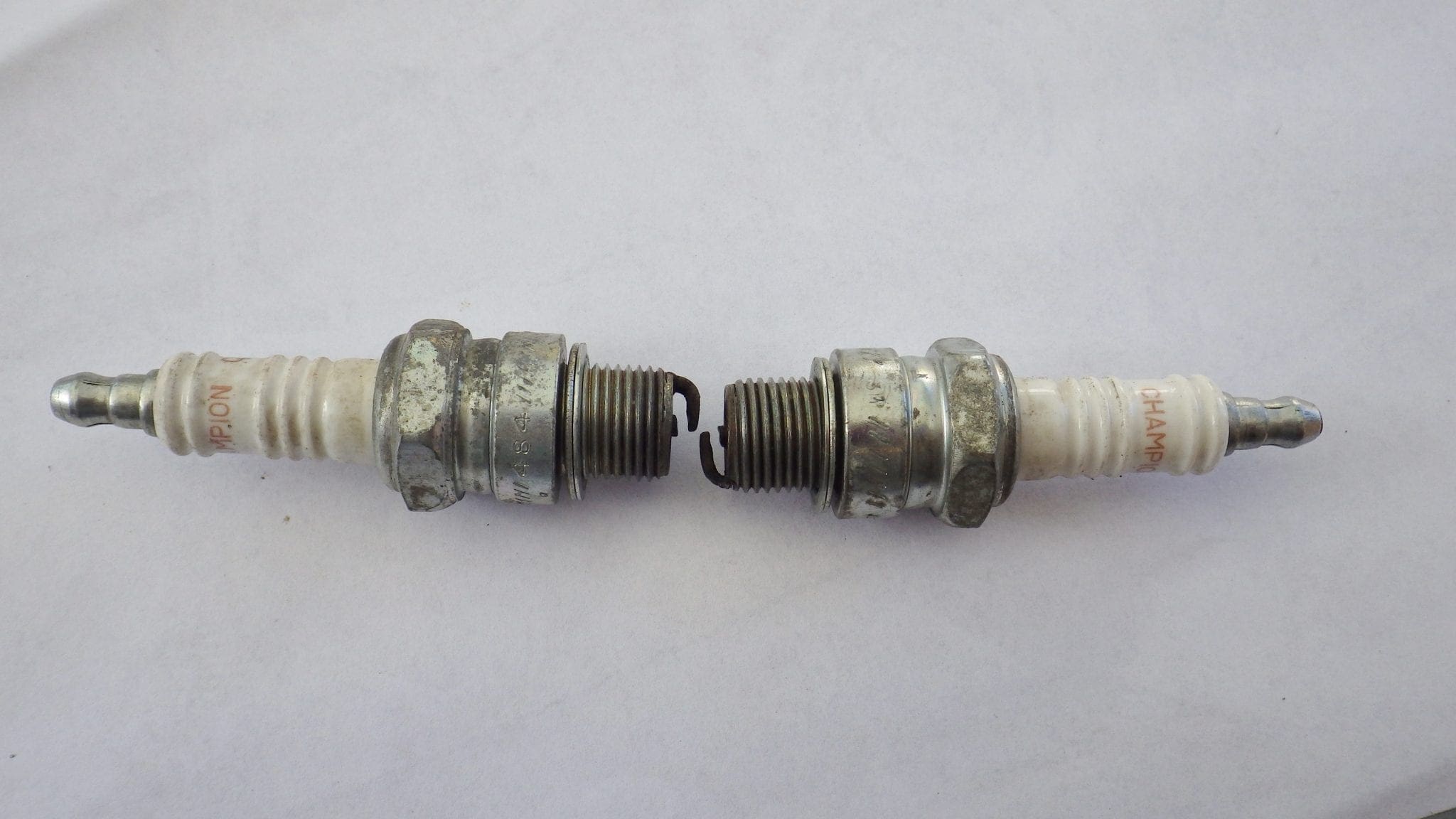

      A friend brought his recently purchased 1980 9.9 Evinrude over today for some much needed maintenance. It ran and started OK but when I pulled the plugs to do a compression test, here’s what I found on the plugs. The electrodes were badly worn and the gaps were near 0.050″ on both of them. They might be the original plugs as they are QL77J4’s and I haven’t seen those for ages. A set of good used QL77JC4’s got it running a lot smoother but I’ll pick up some NGK’s for it tomorrow.

        I saw that wear issue years ago on a 1965 V4 60 HP Johnson. Really old plugs on a heavily used motor. The gap got so wide that the spark found a shorter path to ground across the rotor, establishing carbon tracks on it, necessitating rotor replacement. Kind of like carbon tracking inside distributor caps on cars from the 1950s and 1960s.

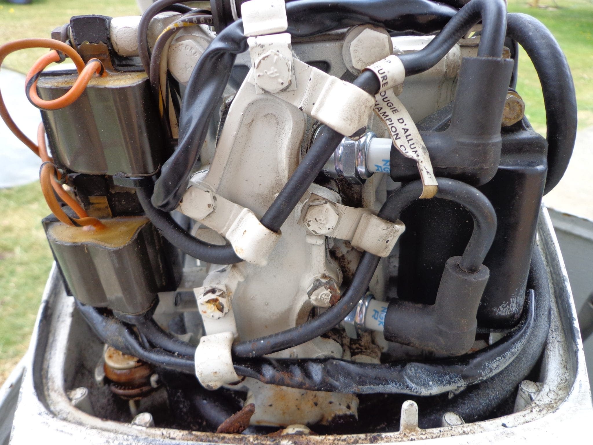

          The owner just picked his motor up and it’s running great except it’s running cold and should have the t-stat replaced sometime. It’s in pretty good shape generally and someone had replaced the water pump recently but I don’t know why they ignored the plugs.
          #178086
            Maybe someone yanked the thermostat out masking a grommet issue…Those plugs look like they have seen a lot of high speed use….
            #178092
              Could be but I don’t think the powerhead has ever been touched. The clamps holding the wiring in place don’t show any sign of ever having been straightened out and the paint on the bolts holding the water cover on isn’t chipped too badly. Just some signs of normal wear and tear from some salt water use. She’s a virgin! The owner will be bringing it back later in the summer to get the t-stat done so I guess we’ll find out for sure then. I suspect it’s stuck in the open position.
              DSC00032
              #178098
                You are right, that cover has never been touched…Never been badly overheated either…The owner should spend some dough to take care of that nice engine, can’t replace them for sure….
                #178099
                  If this is a salt water engine, it is worth spending the cash to do the grommet, before overheat sets in….Maybe the powerhead has already been off to do the grommet, seems unlikely though, you will know when you look at it again….1980 was the second year for the bad grommet set up…
                  #178114
                    I’m pretty sure it was mostly used in fresh as I didn’t find any real corrosion issues on it. The gearcase and pump bolts came undone quite easily and everything had been greased. It had been taken care of.
                    I’m sure the grommet is OK and it’s the T-stat which needs attention as it flows water well out of the telltale and it also starts pumping like a garden hose out of the idle relief in 10-15 seconds once everything inside is filled up. All of my other 9.9’s take close to a minute for the stat to warm up and open before any water comes out the idle relief ports. When the owner was here yesterday, it wouldn’t get any warmer than 78 F while running in gear at a fast idle. It’s running too cold.
                    I gave him a list of the parts needed to remove the powerhead to get at that grommet so if he picks them all up, I’ll do the grommet to while it’s in. It will give him peace of mind knowing all is well.
