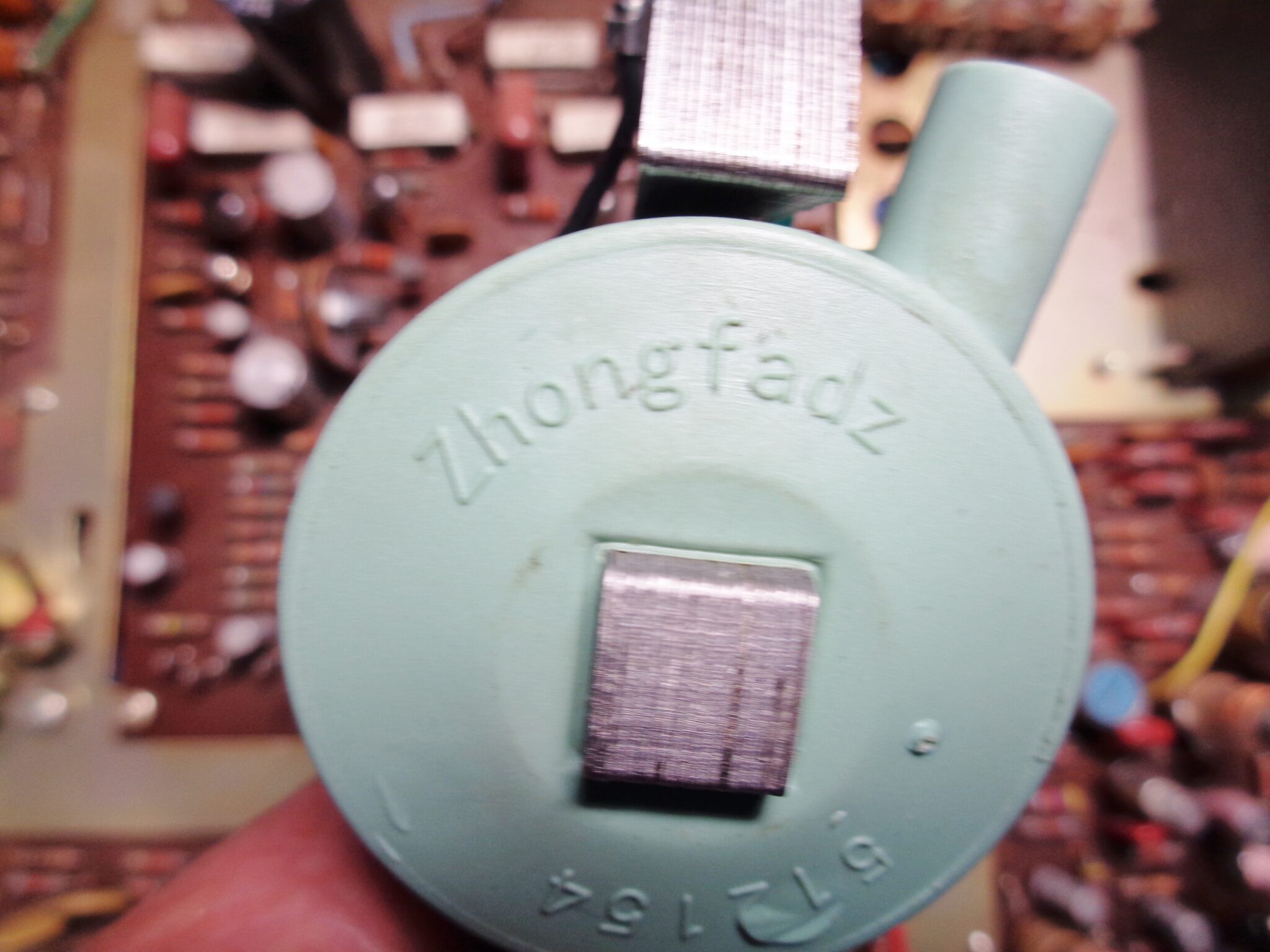

      just installed a pair of coils on a 4hp … I was surprised to find 9Kohm on the HV secondary
      so many windings could certainly boost the sparks yet they could also be fragrile . 4 —-7 kohms is usually what I get on coils so time will tell
      Mumbles …this was your picture of same coils…. did you get 9Kohms ??

                I’ve used over sixty of the black Ebay Zhongfadz coils now without any failures. Most of these were installed on my own motors with a few on other peoples motors and no one has come back complaining yet. Knock on wood!
                A couple of Amazonian ones I picked up a month or two back were green and I could swear they came out of the German Prufrex molds. The ohm readings on these ones were higher than OMC/BRP coils, around 7.8K, just like the black ones.
                DSC00416
