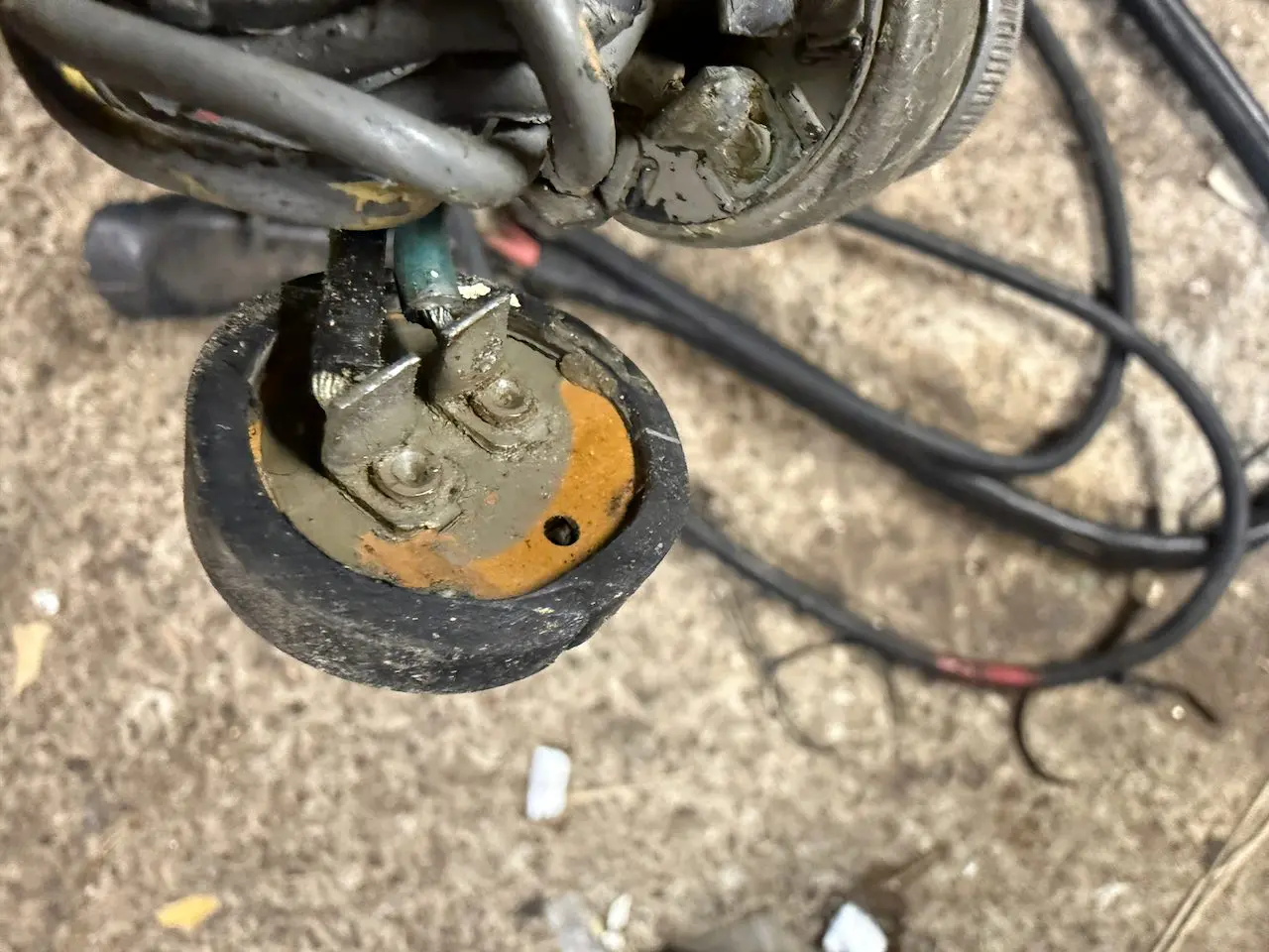

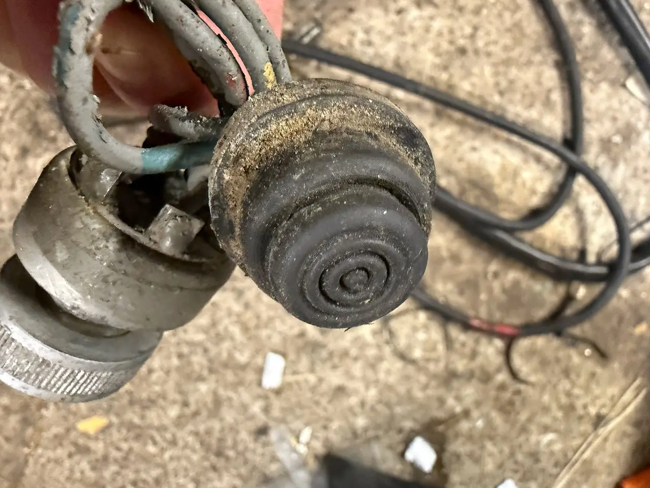

      Can anyone tell me the part number and/or a source for a replacement choke button for the old single lever control boxes? Thanks for any assistance.

          Try removing the boot carefully and see if the contacts can be cleaned/sanded.

            Agree with above reply clean contacts up make sure all connections & wiring is good.

              Yes, see if the contacts can be cleaned. If not, it is part number 29759. I know MarineEngine stocks it.

                Thanks for the responses!  I’m trying to rebuild a box that’s missing the choke.
