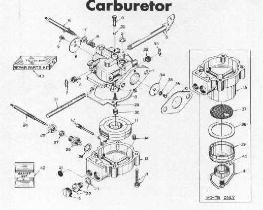

      Hello, my name is Griffin my father has purchased a Chris craft challenger outward motor.   I was wondering, if any of you knew how to remove the smaller frontal controls?  We removed all of the larger screws, but we do not know how to take off the small frontal controls that pass through the cowling.  Any advice provided would be greatly appreciated thank you for your time. G
      #289295
      CHUCK
        It looks like the low and high speed shafts are threaded at the outer ends.  Is there a nut holding the knobs on?  If you have the side cowlings removed you will see how the choke shaft connects.
