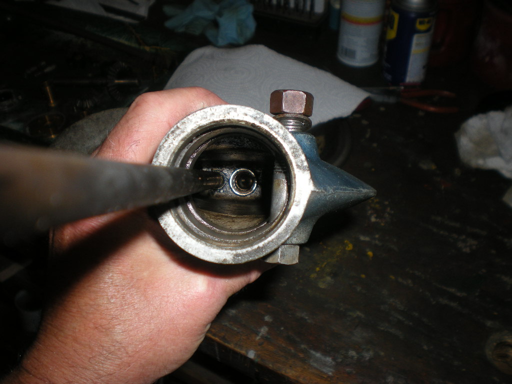

March 15, 2017 at 1:58 am #54348Ben, I went through my Challenger last year.
I got the new prop shaft seal and impeller from
Lee Holland, as well as a couple of bolts holding
the gear cover on. The were already butchered
up looking phillip head bolts, but then I found
out they’re not phillip head…… forget the name,
but Chris Craft, the boating industry, and I think
aviation used them. Ended up buying two 3/8"
drive "drivers for those special screws……as
I put the first one away in a special place……
and never did find it again!
The top photo I had labeled "drive shaft seal",
but I can’t remember if there’s actually one down there!
P.S.- Mine is the best idling outboard I own!Prepare to be boarded!

March 15, 2017 at 2:10 am #54350Thanks for the pictures Buc! That helps me some. Mine, I’m guessing, is an earlier model? I have an eccentric rotor-type water pump instead of a flexible vane type impeller. The main difference I face right now seems to be the eccentric for the rotor that is somehow affixed to the prop shaft. I’ll end up needing some screws also. One of mine is good and the other is pretty messed up. Probably various other items once I get deeper into it. I’ll have to get a picture of mine tomorrow night.
