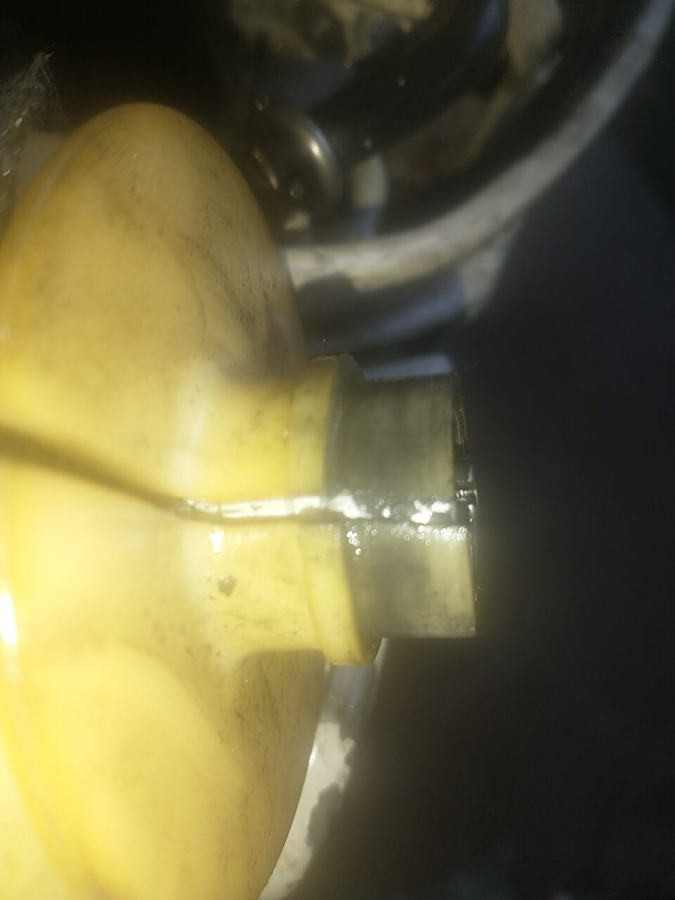

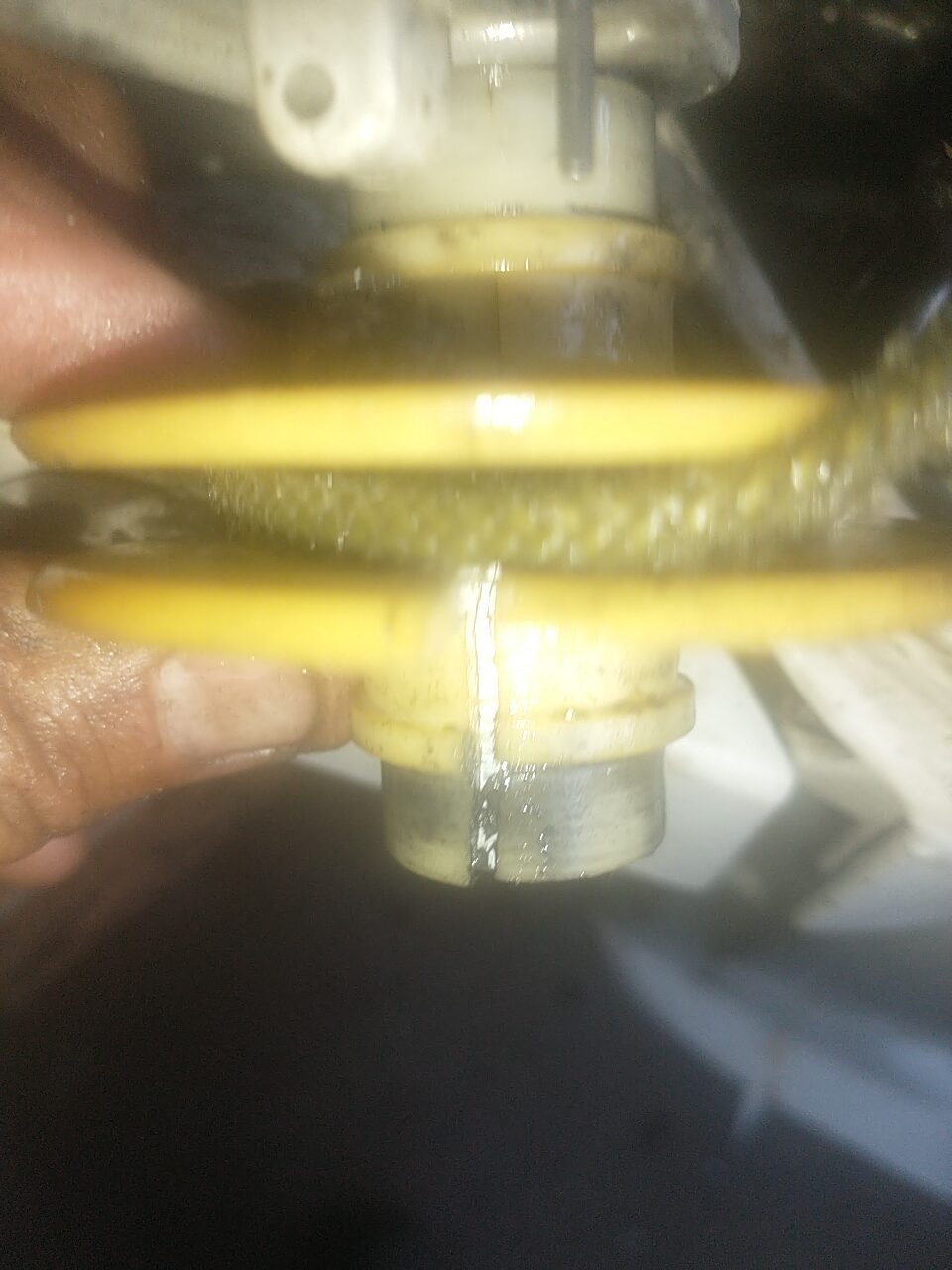

      I just pulled out this 6 horsepower Chrysler from 1973 and the full rope recoil is very very stiff and hard to use.
      It really doesn’t want to retract the rope.
      I pulled out the recoil ..fairly easy to do.. and it looks like the bottom plastic part of the round rope holder has split see attached pictures..
      Is this a common problem?
      Furthermore how do you get the flywheel off of this little white monster I don’t see any holes for a puller.

        Awhile ago, I brought a Force 15 back from the dead, which had that type of manual starter. My pulley wasn’t that bad but it WAS cracked. I also had to replace the spring, rope and the pinion gear. I spent more on the recoil alone than the whole engine was worth but hey, it is a great runner now and that’s all that matters to me. Those recoils are horrible, in my opinion. To get the flywheel off, you can either use a flywheel knocker (DON’T just pound on the crank shaft. There is a big difference) or you can drill and tap the three indentations on the flywheel for 1/4-20 screws and use a puller. Don’t drill into the coils. Be careful.

          Everything about those recoils is likely to be a problem. Marinengine has some of the stuff but prices are not appealing. Whatever else, best to treat the starter very gently. Most will have a sheave for an old-style starter rope. Best to take one along….
          My experience with those Wico and Wico-clone flywheels is that some are drilled and tapped for a puller, some have a molded-in hole that can be tapped, and some just have a dimple to locate where to drill and tap. In the latter case I would probably take the wheel off with a knocker the first time, then drill and tap, preferably using a drill press or mill.
