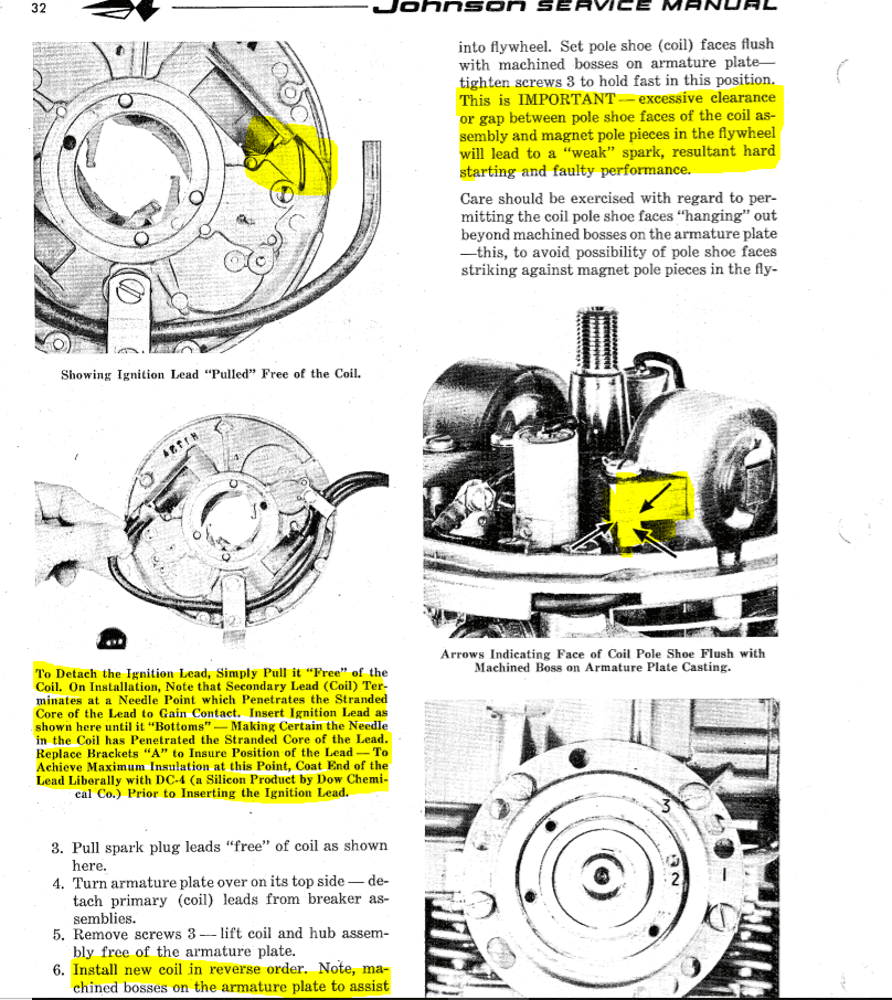

      Received new original part number coils. Receiving post sending charge from internal flywheel mag sticks out further than original. This results in post striking mag stopping crank rotation. There should be a specified gap between mag and coil post. what is that gap spec, further more how to fix problem?. Thanks for looking.

      Steve Martin
        Set the laminate edge flush with the boss on the mag plate, or get the setting tool from Richard White

          or use your fingernail if it snags…on the coil laminates push the coil further back !!
          #210846
            see pictures
            coil-wire-2
            coil-edge

              Thanks all, good info, should take care of problem. B2
