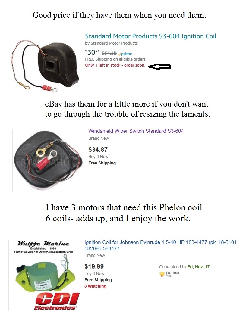

            Standard S3 604 at RockAuto will fit . Its not too hard to convert to OMC coil. Out of stock at Rockauto but Amazon has them fro $34.95

                  I have installed the OMC coils on Phelon cores they work good but the wire routeing is tight. I don’t see how you can beat the Amazon price for S3-604 coil.

                    I see the amazon dealer only has one left. Ebay has them for $41+. Summit racing has them for $35

                        quote mercuryman:
