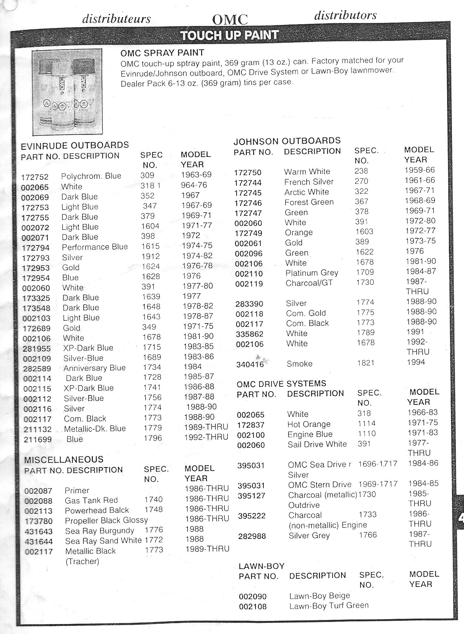

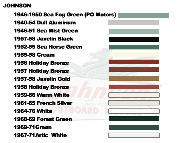

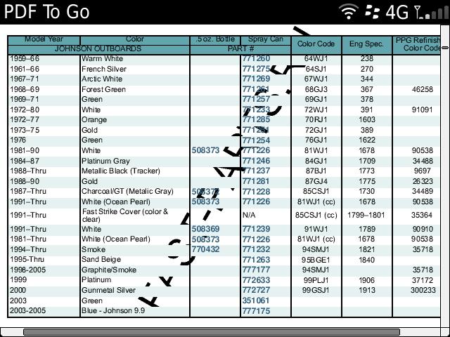

              Here is a list i found. The the 1975 and 1976 colors are close, the 1975 has some slight gold in it. Maybe someone has one of the Product Bulletins from OMC about shaking the paint for a better match. Maybe Mumbles can clarify these years Green and Green/gold
