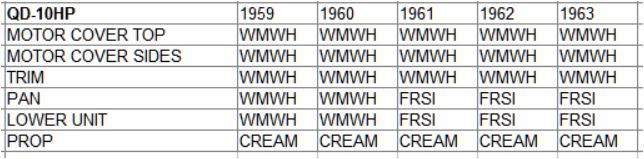

      I’m getting ready to paint my Johnson QD23. I know the colors are Warm White and French Silver. However, I’m not sure what gets painted what color? I assume the cowl is Warm white as is the engine itself. Anything else Warm White or is the rest French Silver?

        Here, this should help you out.

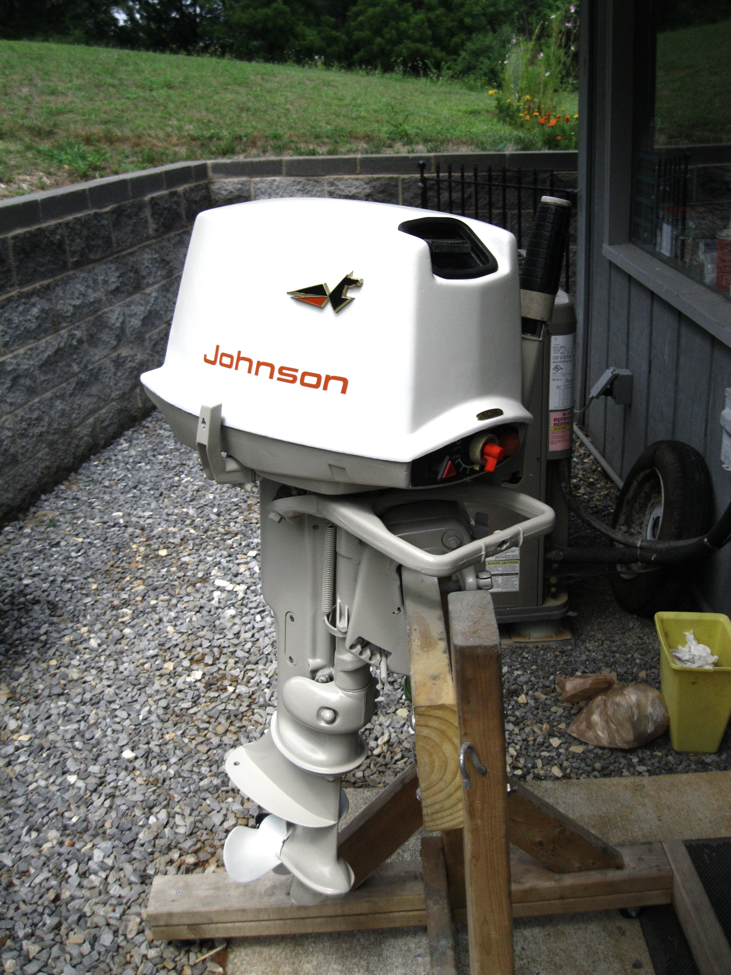

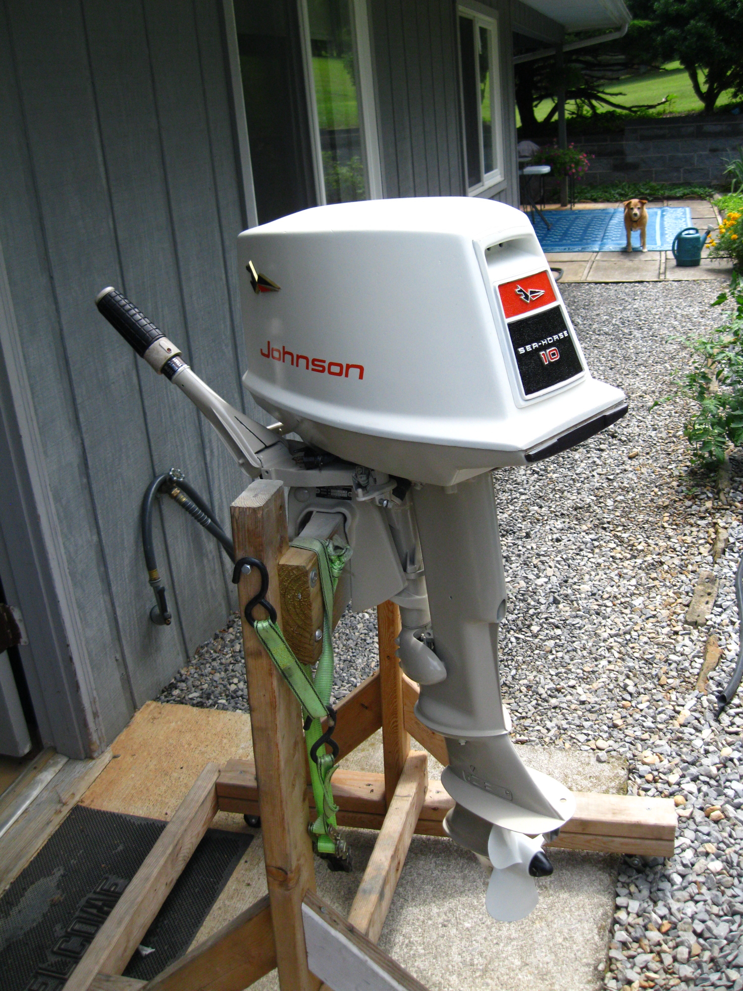

            Finished results!
            #41459
              spectacular to say the least !!!
              #41460
                Lookin Gooood ❗ ❗
                You have done well.
