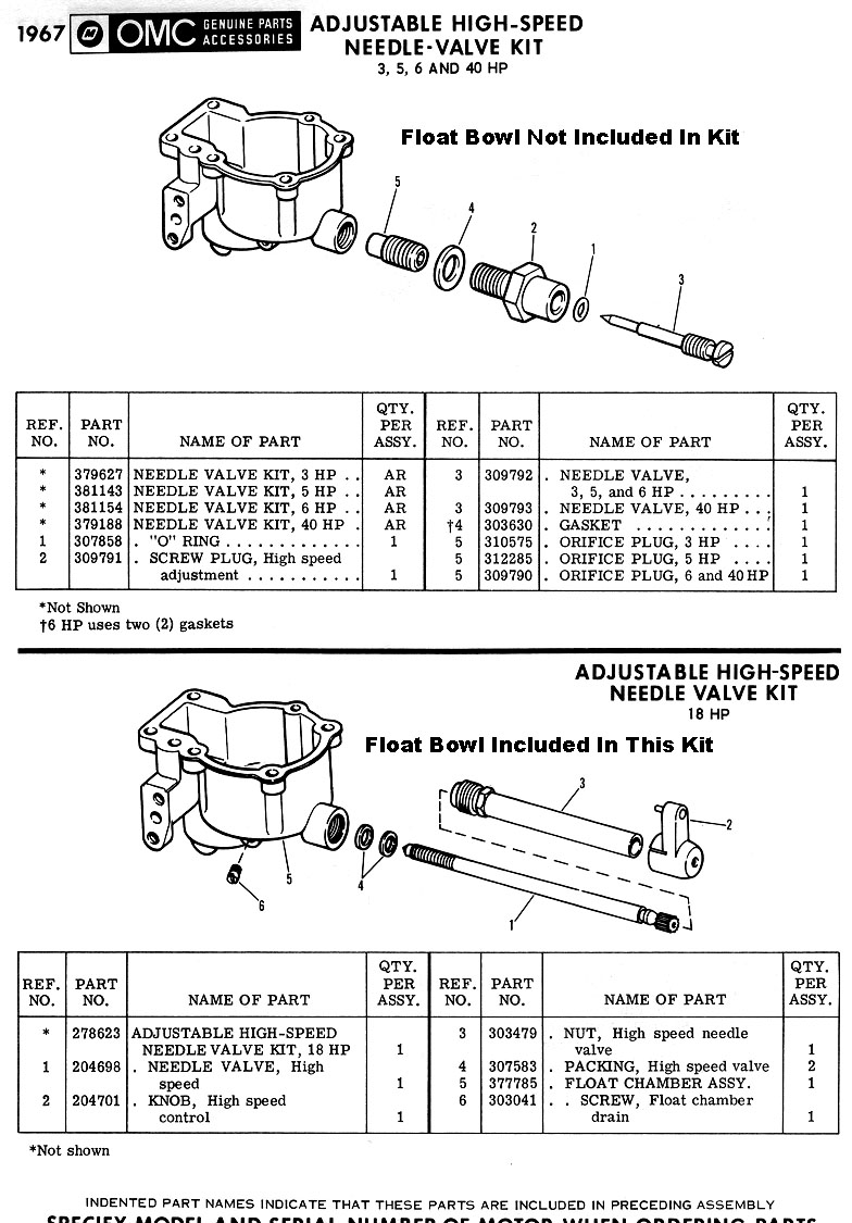

But the fixed main jet does NOT seem like an improvement to me. I can see some advantages, especially in the hands of users who don’t know how to adjust mixture, but as a long time engine tinkerer I like the ability to optimize the mixture for different conditions.So, finally getting to my "ask," what is needed to convert OMC carbs to an adjustable main jet, and is there any strong reason not to do it? Can an older float bowl be swapped on? Can the existing one accept a needle and it’s gland and packing? (Not considering here the need to drill some sort of access hole in the pan…)
October 8, 2016 at 3:32 am #45421If the original jet is correct for your elevation and hasn’t been reamed or drilled out, it should work just fine. I’ve never tried switching the bowls but I don’t see why that wouldn’t work. OMC did make kits for their fixed jet carbs to make the high speed circuit adjustable. Either way, you’re going to have to drill a hole in front to access the needle.

October 8, 2016 at 8:00 pm #45453I would agree with the original posting, for the most part, the 6hp models are in general, an improvement of the 5.5hp models they replaced. I think you are thinking of the 10hp models when you refer to problematic wrist pins with no bearings. Like Dan says, plain wrist pin bushings are not a problem on these smaller engines, even at 50:1. I have never seen one of these engines with any wrist pin wear issues.
I have never had any calibration issues with the fixed high speed jet on these engines. Like Dan says, running the engine at higher altitudes would be the only reason to consider swapping over to the adjustable needle/bowl set up. Keep in mind that the 6hp engine pan will get in the way of the adjustable needle, making the adjustment process a bit more inconvenient to perform.October 9, 2016 at 3:26 am #45480The 6 hp seemed in such good shape that I popped it in the barrel as-is and it ran pretty well. Of course it needs to be serviced before any serious use.

October 9, 2016 at 12:59 pm #45499I have several of the ‘High Altitude’ kits for the small motor which is the adjustable high speed needle insert. Send me a PM and I ‘ll mail you one.
