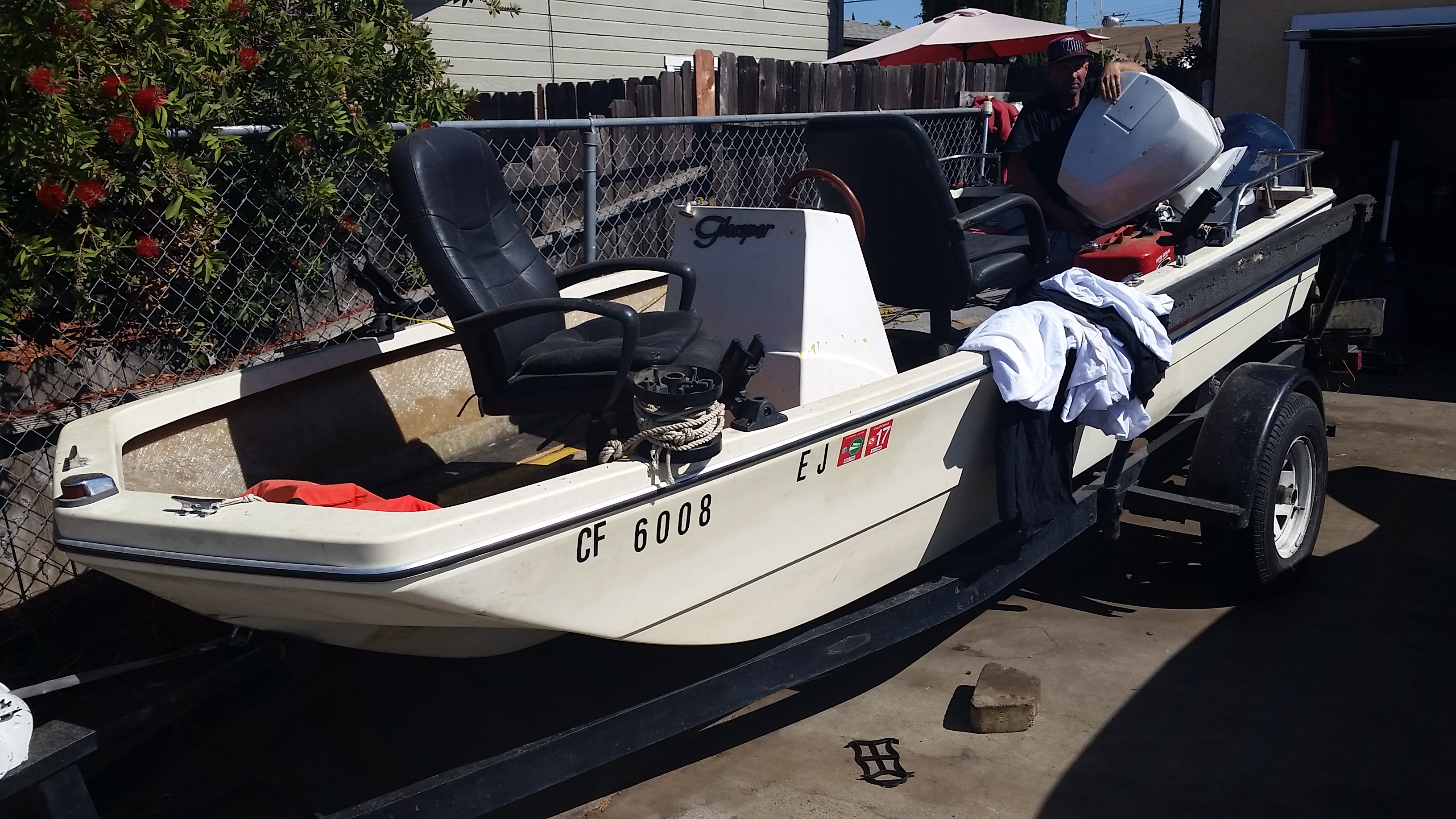

Robbie RobertsonOctober 27, 2016 at 5:05 am #46546Than you for the response! The max hp is 90. The boat is about 14′ long. The hull is fiberglass, and there doesn’t appear to be any water in the foam, but I don’t know much about its history, so I suppose that could be a possibility. I am located in Sacramento, CA. Attached is a photo of the boat.
October 27, 2016 at 6:02 am #46547All boats do what yours does, to a greater or lesser extent. Speed control between making a hole in the water and planing speed just doesn’t exist. What does exist is the great variation in what it takes to get it up on plane, and how slow you can go without sinking back into a hole. After planes are often called trim tabs. Am I seeing a Whale Tail on the motor? Same purpose. If that is what I’m seeing, somebody else was unhappy with the performance too.
