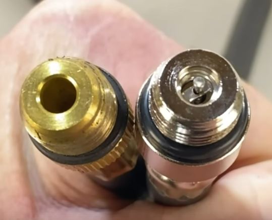

                Please remember that compression gages are notoriously inaccurate on little engines with small combustion chambers, especially if the gages have long hoses and valves…
                #294492
                CHUCK
                  Great point Fleetwin.
                  There are compression testers with the schrader valve at the spark plug end of the hose.  Those are said to be designed with very small displacement engines in mind….to minimize the error induced by long hose models with the valve at the gauge.
                  Compression-Tester
