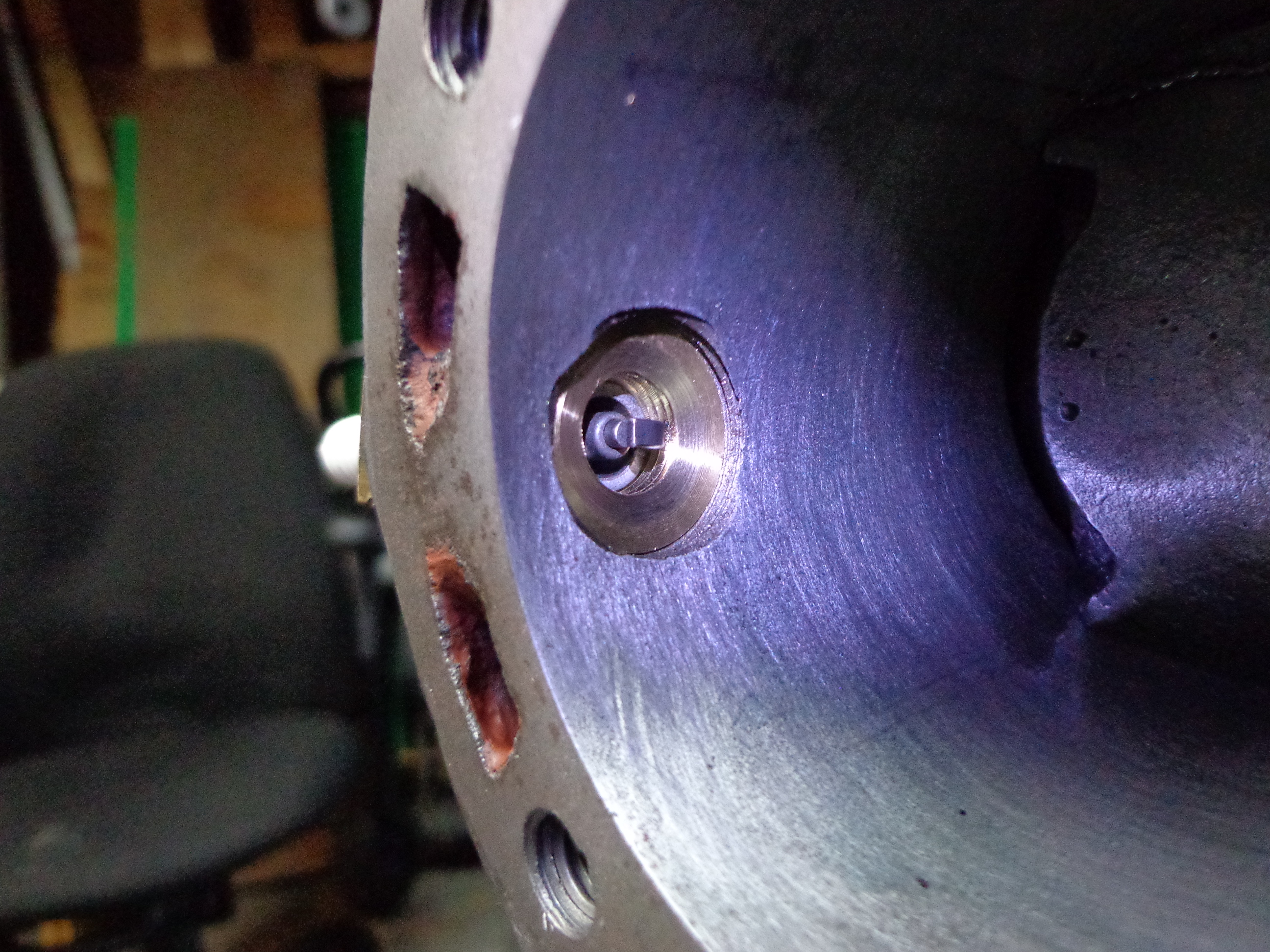

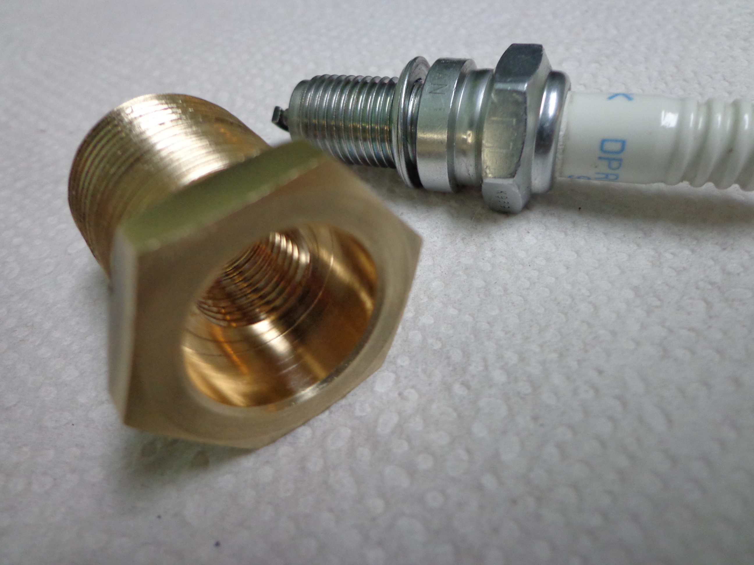

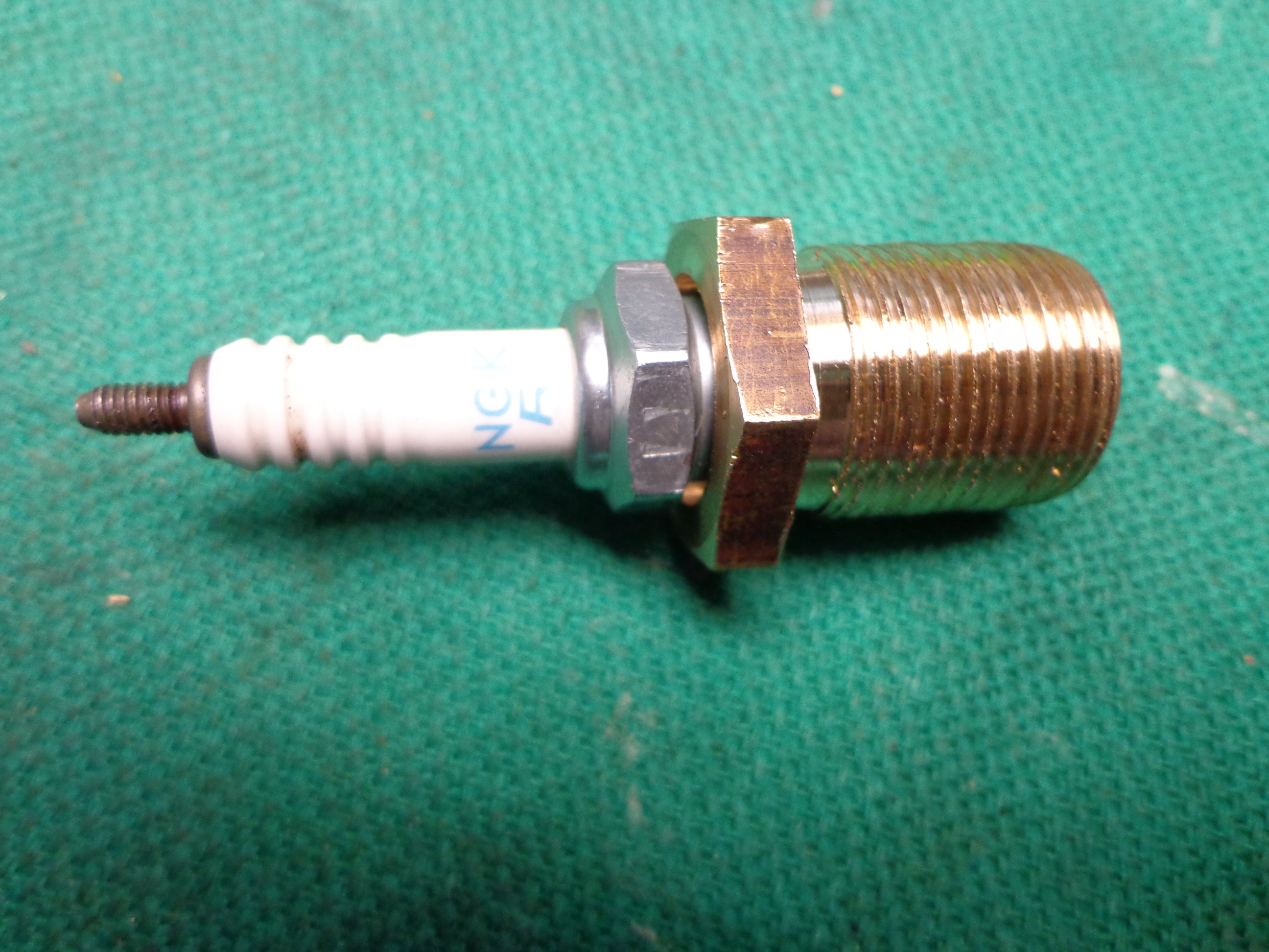

              By making these brass adapters for an old motor with large spark plug threads, I managed to kill two birds with one stone. Not only can I run modern, off the shelf plugs now, but I can also use my compression gauge. But like Dave mentioned, you can probably make one out of an old plug to.

                #71303
                  Mumbles, nice looking adapter.
                  My Logan lathe doesn’t know metric,
                  so how do I tell it to make me an 18 mm thread? 😕
