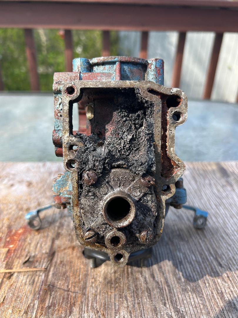

            aquasonic
              Sooner or later we all have to do some “coal mining”. Pictured is a 1956 Evinrude Lightwin.
              1956-lightwin-carbon

              #290917
                I’m 78 and  got to experience that garbage. It fouled the plugs, plugged all parts of the exhaust, pieces would drop back into the cylinders and score them and the piston’s. I get a great deal of enjoyment continuing to use stuff from the past but I don’t want any part that stuff.  Tubs

                  #290931
                  Monte NZ
                    Thanks for the excellent photos Tubs ……they are a real eye opener. I haven’t seen such a pile of carbon ever!
                    Monte NZ
                    #290943
                      This is out of the 1929 Sportwin NF I did last winter. Took a couple hours to get the baffle plates out so I could just scrape off what I could get at easily. This it typical for the motors I’m into. If you didn’t find your motor full of this crap, someone had cleaned it out, or you motor was never run much. Are vegetable base motor oils something that would be substituted for petroleum based products in your part of the world?    Tubs
