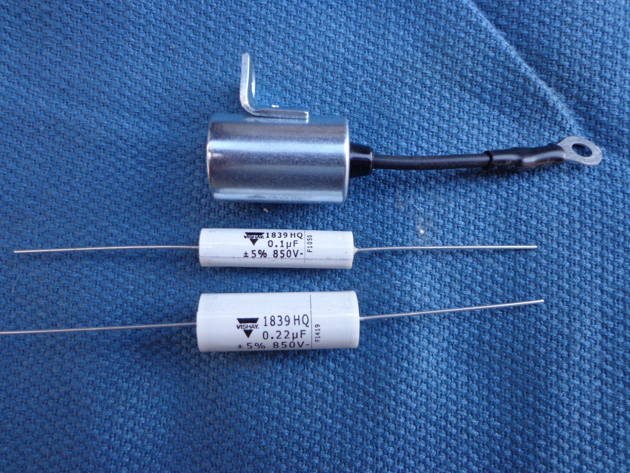

          580321 is the P/N for the Evinrudes condensers, available from your friendly neighbourhood OMC/BRP dealer. It’s the top one in the photo. Not sure about the Mercs.
          DSC01376

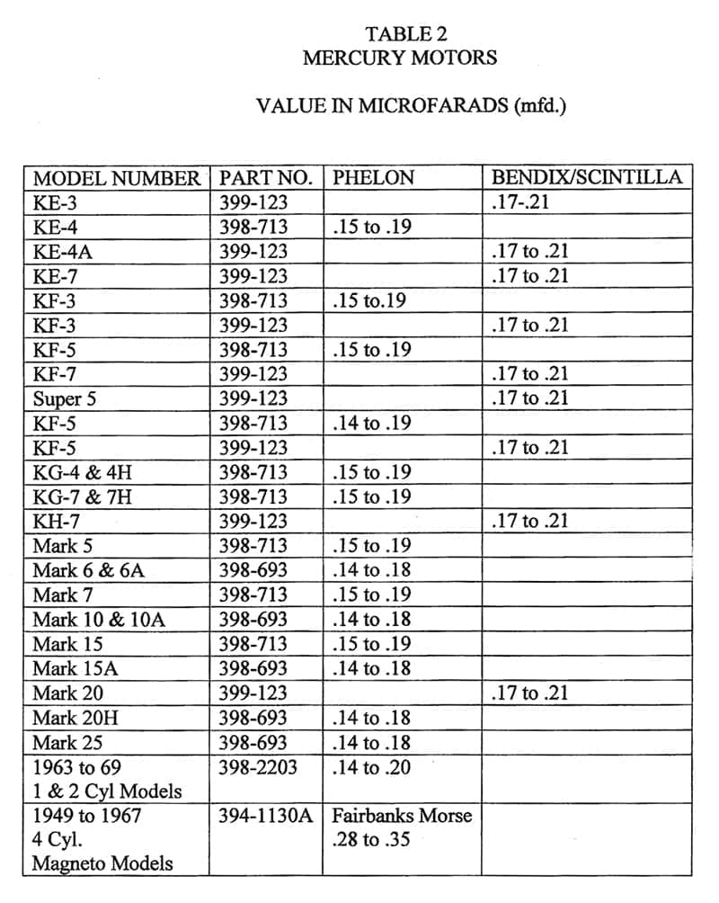

              Hey James, I found the table for Merc condensers and it shows you need a cap with a rating of .15-.19 uF for your mag. If you can’t find an original, Digi-Key has modern film caps which can be adapted to outboard magneto systems.
              Here’s a link to the .15 uF ones.
              https://www.digikey.ca/products/en/capacitors/film-capacitors/62?k=bc2608-nd
              Caps-Merc

                Thanks for the info will keep it for future reference but my motor is a K4 with a Eisemann magneto.
