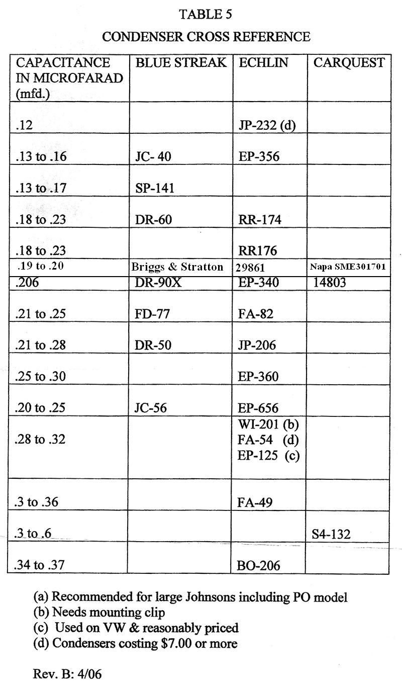

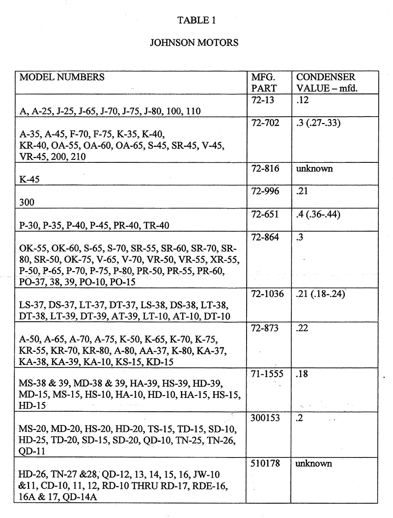

      Is there anything from my local car parts store that can be used as a substitute condenser for a mid-late 30’s K series Johnson?
      #71095
        You can try these charts to match something up.
        #71099
        Doug Wilson
          i have had good luck with both my A50 and K50 using a condenser from a 60s Chevy both motors seem to run fine with them. I used the original condenser plates to make a pattern for a cover to hide the new ones
          Doug
          Doug
          turned off?

            Doug…..60’s GM is an RR176. See above….
            Antique NAPA/Echlin person here. 😀
            Jim
            #71113
            bjensen64
              All, thanks for the info, I’m downloading a copy of that sheet for sure!

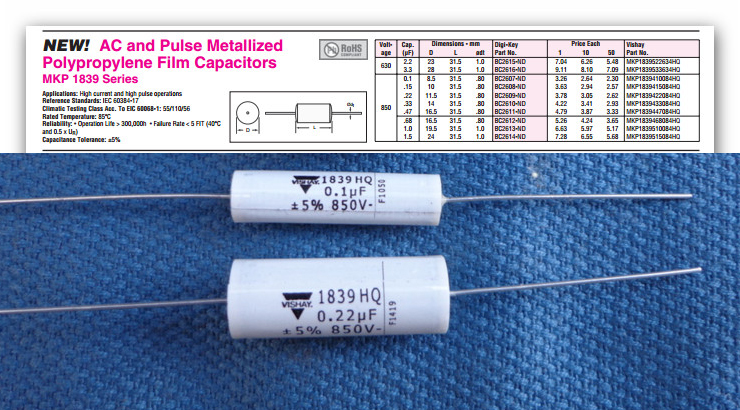

                Mumbles found these and they work great.
                Bob D
                #71124
                  Here’s a link to Digi-Key for the .22 uF axial caps.
                  https://www.digikey.com/products/en?ven … =bc2609-nd
                  #71126
                    And you ca mount them in your gutted condenser can with the original wire to look like original. work and last better.
                    #71137
                    bjensen64
                      Good stuff about stuffing a modern cap in an old can, thanks.
                      #71138
                      squierka39
                        Thanks for the chart and the capacitor pic, I’ll need a handful of these at some point.
