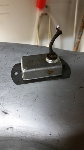

      Here is a pic of one of the original condensers from my K-80. Anybody have pics of opening it up and re-stuffing it?
      Do some of you use an automotive replacement and just mount it in the recess of the mag plate where the original one goes?
      Appreciate everyone’s feedback.
      #71146
        I would see about cutting in from the back. that way repair would not be seen. I have never worked on one off those I am a merc Guy.

          I remember checking those cap, Jim is correct, What are you using for a coil? :mrgreen:

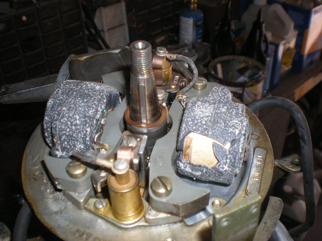

                Has anyone tried stuffing an axial cap in the Wico style condenser as
                this Martin mag has?
                I’ve gutting this style Wico condenser and put orange drop style
                caps along side, but have not tried stuffing an axial cap inside of one.
                Not sure if I’d be successful drilling a tiny hole inside the Wico condenser
                threaded top post, then install one wire end of axial cap into the hole
                and solder it, and still be able to put the screw back in for the points
                connection?
                #71159
                Tom
                  I’ve done a few of these by removing the bottom with a lathe, removing the guts, and installing new condensers. The bottom can be soldered back on. One lead goes up along side the post for the screw, and gets soldered to the post on the outside. The other terminal goes through a hole in the bottom and is soldered in place after the bottom is soldered back on.
                  They work really well in a Martin 20, 75, and 200.
                  Tom
