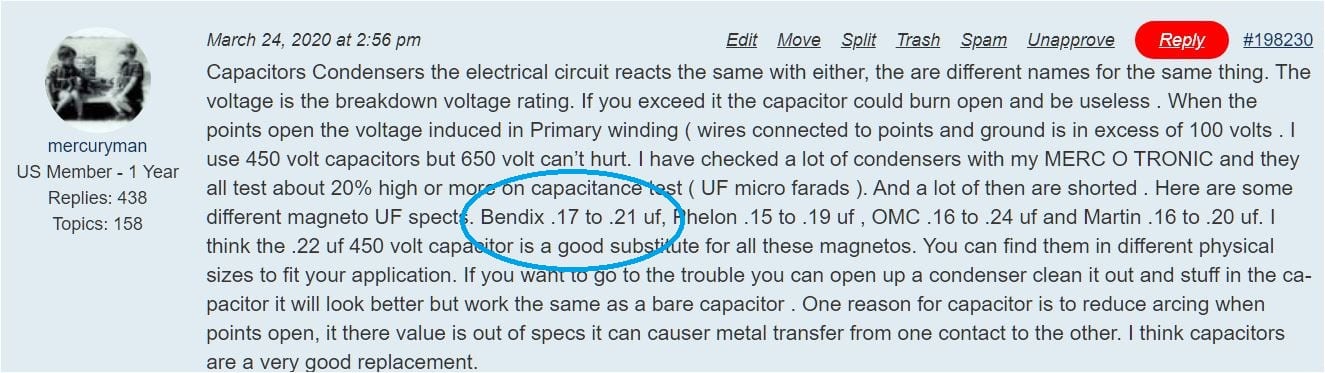

          .17 – .21 uF? The older they get, the higher the uF rating goes as they start breaking down.
          Bendix-Caps
