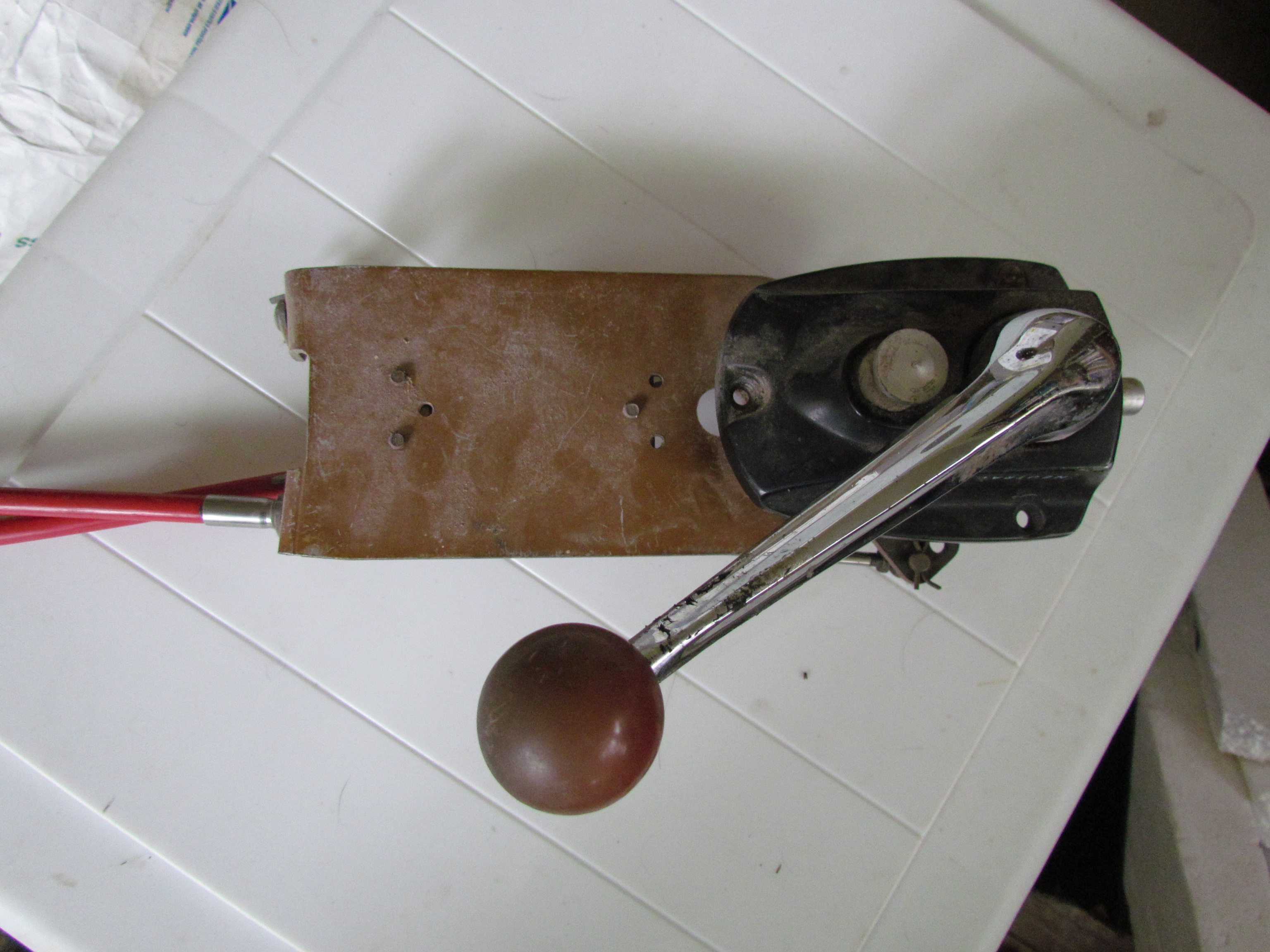

                    So I found this Morse item in my rathole. It seems to work smoothly and maybe be more solidly built that the typical outboard control box. More like traditional inboard controls. But what exactly do I have? Is it a side mount missing the housing, or? And what do the two buttons do?
                    #75086
                      panel mount one button is for fast idle.
                      #75088
                        What you have there is a typical Morse control, this one for concealed side mount. When installed in the boat only the black housing and handle are visible. It is fairly universal by changing the position of the two inside levers.
                        With it in neutral position, pull out the big button. That disengages the shift so you can give it some throttle for starting. Push the button back in and shift function is restored.
                        The other button? Either I don’t know or I’ve forgotten.
                        I’m trying to remember who came first with single lever controls. Merc or Morse?? But it was close.
