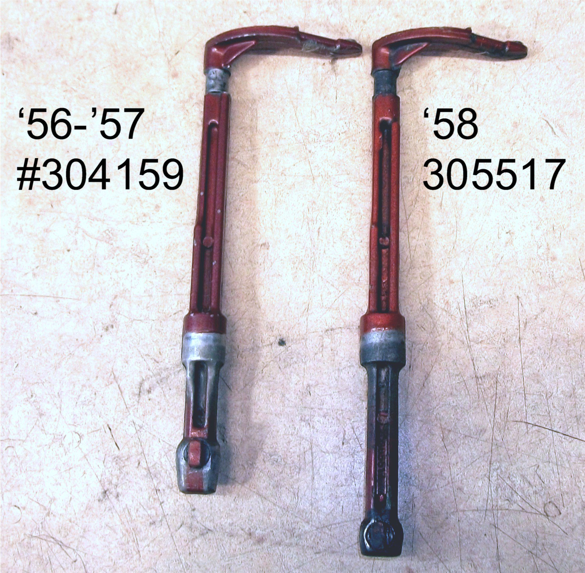

      i am in need of a control lever for a 1957 10 hp evinrude does anybody have a parts manual for the 1957 10 hp evinrude
      ? marineengine .com does not show one
      or can you tell me the part number for the control lever that controls the magneto

        ALBERT MOORE
          the control lever is the vertical rod mounted on side of block the turns the magneto plate
          al

            An old post on here has the 1956 Parts Manual.  Very Similar
            https://www.aomci.org/wp-content/uploads/attachments/1956%20Evinrude%2010%20HP%20Parts%20Manual.pdf
            Interestingly the 1956 Part number is 304159  and the 1958 part number is 305517.  So perhaps the 1957 is yet another number?

              1956 and 57 used the 15-18 hp midsection and was charged in 1958. Might make a difference in length of the part???

              Steve D
                These are from Johnsons but are the same for Evinrude. ’56 and ’57 are the same #304159, and as mentioned, ’58 is different, 305517.
                control-levers-1

                ALBERT MOORE
                  thanks to everyone for your help  and thanks to Steve D,  Seakaye 12 for for the photos and the manual
