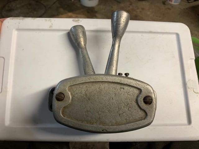

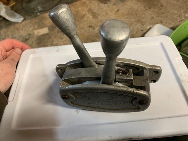

      Anyone know the make of these controls? Are they late 40’s? Early 50’s?
      IMG_0387
      IMG_0386
      #171702

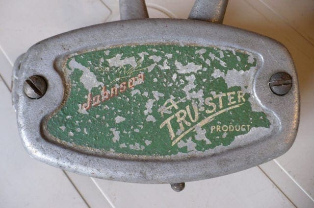

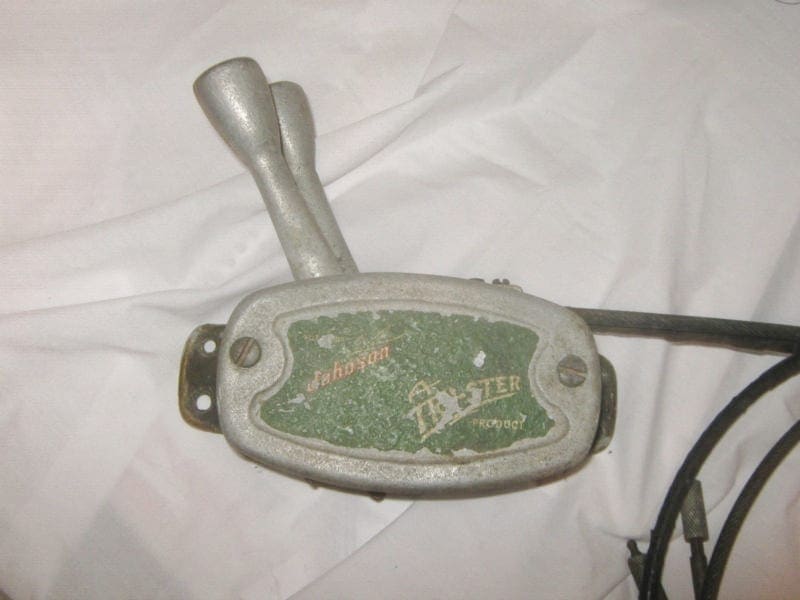

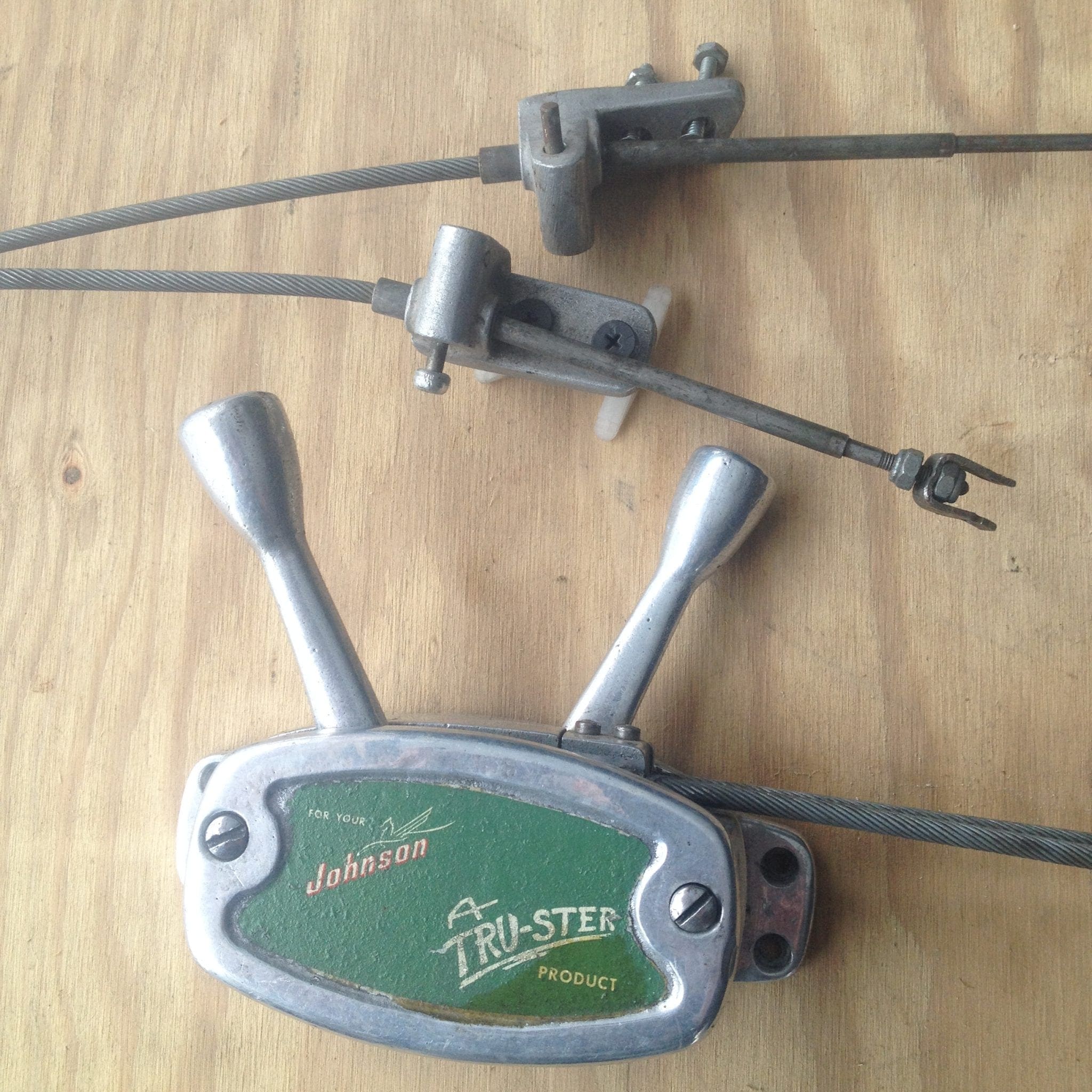

        They look like old Tru-Ster controls. They were probably an aftermarket company and would label their product with whatever type motor you were running.
        Here’s a set someone posted earlier and they are marked ‘Johnson’. To be used with a Johnson outboard, they would have to be ’49 or later with the shift lever.
        Johnson-Controls
        Tru-ster-Controls

            If you look back to the July 2014 Outboarder, I wrote an article about these controls and the other ones available at the time. I suspect that the OMC universal remotes were inspired by these.

                      I will look around and see if i can find the color photo of the decal. The controls are at the cottage and I won’t be able to get there for a few weeks yet due to heavy snow this year. I have a set here that is branded for Evinrude, however the decal is weathered. I have seen Scott Atwater ones as well, but don’t have a set of those. The castings are the same, with the only difference being in the decals.
                      The only thing that I am missing to have complete setups for both the Tru-Ster and Duotrol setups is a pair of the rods for the rear mounted Duotrol steering bracket. I would love to find a set of those rods. I have been toying with the idea of making a mandrel and some jigs and trying to bend some up from spring steel, but have not made it past the drawing board on that project.
