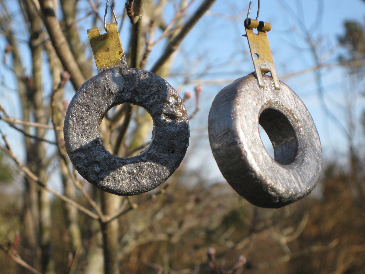

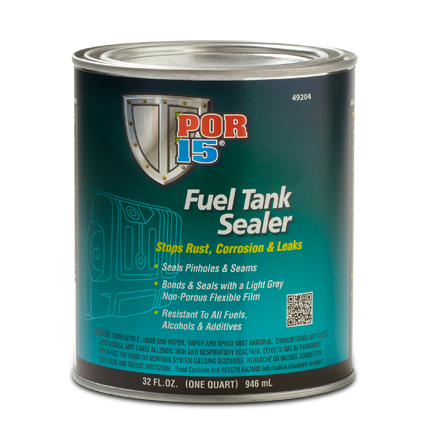

                  I just sealed a couple of cork floats with POR-15 Fuel Tank Sealer. Got a pint for under $20 including shipping at Amazon. I’ve been reading around about it’s use for sealing cork floats and though I’d give it a try. Seems to go on very thin and has a water like consistency. A RD-19 cork float will fit into the can.
                  http://www.por15.com/POR-15-Fuel-Tank-Sealer_p_64.html

                    All the other advise for older cork floats that may not be able to replace is good. Just be aware not to over coat it and make it heavier, were it will not float correctly and not shut off the inlet needle.
