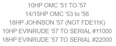

          I found this list on another site so it should help to narrow your search down. Chris has the kits here:
          http://www.myoldboatmotor.com/gearcase-seal-kits.html
          Some Sierra kits used to come with four seals instead of two but I’ve lost the P/N over time. This way one kit worked for several models.
          Seals
          #225840
