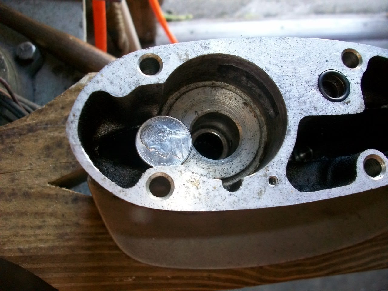

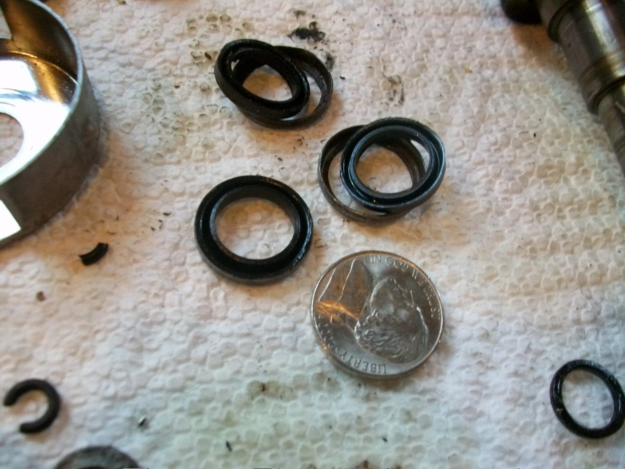

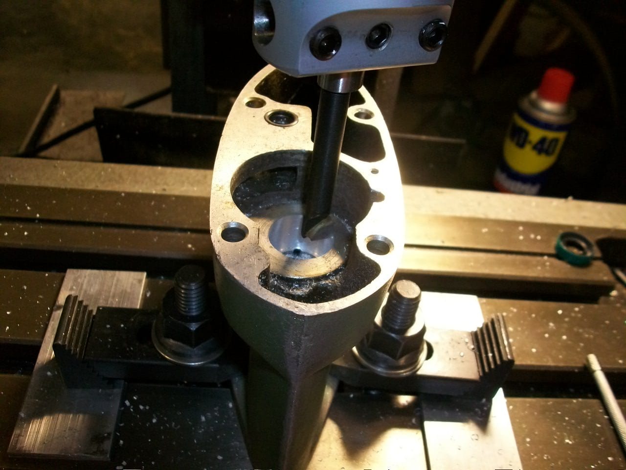

            It does have a complex lower unit with a lot of potential leak places. Worst is the skinny drive shaft seal, and there is no room to put a better one in. But I fixed that on mine by boring out the housing to accept a better seal. Of course you need a milling machine to do that.
            100_1385
            100_1386
            100_1399

              And, frankr – Thanks for the photos – I’m going to need to do that with the bushings in a Wizard I have – Jigging it up in the mill is the hardest part, I think.

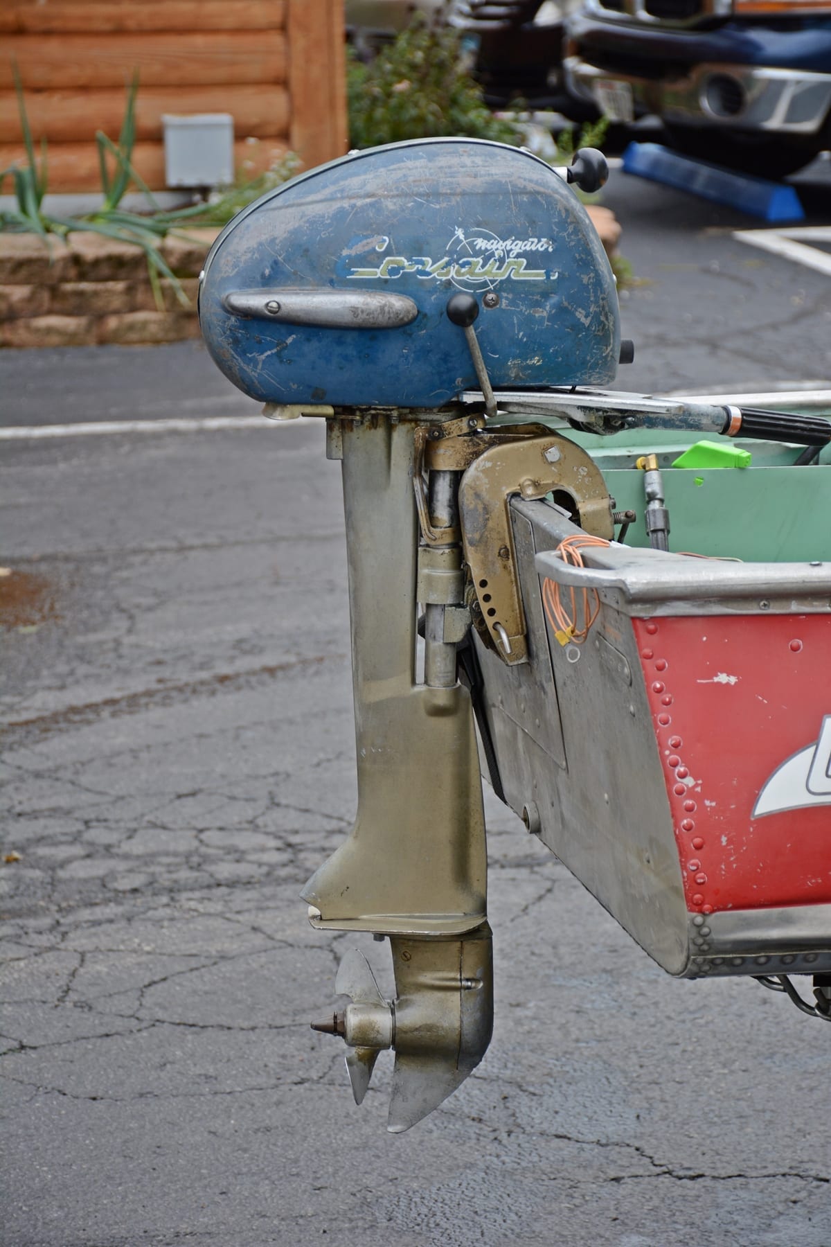

                A photo of our 5hp is her working clothes. I have not done a cosmetic restoration on her yet, but I do plan to. It is on my list. This was a free motor at Tomahawk last day. I couldn’t bear to see it go to scrap, so Kevin and I grabbed it. It is a nice trolling motor.
                Steve
