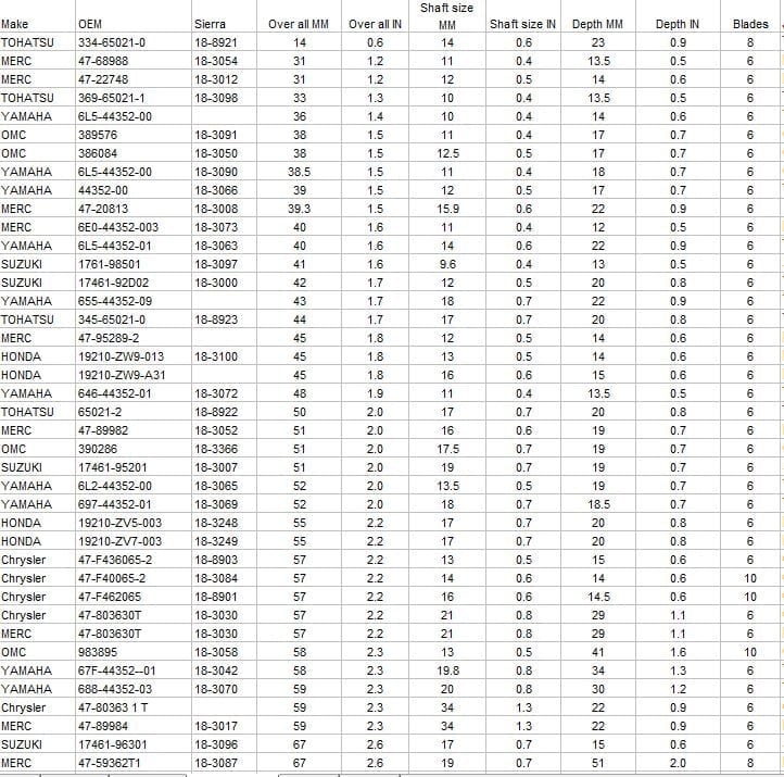

        Have you tried to match your impeller to an OMC or Sierra that may fit, or
        be altered to work?
        Some charts with sizes……..
        Firestone-Impeller
        Impeller-chart-all-makes
        Impeller-chart
        Impeller-Sizes-metric1

          This is the Honda impeller that will work if you shim the bore:
          Honda 19210-ZW9-013 19210-ZW9-003
          Best way to do it is to enlarge the bore a bit with a dowel and some sandpaper, the superglue in a small length of this tubing:
          K&S #140 17/32 round brass tubing
          Then file a groove for the drive pin.
