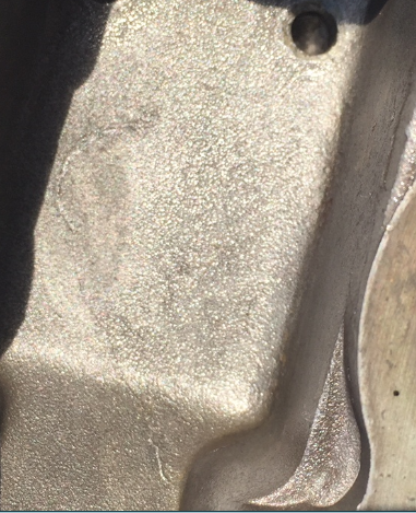

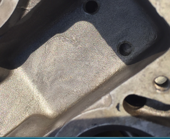

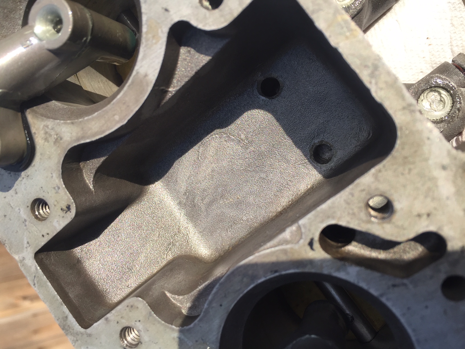

      Do the pics show a casting flaw, or a crack, in the bowl of my model E, type 2 carb?
      Not great photography or light, I know.
      It was more apparent before I took a swipe at it with a shop towel; which makes me think it’s more likely a crack than casting flaw.
      I can’t seem to get it to run right. If the carb is cracked, then that might explain this.
      If anyone can tell me how to differentiate a crack from a casting anomaly I’ll be grateful. I’ll pour some gas in and see if it leaks down, but it hadn’t emptied in the week it’s been sitting.
      All opinions welcome.
      Many thanks!
      Alan
      Edit; if I polish on it, and it goes away, it was a casting issue. Right? It didn’t leak when I filled the bowl w/ gas, but it wasn’t bolted down or hot, either. All suggestions definitely welcome. Odds are it’s a casting issue, I know, but i’m not gonna bolt it back up ’til I get it figured.

        looks to me like a casting mark.

          It’s normal. That is where hot molten metal has contacted already cooling molten metal during the casting process.
          Wayne

            I would agree that it is not a crack. If you’re concerned, it could polish it out by pulling a strip of 400 grit wet or dry paper across it while holding it against the casting with your finger. It doesn’t take much water. I use that system to clean up breaker points using WD40 . . . 🙂

              It is a casting defect.
              I look at lots of them at work.
              Cracks always start at an edge.

                And, I see now that a crack in that place wouldn’t necessarily even affect performance. Just leak onto the manifold.
