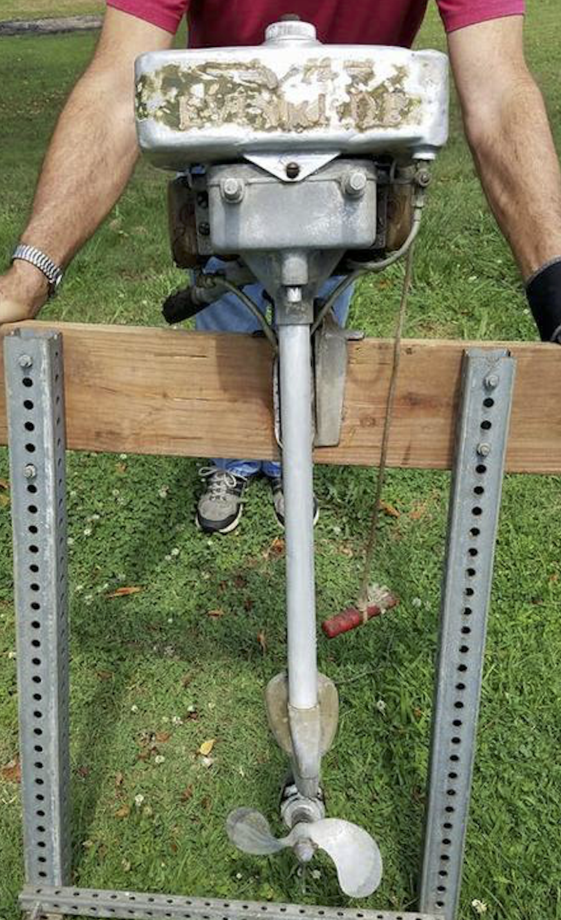

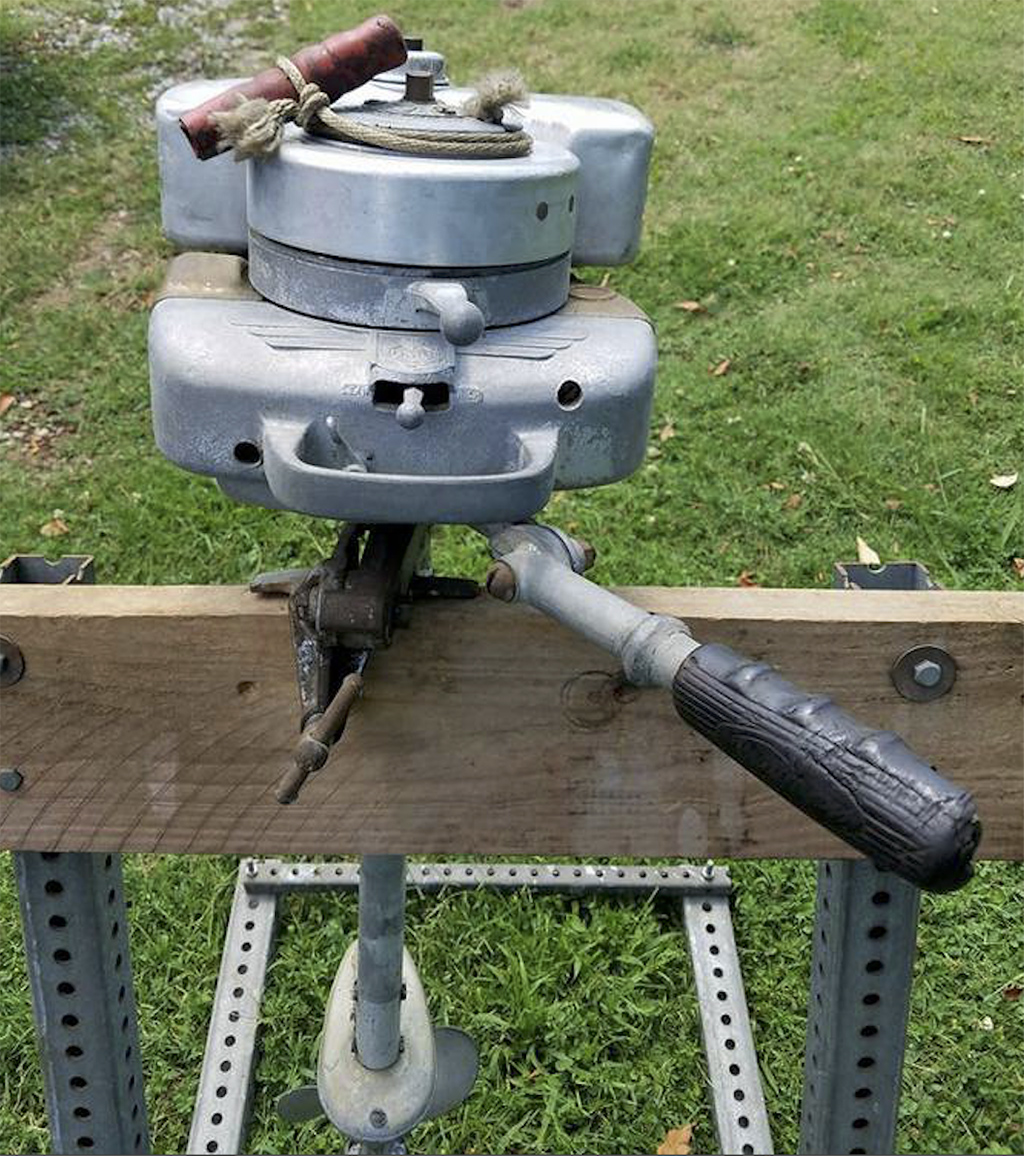

What year and is it worth it?

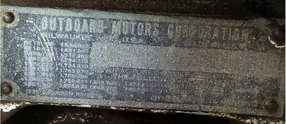

April 1, 2017 at 1:43 pm #55297looks like 1936 Sportwin, 2.5 HP, can’t really see the model number but betting its a 4156.
$175 isn’t completely outrageous for asking price, but it should really sell for quite a bit less than that amount, in my tiny mind anyway. To me, its a $75-$100 motor.

April 1, 2017 at 1:56 pm #55299Cant read the serial number but looks to be a
1936 Evinrude Sportwin. Value has much to do

April 1, 2017 at 2:06 pm #55303Really neat front cover with the OMC cast in.
I’d like to have one like that, but as the others
say, for "less". Make an offer, or wait a while
and maybe he’ll drop the price?Prepare to be boarded!

April 1, 2017 at 4:06 pm #55313I can make out 4156 on the tag – they’re great little motors – poppet valve carbs, very simple, typical ignition for the period (read: expect to replace), an exhaust note you’re only gonna find with an opposed twin. On the downside, their waterpumps are a pain in the ass – checkballs that tend to stick and are difficult to access.
On that motor, I’d want to make sure the skeg is still there (they rank up there on the fragility scale with Bendix). And I’d want to be darn sure that crud on the left cylinder – at the back, toward the bottom – isn’t a burst water jacket.
As for the price – ask him to start it for you. If it starts, pay him and be happy that it has good coils. If it doesn’t, try to get him down on price.
added: I just blew up the pics, and that sure looks like a burst water jacket – not an insolvable problem, but it makes a motor that should bring $100 at best worth more like $40 as a parts motor/major project

April 2, 2017 at 12:53 am #55341The picture of the Model number leaves a LOT to be desired – . . . 🙄
But the powerhead is of a 1936 Sportwin, and also proves from the there is no such thing as an OMC brand of outboard. They were ALL OMC built and were Evinrude. or Elto depending on model and decal.

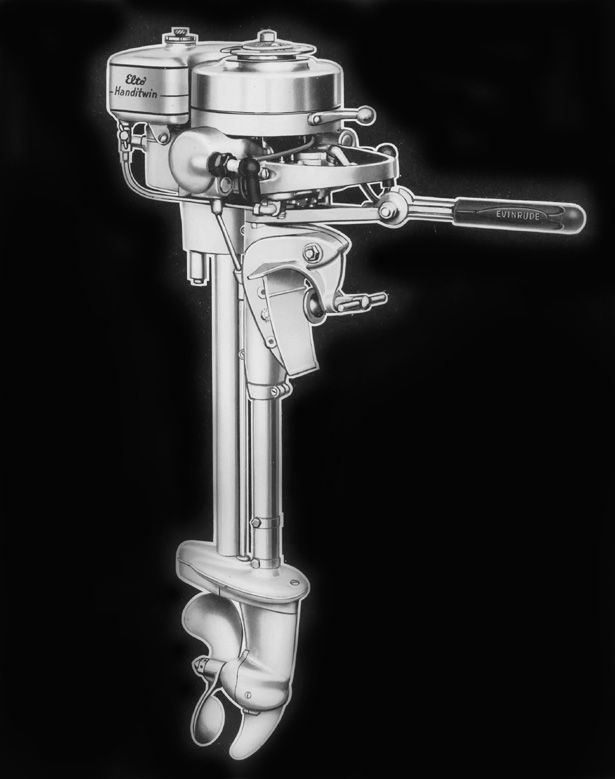

From what I see of the Lower Unit, it may be from a 1939 Handitwin. . . 😕
