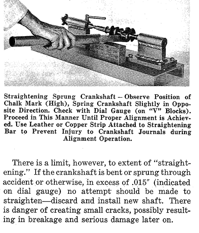

I agree with Bill, plain bearing/bushings are less effected than roller/needle surfaces. I would be hesitant to trust just any machinist to do crank repairs, look for a replacement crank if needed.September 13, 2017 at 8:57 pm #64840September 13, 2017 at 10:00 pm #64845That looks like a pretty heavy duty holding device.
If that base is a slab of solid metal it might not be very portable
Thanks for the photo and instructions.
