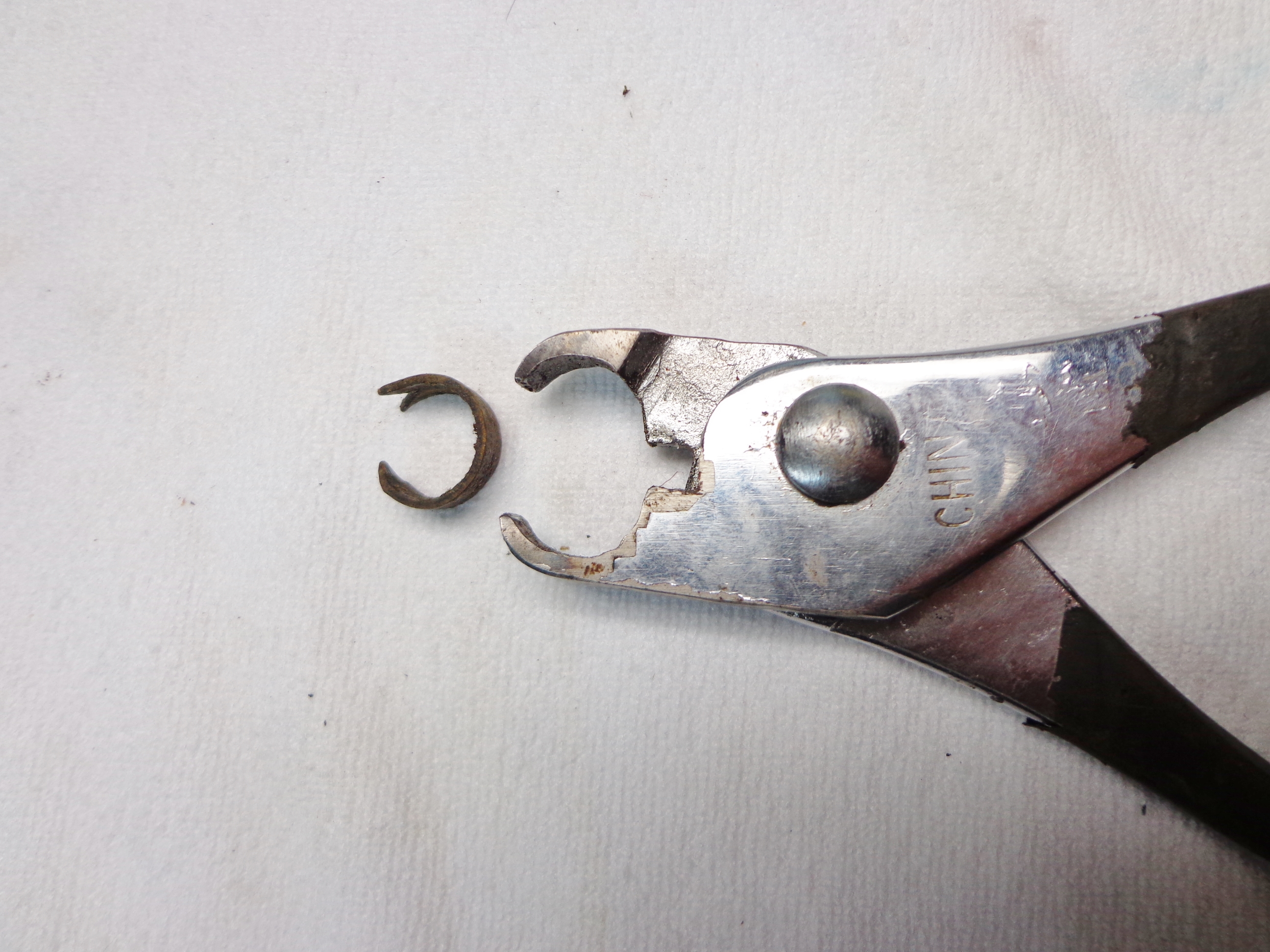

      I have 4 new original style hose clamps and would like to get a nice even crimp all the way around the hose. I assume there was a special pair of pliers back in the day.
      Any good techniques for accomplishing this?

        Most dealers mearly appropriated a pare of plyers out of the Evinrude tool kit and remodeled it with a grinder and a rat tail file. . . 😎

          viewtopic.php?f=2&t=14239&p=74433&hilit=pliers#p74433
          (Mumbles picture):

              2 good ways of crimping those clamps. I had thought about modifying a pair of slip joint pliers. Somewhere in my storage unit i have cable parts and a crimper tool.It would take a month to dig through that stuff to find it.I will make one like the one shown out of the pliers like mumbles did.
