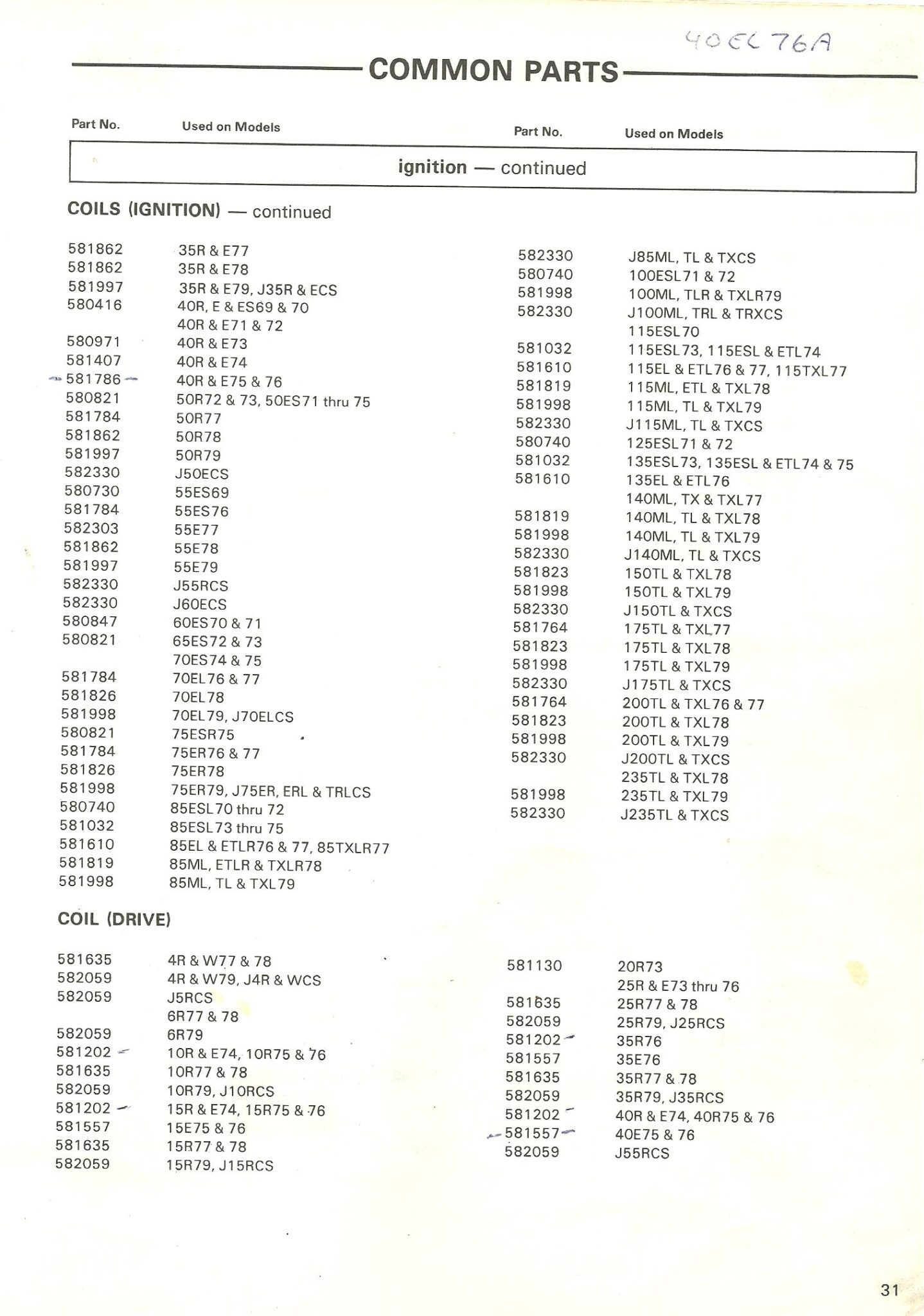

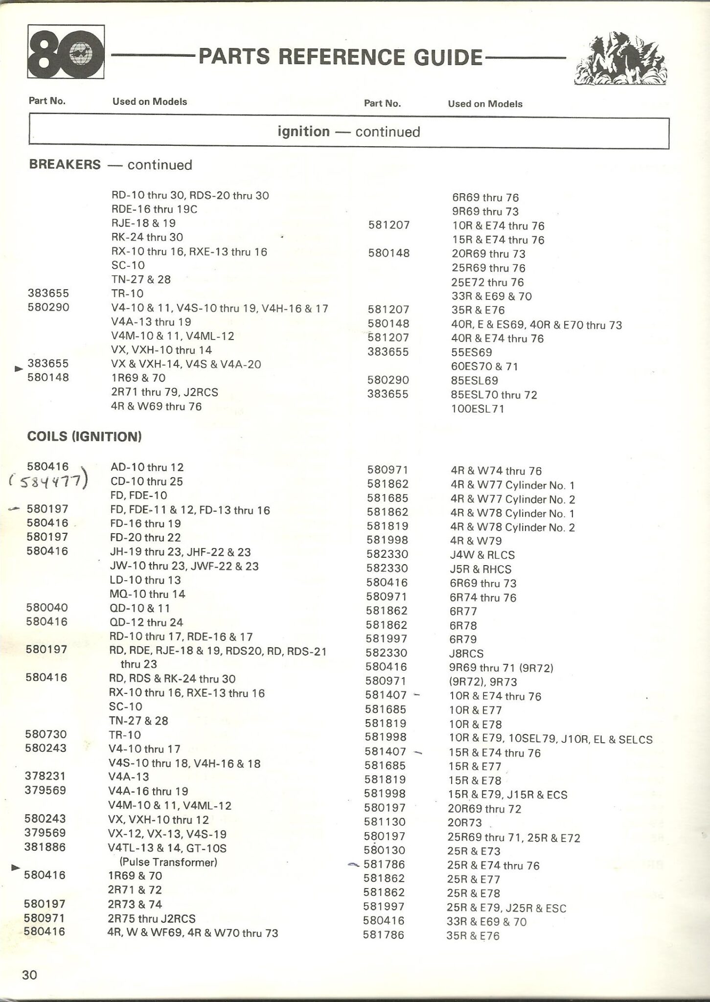

              Here ya go, straight from the 1980 Johnson Parts Reference Guide.
              I don’t know what the physical difference in the coils is but knowing OMC, if even the color of the wires insulation was different, they’d assign a new part number to it.
              1980-SM-Coils-001
              1980-SM-Coils_-001

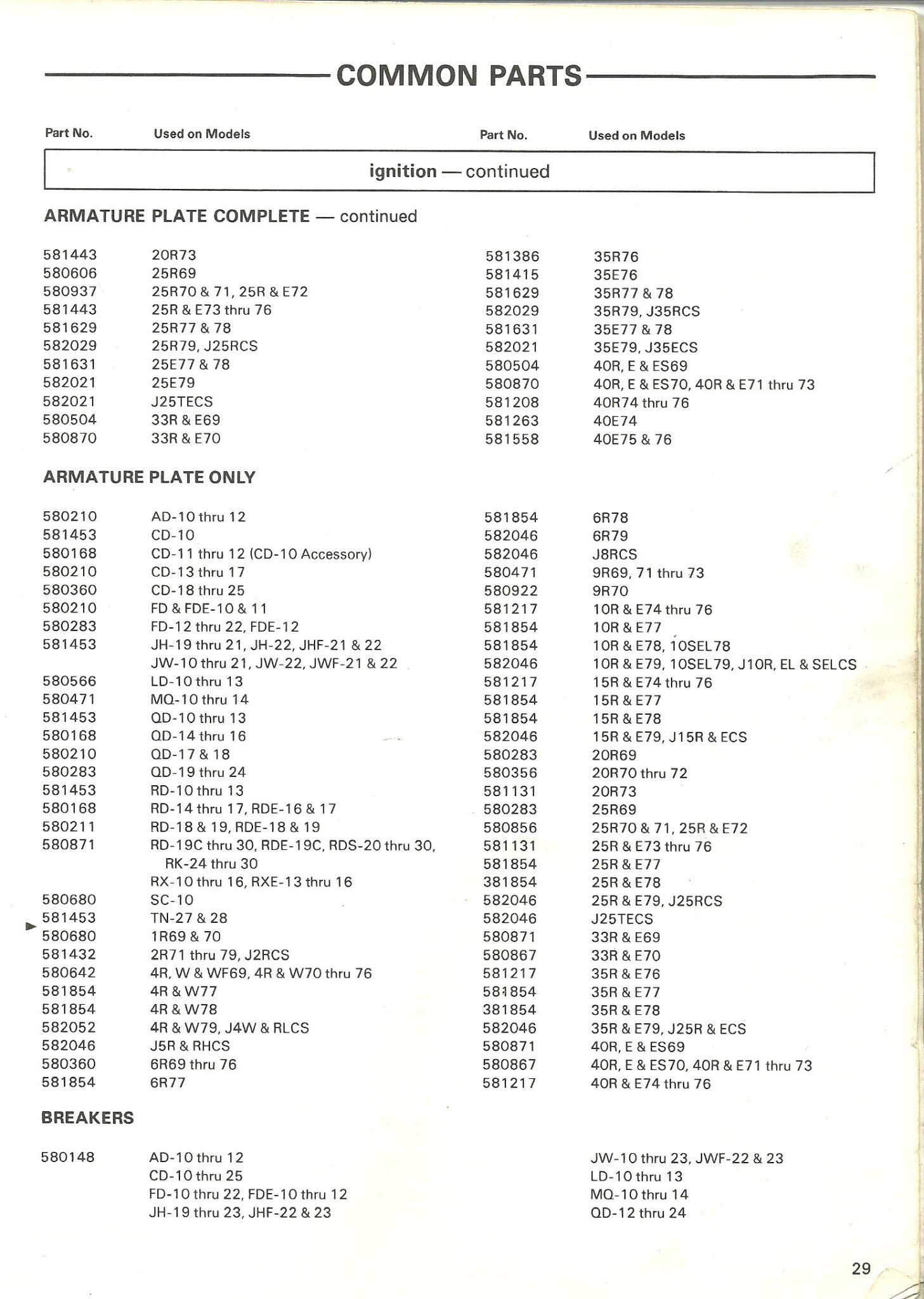

              #284000

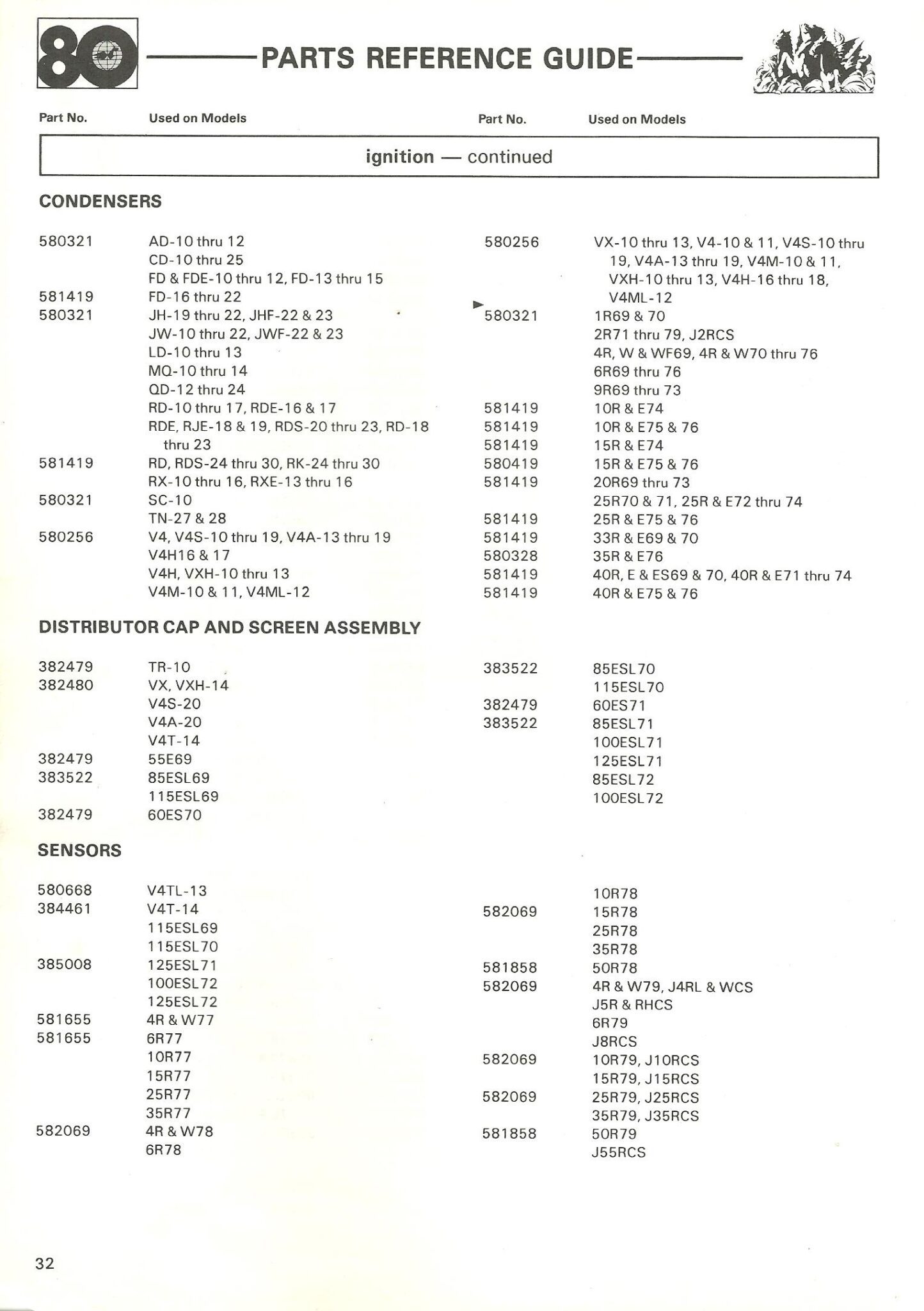

                Some more.
                1980-SM-Caps-001-1
                1980-SM-001-1
                #284003
                  And another one to complete the set.
                  1980-SM-Points-001
