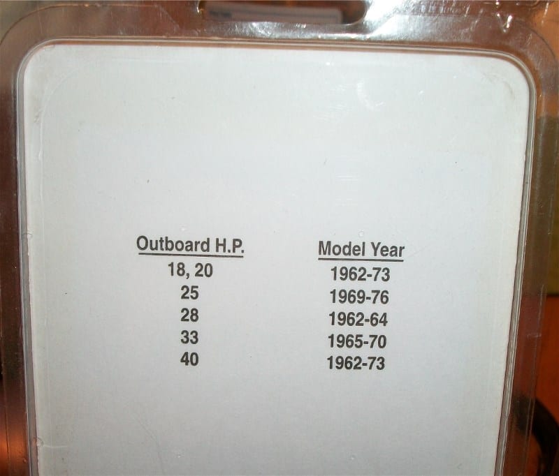

                I took some condensers out of a ’69 25 hp Evinrude. They are 581419 and measure about .565 mfd. I’ve not seen these before and that seems like a high value for an ignition condenser. Anybody know what these are supposed to go in and what the capacitance is supposed to be?
                    Thanks.
                    I don’t know about the capacitance but those are the right ones for that motor. 581419 is part of Tune Up Kit 172523. This is the application chart on the back of the kit, not sure if the condenser is used on any other motors not listed.
                    172523-581419

                      Thanks. My Fluke meter can report capacitance, but I don’t think it’s a test under the higher voltage of operating conditions. And the reading of .565 mfd seems suspicious to me. So many condenser numbers and so few specs! Always more to learn….

                        If you can’t do a true leakage test on a condenser, then just assume it needs to be replaced. Anything else is just Christian Science.
