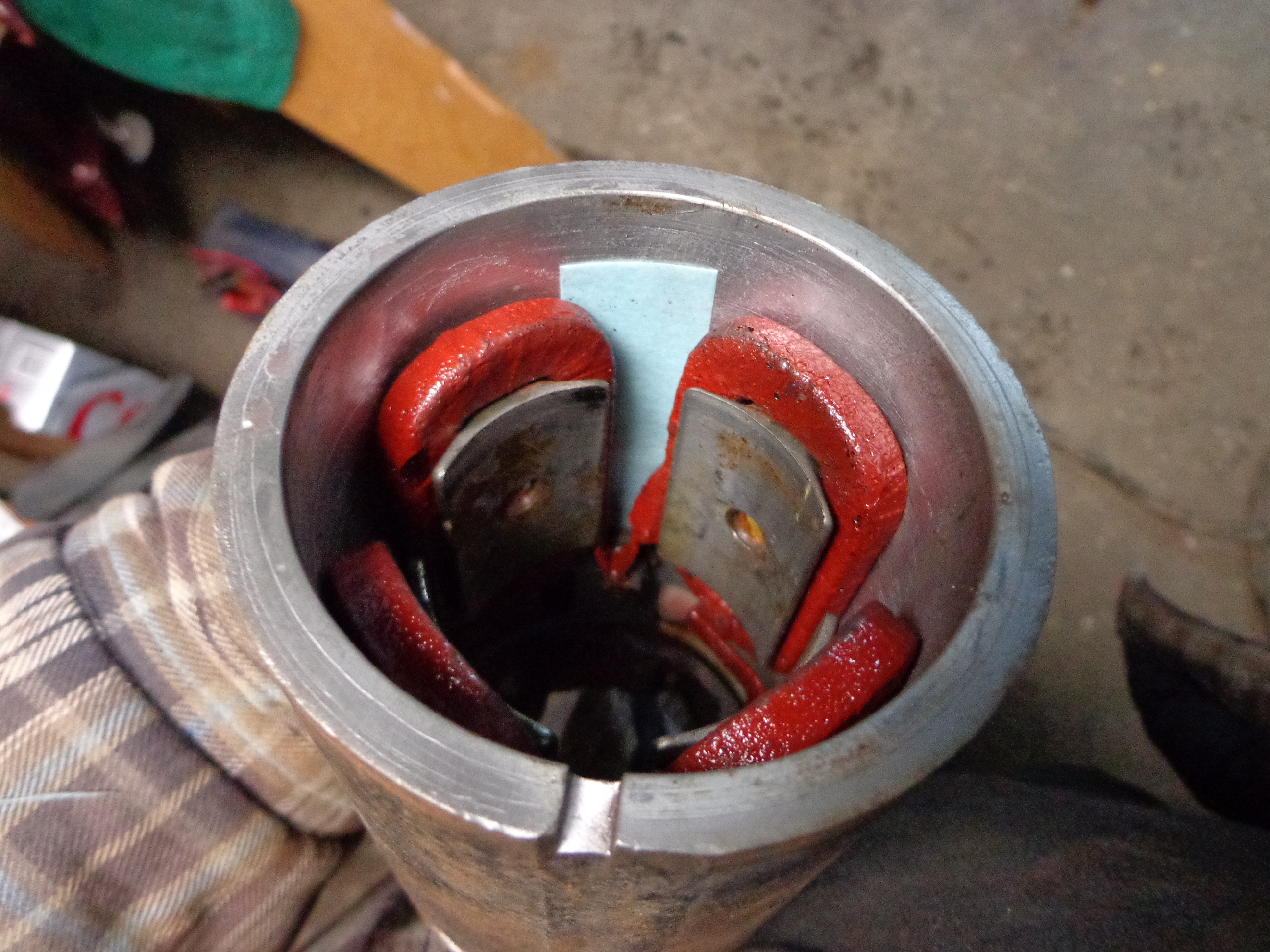

      So I have this dead starter off an elderly Scott 40, and for lack of anything better to do I decided to take it apart to see if anything obvious pops up. I don’t know all that much about starters, but I coulda sworn they have magnets lining the housing ? This one has what looks like magnets, but no magnetic force to be found. Just to check, I dismantled another derelict starter, and it does indeed have some hefty magnets inside.
      So what gives ? Could these things just de-magnetize themselves ? Under what circumstances ?

        That’s different. Usually a starter has windings around the field poles and they get magnetised when the switch is thrown.
        What make and model is your starter?

          It’s a Delco-Remy 1113571. The one I used for comparison is #386430 off a 9.9-15 E/J. Got me.

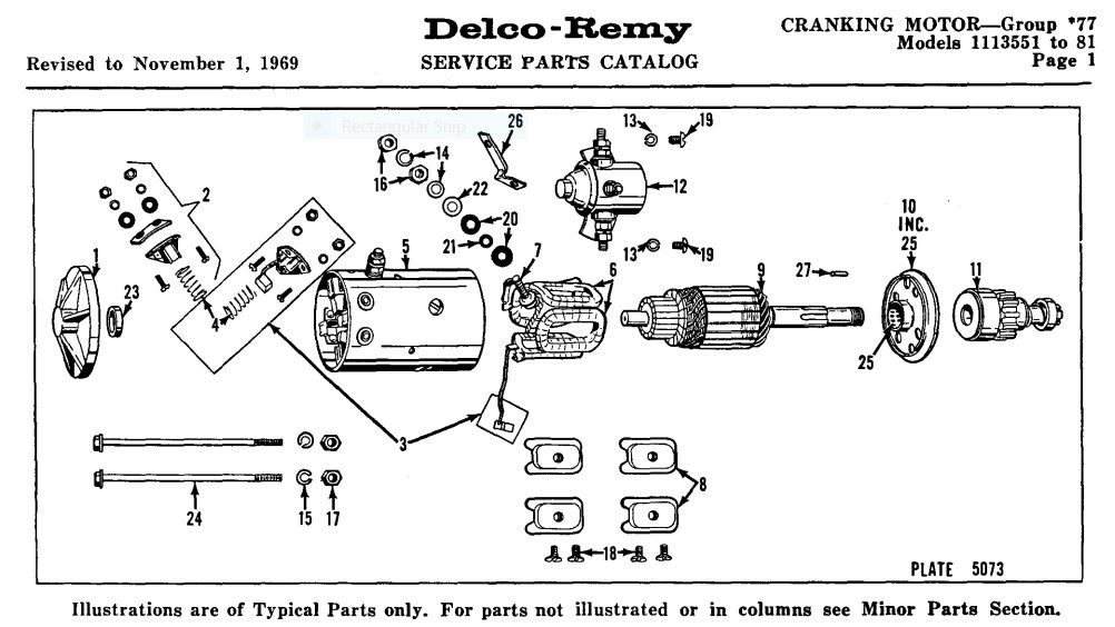

            Well, I found this diagram of your starter and it shows the field coils.
            You might have some residual magnetism in the one.
            Just thinking, that 9.9 starter should be a two brush starter and it will have permanent magnets fastened to the housing. It’s very similar to a lawn mower starter in operation.

                Short story: Up until around the 1970’s all starters had field coils. You can see the wire wound around them. When you hit the starter switch, a fairly heavy current flows through those coils, which makes them magnetic (an electro-magnet). Around 1970-ish, they started using permanent field magnets. Easy to recognize by looking–no wire windings. Much more efficient because there is no electricity wasted energizing the fields. And they can be made smaller too. One caution: Those permanent magnets can shatter. Dropping the starter onto the floor is one way of dong it.
