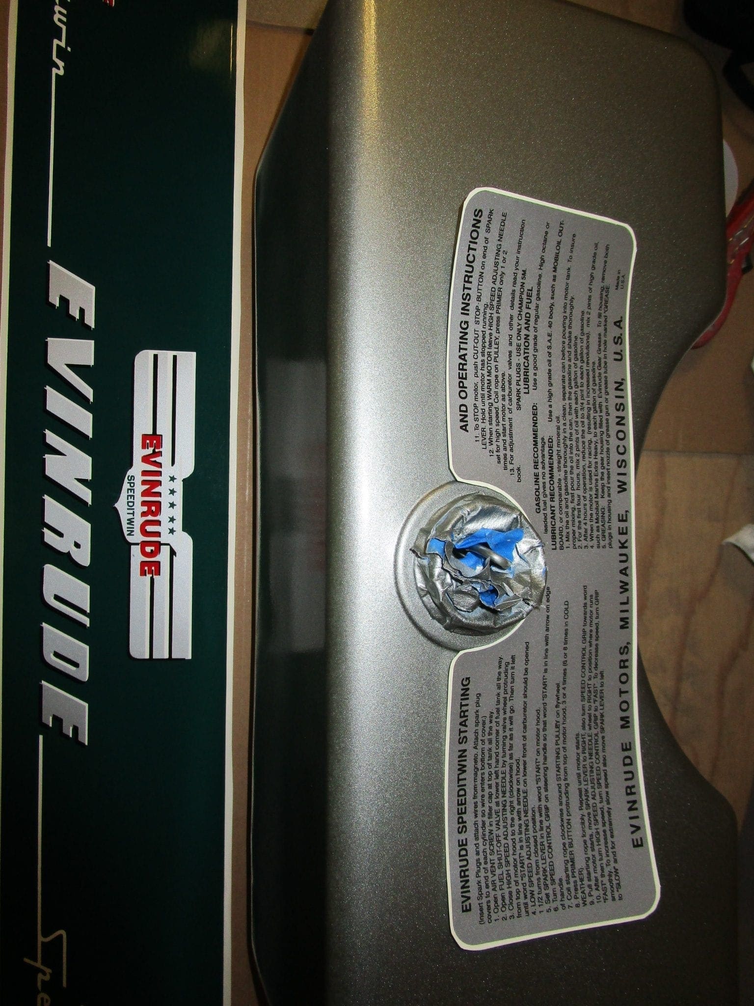

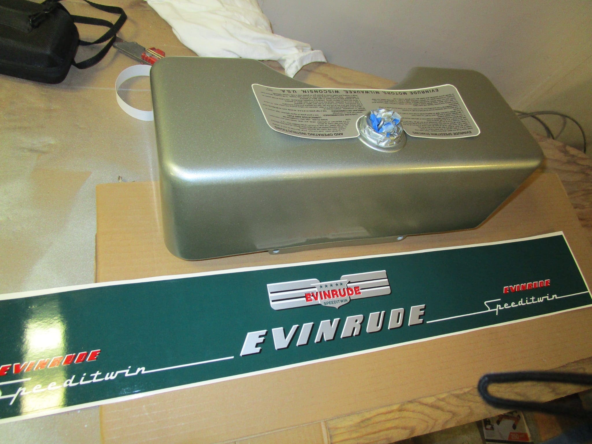

      Getting ready to apply the decals to my tank .. Never applied any before . So are there any tricks of the trade that you guys that have done this can fill me in on before I make the attempt ?
      I have put 4 light coats of clear on the tank and the decals today . Says I need t give it 24 hours cure time first ..

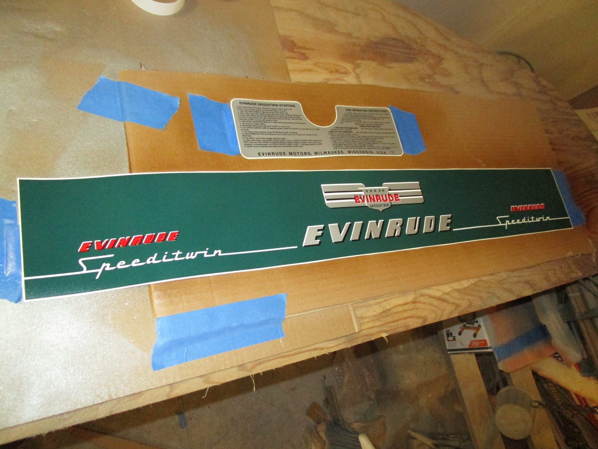

              This is a waterslide decal from American Outboard..
              The potential problem I see, because it’s such a large/long decal , would be getting it centered up on the tank .
              If you have to start on one end , position , then carefully slide the paper out from under the decal , I could see where
              Not getting it centered could be a problem .
              My thought is maybe dry fit it in to position .
              Then place a piece of blue tape at the ends and top/bottom .
              That gives me a starting point that I won’t need to eyeball or think about during actual installation .
              Hopefully the decal doesn’t stretch much when wet . It does wrap around all 4 corners of the tank ..

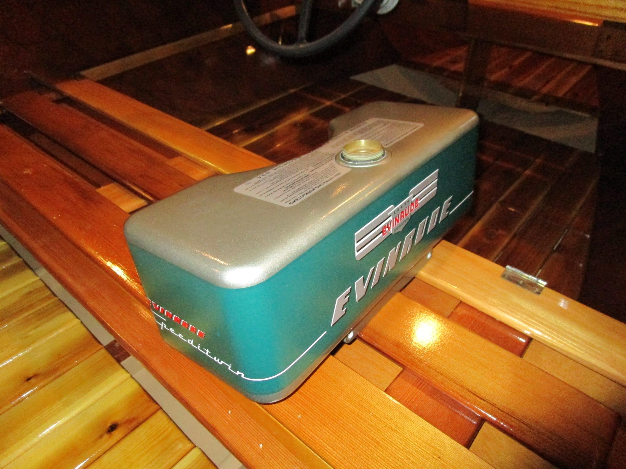

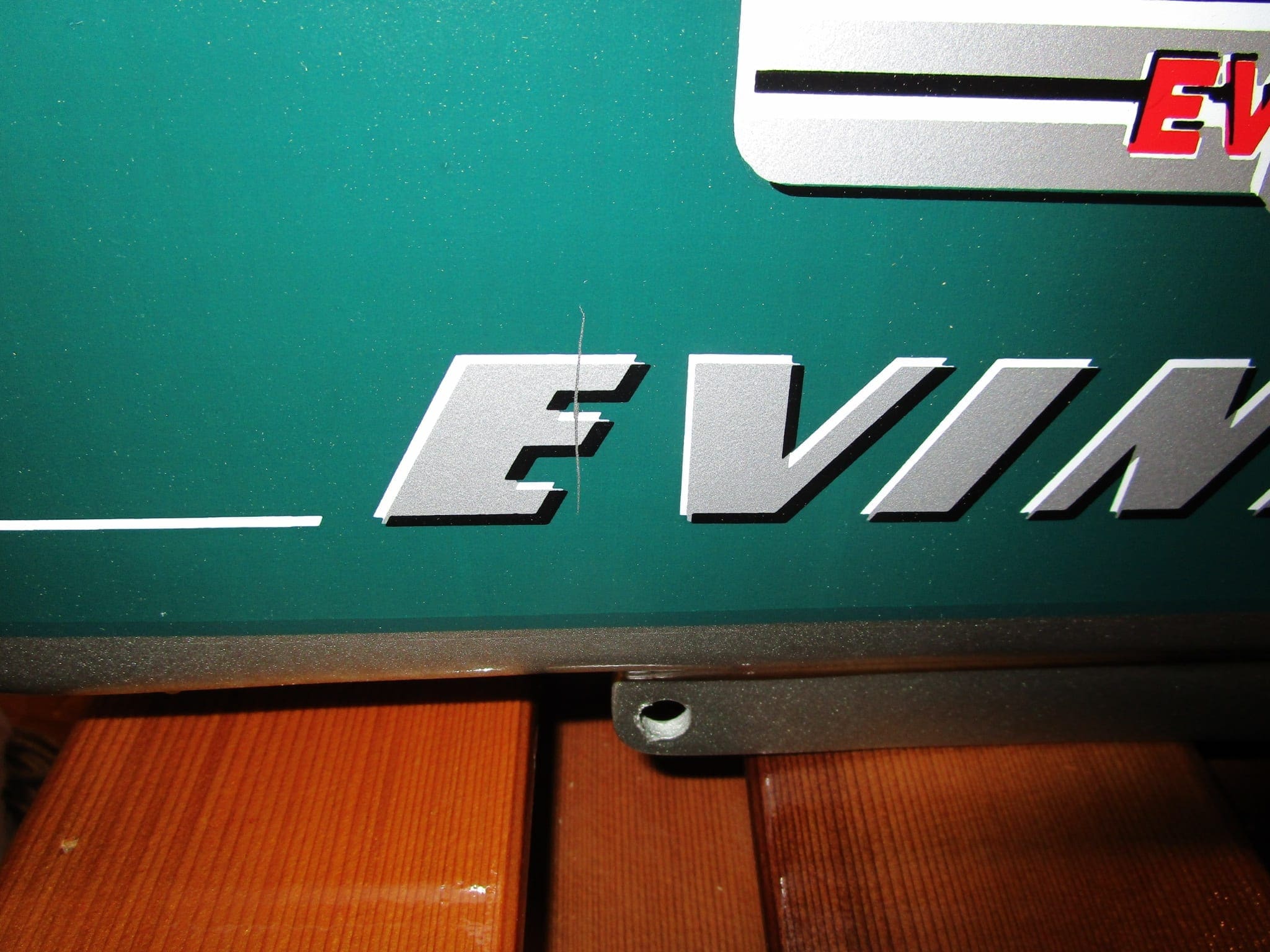

                  #181288
                  Samuel Phelps
                    Got it on there . Was going good until a slight adjustment caused a small tear .. Uhgggggggg ! LOL!! Rookie mistake …
                    Was thinking on using a small artist brush and try to touch up a bit before the clear coat …
                    09D9BE73-EDF4-4073-A278-709990275F78
                    F9C7AF47-4776-4D87-A89B-12EE1D86D67E
                    #181292
                      Hay pal, you done good. Decals that size
                      are a challenge for anybody. There is
                      some skill involve in putting these things
                      on and that comes with experience.
                      #181297
                        Tear is hardly noticeable – you did a great job on both the tank repair/paint and the decals. Looks factory new – very well done!!
