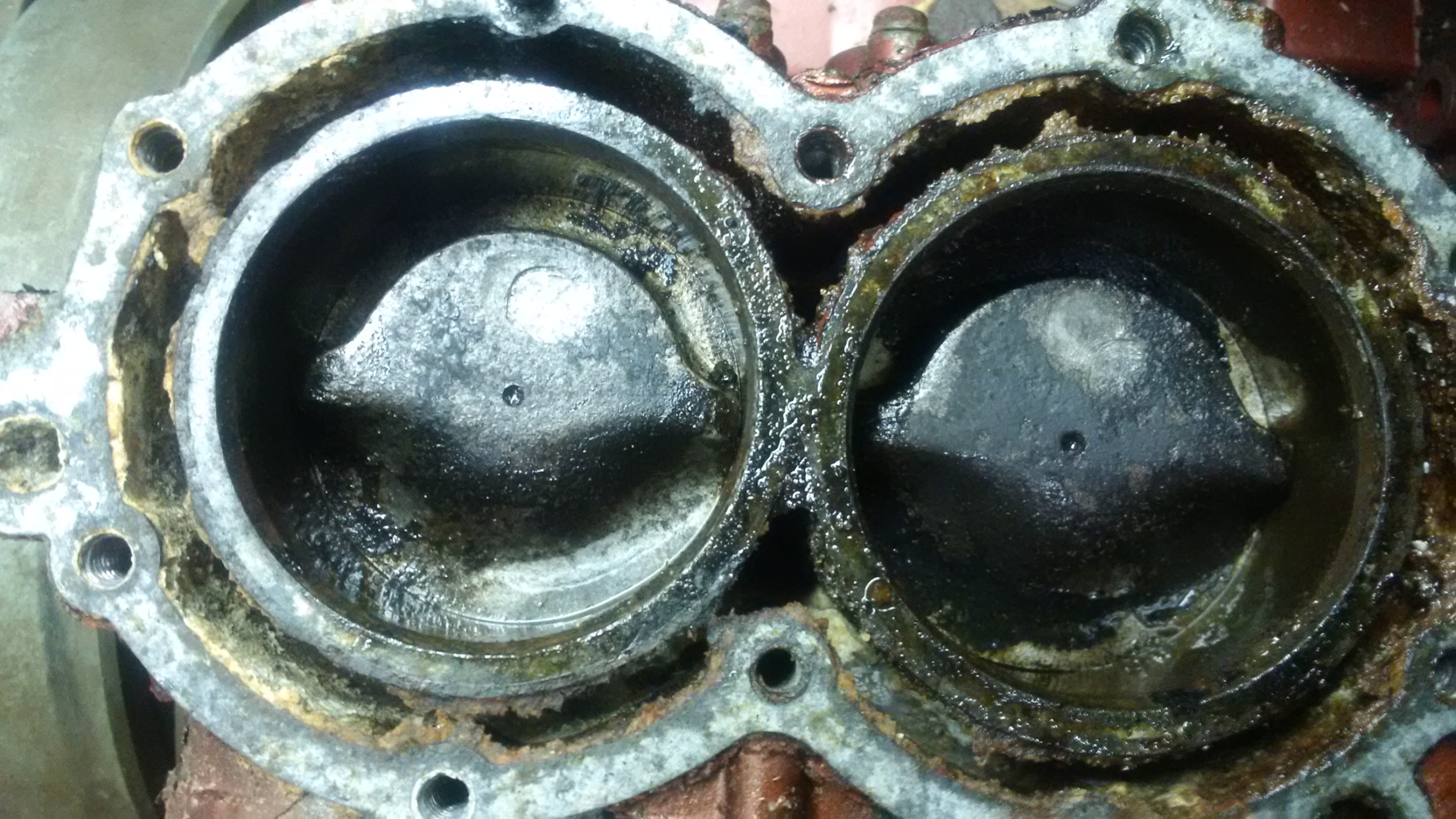

Picked up a seized QD 18 today. I looked through the plug holes and noticed both pistons were dented by a p/o trying to free it up by pounding on them with a blunt instrument. Well, I pulled the head (only broke one bolt) and managed to free it up by liberal use of some seafoam deep creep and a 2×2 piece of wood for a drift. My question is: does the damage to the piston necessitate replacing them ? They are not broken through, but are dented about a 16th of an inch. will the dents create hot /cold spots ?

I would just smooth the sharp edges so as not to have a hot spot.
January 30, 2016 at 12:45 am #31030Use ’em. But how is the rest of the powerhed–rings, bearings, etc?
January 30, 2016 at 12:48 am #31032Me too. The fate of the world doesn’t usually depend on our motors. Not usually a life and death situation. The pistons will probably be fine for a few runs, now and then, by a hobbiest. However, my experience with stuck QDs and FDs has often shown that you’ll also have rust damage on the crank. Have you seen it yet? To me, that would be more worrisome than the pistons….
January 30, 2016 at 1:03 am #31036Hmmmm.
How about the wrist pins, are they sloppy? I am guessing this is why the pistons are dented.
Oh, OK, just reread the post.
The previous owner dented the pistons with a punch trying to free them up, correct?
If so, I wouldn’t worry about it, maybe just try to smooth the ridges down with some emery.
But, you still want to check for sloppy wrist pins.January 30, 2016 at 2:01 am #31037I haven’t opened it up yet, but there was a small amount of rust apparent in the cylinders. There is some slop too, but I’ve seen worse. I will clean up the head and gasket and put it back on to see what kind of compression there is. If it’s no good, that’s ok ’cause there are lots of good usable parts including a really nice cowl and emblem,a good prop that I need for another QD hanging on the rack . I haven’t checked the gearcase yet , but it spins freely and looks good on the outside with no breakage. Got it cheap too 🙂 !

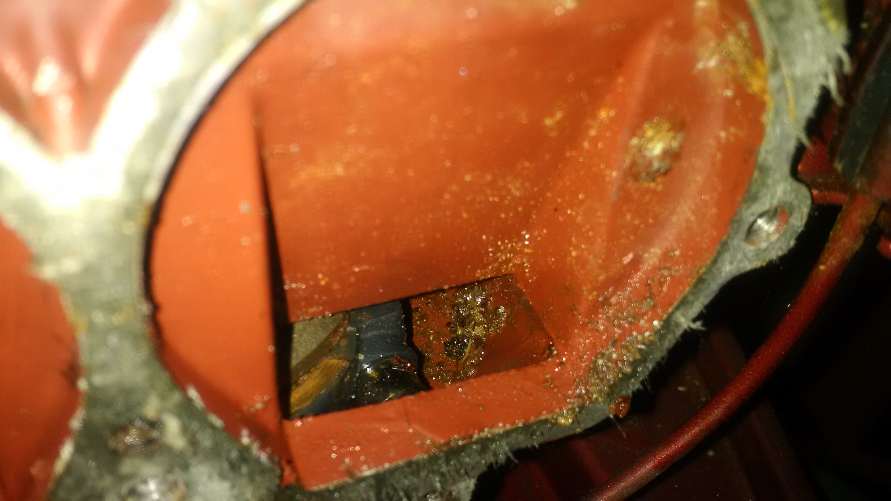

January 30, 2016 at 6:10 am #31050January 30, 2016 at 1:02 pm #31058Ewwww, you can see why the motor was stuck. That one will have to be opened up.
