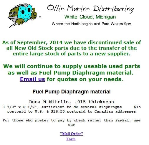

        jcrigan, If the glove trick you tried was with those light green ones, those were nitrile. If the diaphragm rubber you bought off ebay was really neoprene, that could be the reason why they didn’t hold up. It looks like you can still get diaphragm material here:
        http://www.pfs-ware.com/Parts/OllieParts.htm
        ollie

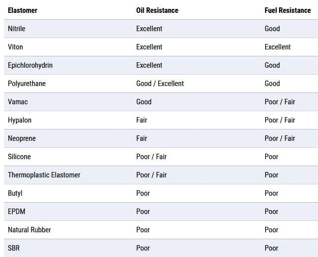

        I found this chart helpful.
        https://www.wcrp.uk.com/technical/material-selection/which-elastomer-offers-the-best-oil-fuel-resistance/
        fuel-resistance

          Thanks. Didn’t think Olies was still there. I though at the time i was buying nitrile rubber but this stuff dissolved right away. Had to clean lines and carb after that.
