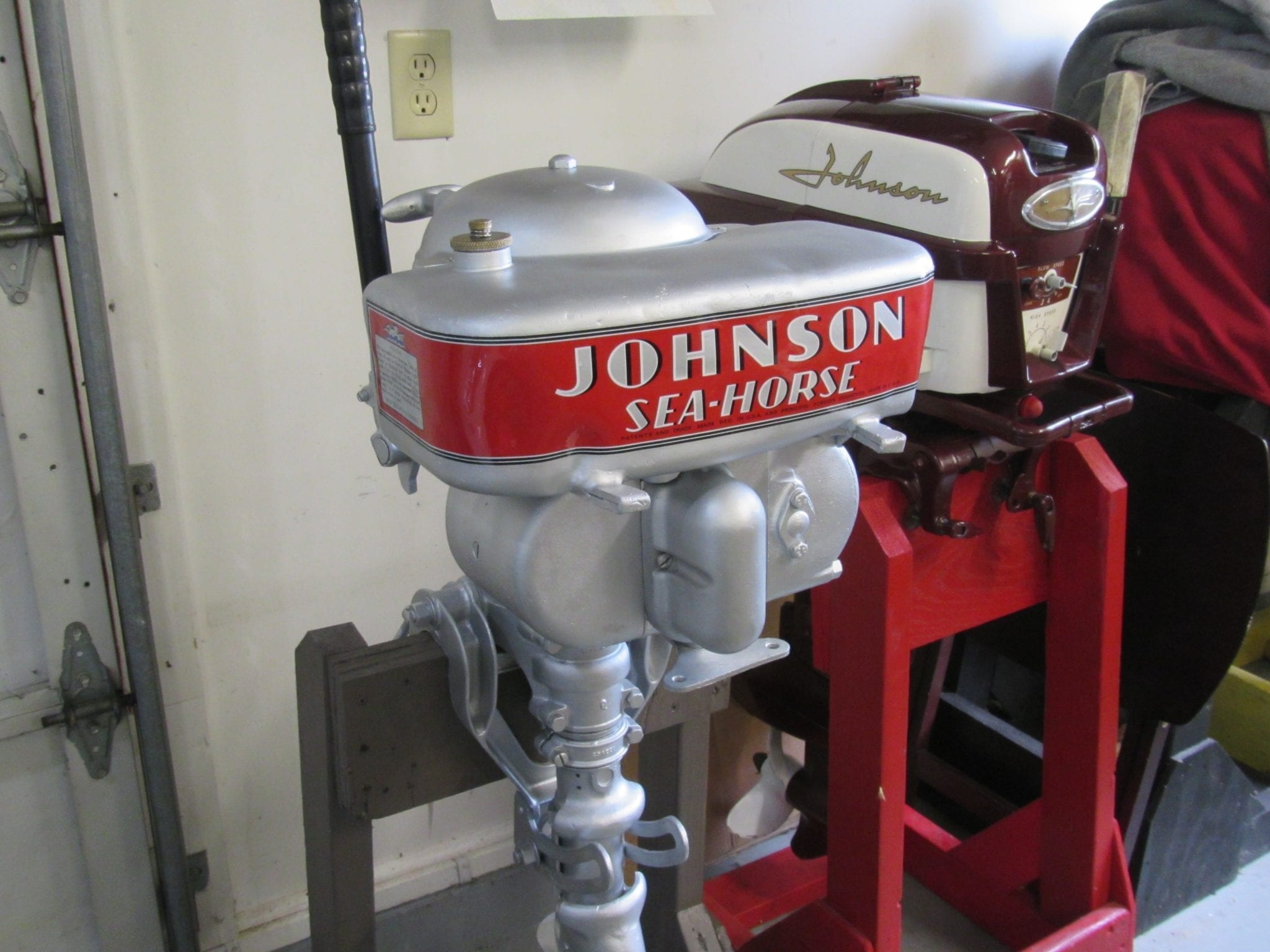

          Dale
            Dixie’s been good to me! She returns my emails, she takes paypal, her decals are great. As far as I am concerned the decals are as good as any I have seen.
            dale

            #197972
            JOSEPH BRINCAT
              Look very nice… these are vinyl correct? not water applied decals.
              Joe B
              #197983
              Dale
                Hi joe, yes those decals are vinyl. I had some bad luck with water slide decals. Once I got the water slide in the spot I wanted and let it stick. Six months later they fell off. Probably operator error I have used water slide only on model cars many many years ago! I will not purchase those again! I know water slide are OE equipment. Any decals are to expensive to waste. IMHO
