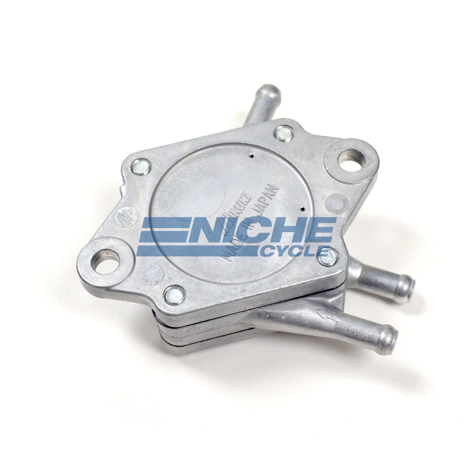

      I am going to be adding a fuel pump to a RD-17 25 hp Johnson.
      I was planning on purchasing this one off of eBay.
      Do you think I can take off the cover so the barbs are pointed in a different direction?..
      P.S. I do not want to use a OMC pump.
      https://www.ebay.com/itm/173584627076
      s-l1600-1
      s-l1900

        not to many opinions !  guess you need to just try it  and….feedback your findings  and pictures .   have you looked at the  rectangular mikuni model  as an option ?
        #266069
        outboardnut
          I was going to use that above pump on a 25 hp 1955 Johnson
          I am concerned that the rectangular Mikuni pump will not pump enough (14 liters per hour)(3.698408733 gallons per hour)
          While the Mikuni DF52-133-D pumps 31 liters per hour(8.1893336231 gallons per hour)
          Thats got be enough
          I really don’t know how gallons per hour a 1955 25 hp RD-17 Johnson uses.
          1 liter = 0.2641720524 gallon (US)
          #266075
            my carb 50hp Merc would burn 5 gal/h WOT      so a 25 likely would burn 2.5 g/H  at WOT  so the rectangular  Mikuni should do  considering you won’t likely be pulling skiers at WOT all day long
            jmho…
            #266206
            outboardnut
              I called Niche cycle and they said Mikuni DF52-133-D can be mounted any way .
              Also the cover must remain in the same position
