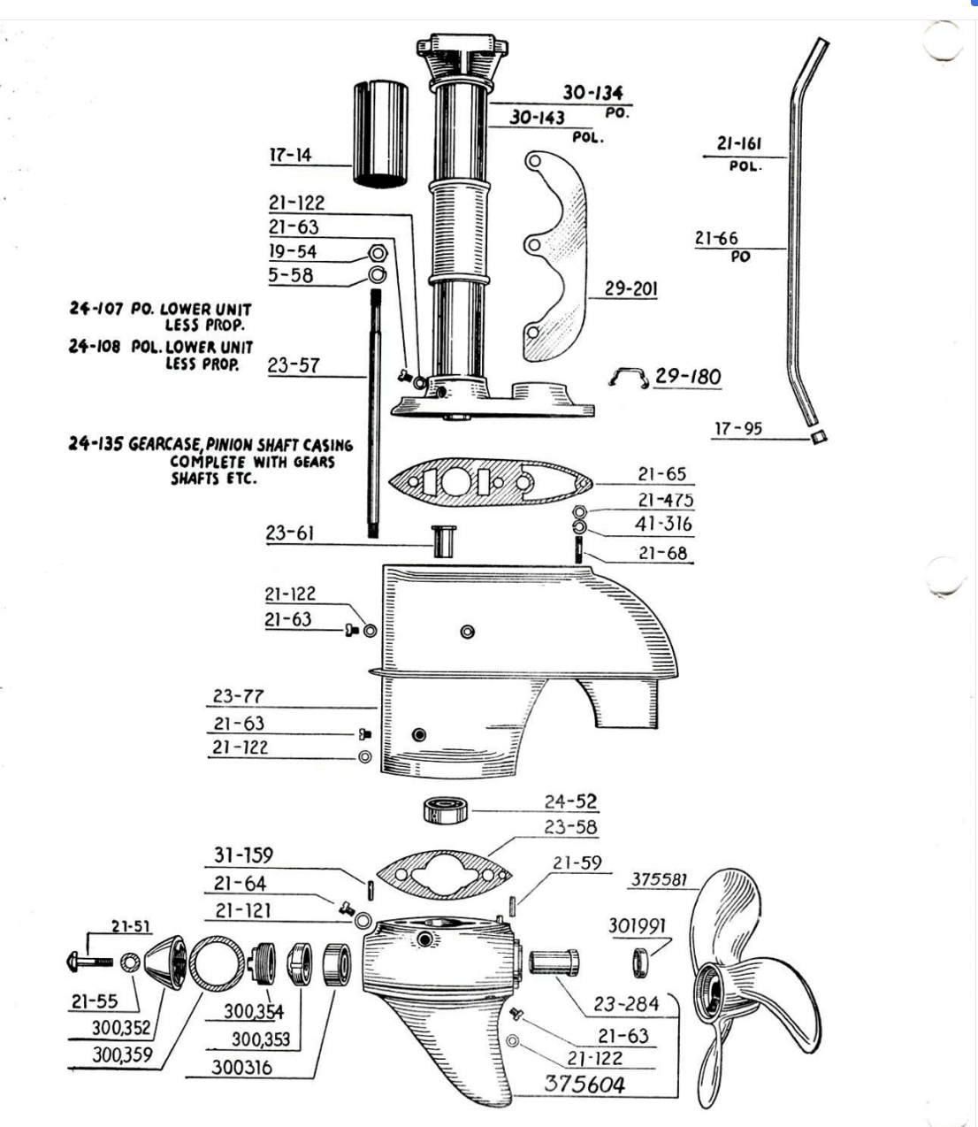

      I have lost one of the drain, vent, fill plugs from the lower unit of my 1948 Johnson PO-15. I was wondering if anyone has an idea where I could pick one up. I think that this plug is a 5/16 coarse thread. Thanks.

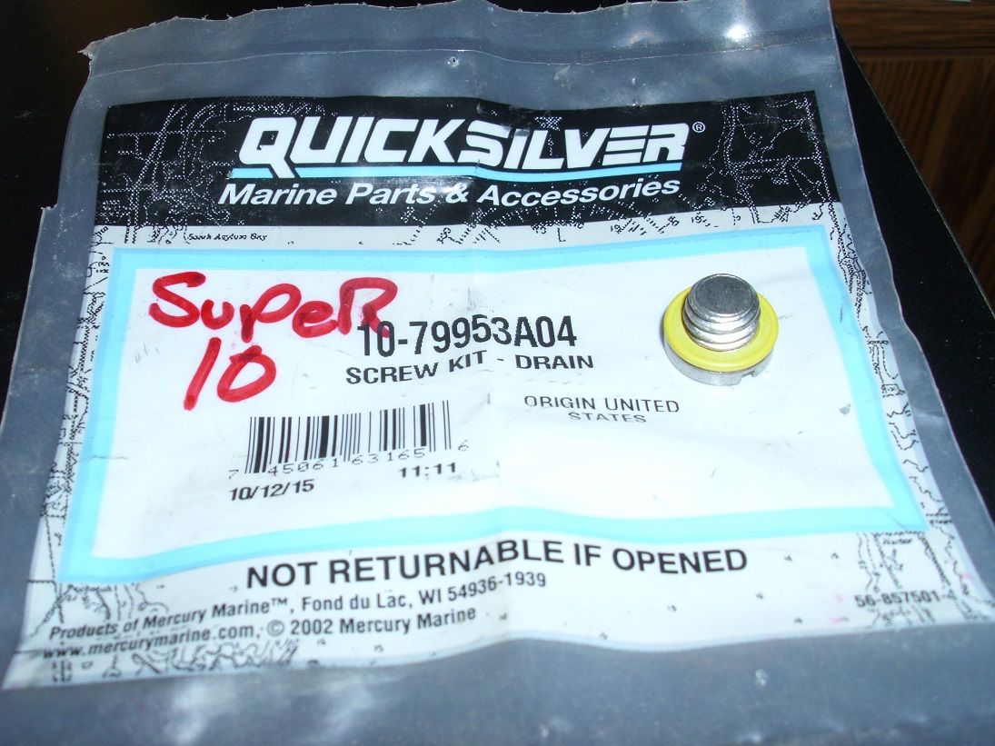

          I may be wrong But I think later OMC and Mercury will fit 5/16 coarse threads.

            The 21-63 in Gary’s part’s blow up is the plug; for sure. I have tried late model OMC plugs which are larger diameter. I will check out other year’s plugs and Merc plugs as well. Thanks for the help and ideas. I was thinking that a Member might have a plug in a tray somewhere…….

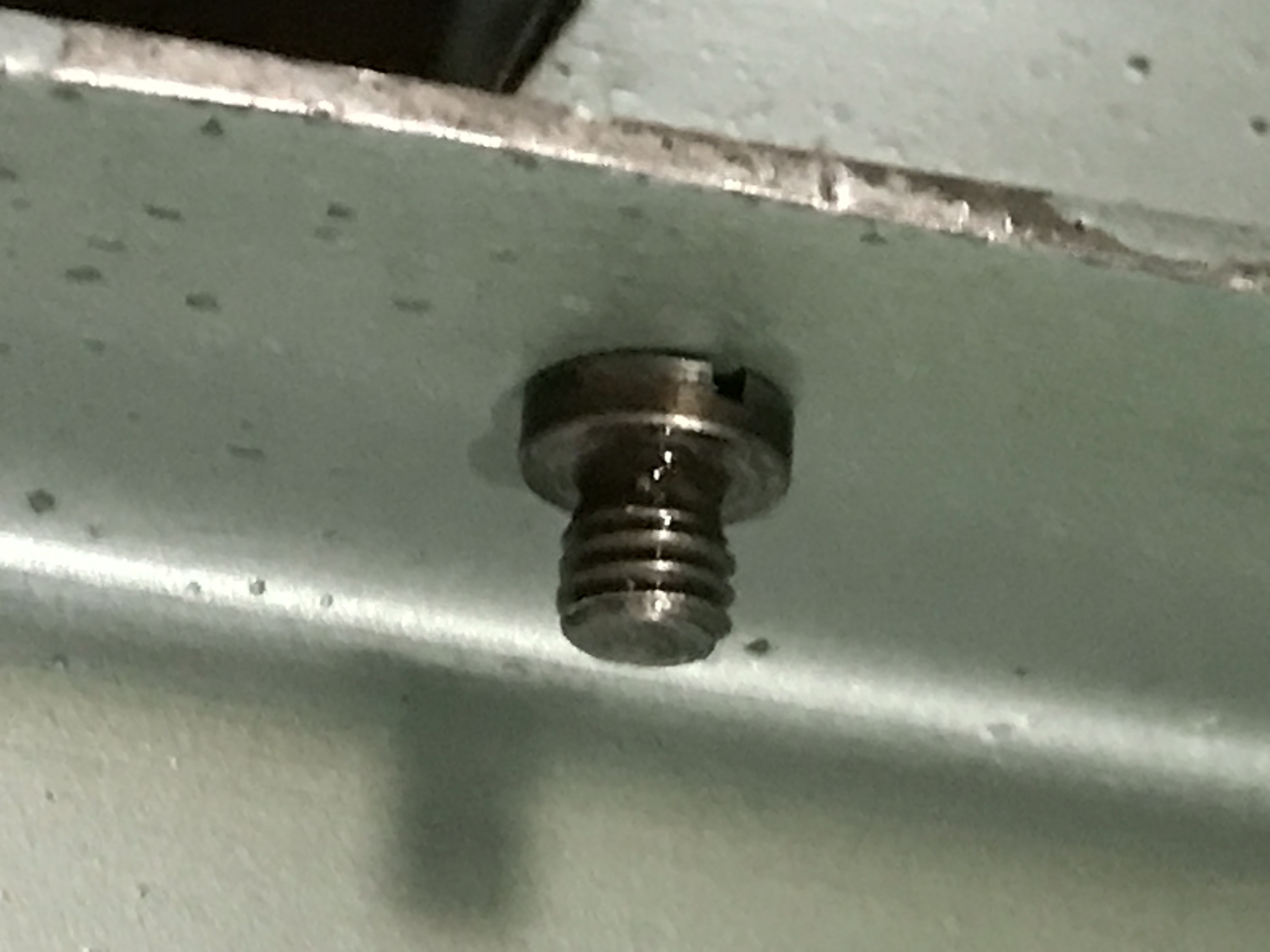

                If the head diameter is to large grind it down.
                #70105
                sandpoint1
                  Great information. Thanks a lot; just what I needed.
