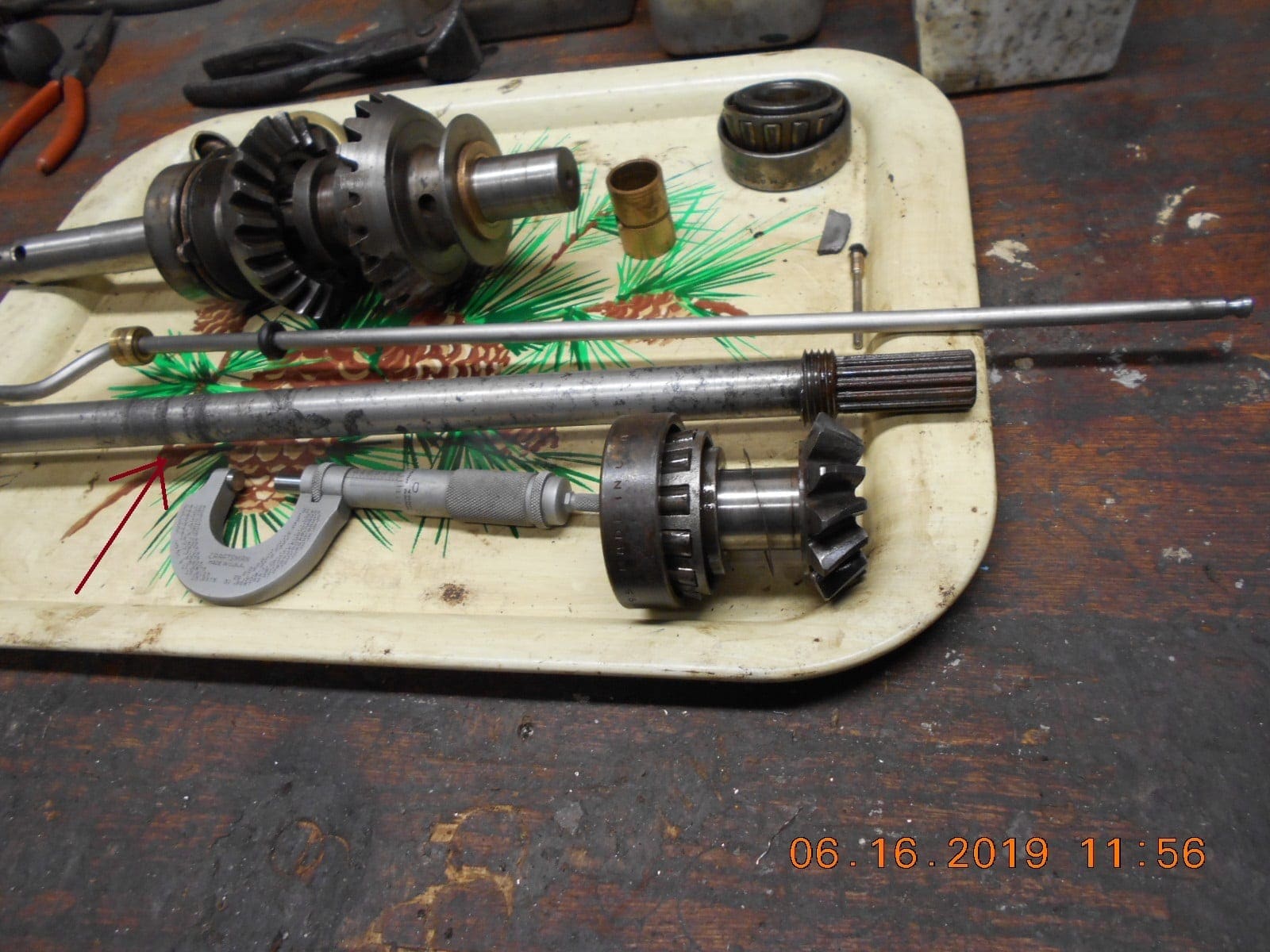

      I’ve address most everything in the gear case on the 1962 Gale 40 hp with
      the 1955 ish Evinrude lower unit, with new bearings, seals, etc. on the way.
      I would like to do something with the driveshaft “seal” area. It has the typical
      grooving and pitting. I’ve tried JB Weld in the past, and that lasted about 5 minutes.
      A speedi Sleeve is probably not an option with the repair being needed so
      far from the end of the shaft.
      For those of you that repair your own via welding, what process do you use?
      Type of welder, rod, etc. Also, do you turn down the weld on a lathe, using
      a cutting tool, or a grinder attachment?
      I have a little wire feed MIG welder (which I suck at) and a lathe. Tips appreciated.
      Thanks.

            I’ve repaired shafts by replacing the damaged section and welding it with stainless rod (308?) before cleaning it up in the lathe. Spray welding and centreless grinding would be the preferred way.

              Mumbles, thanks for the information! Replacing “sections” of a driveshaft may be beyond
              my current skill level thus far. Alignment might be an issue for me! Do you weld them
              in the lathe?
              I’m aware of spray welding, but that is probably not something “Joe Blow” can do himself?
              Also not aware of anyone locally here in the sticks that does that service.
              No idea what “centreless” grinding is, but will research that, and check out the Maple Leaf site.

                    As I was messing around in the garage today, looking at the driveshaft with the grooved seal area below
                    the water pump, I was wondering how successful it would be to “sleeve” the drive shaft seal area,
                    making the 5/8″ shaft 3/4″ in the seal area, and using the appropriate size seal, assuming I could
                    find the correct size. I believe the seal bore is a little over an inch.
                    Anyone have luck with this type of repair?
                    What kind of sleeve “stock” would be best suited, that could be silver soldered or bonded
                    to the shaft with epoxy, etc.?
                    #177730
                      How about Speedi Sleeve ?
                      #177734
                        Thought about a speedi sleeve but not sure how you’d drive it over the splines
                        on the drive shaft, then another 10″ or so, without destroying the sleeve.
