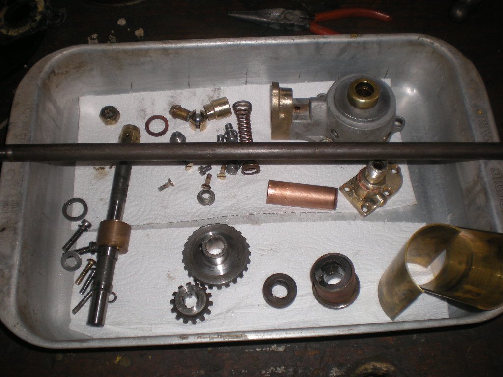

        Here’s at 1940 version taken apart, should be very similar.
        Getting the pump discharge line disconnect was the hardest part if I remember
        correctly.
        Sometimes the pump plunger wears out, the came on the prop shaft, springs
        break, and the check balls can deteriorate, plug up, etc.
        See attached manual below.
        DSCN6213
        1939-40-Johnson-5-hp-LTATDT-Parts-Manual

        #244668
          If it doesn’t pump anything at all start with
          looking for a stuck check ball.

              I took the pump apart and the small check ball was stuck so thanks for the tip. Now does the lower unit get marine grease and do I pack it in or just coat the gears and prop shaft ? I have to make a new gasket for the housing as I was a little over zealous taking it apart. Other than that it looks ok except for a pretty good wear mark on the back end of the prop shaft.
