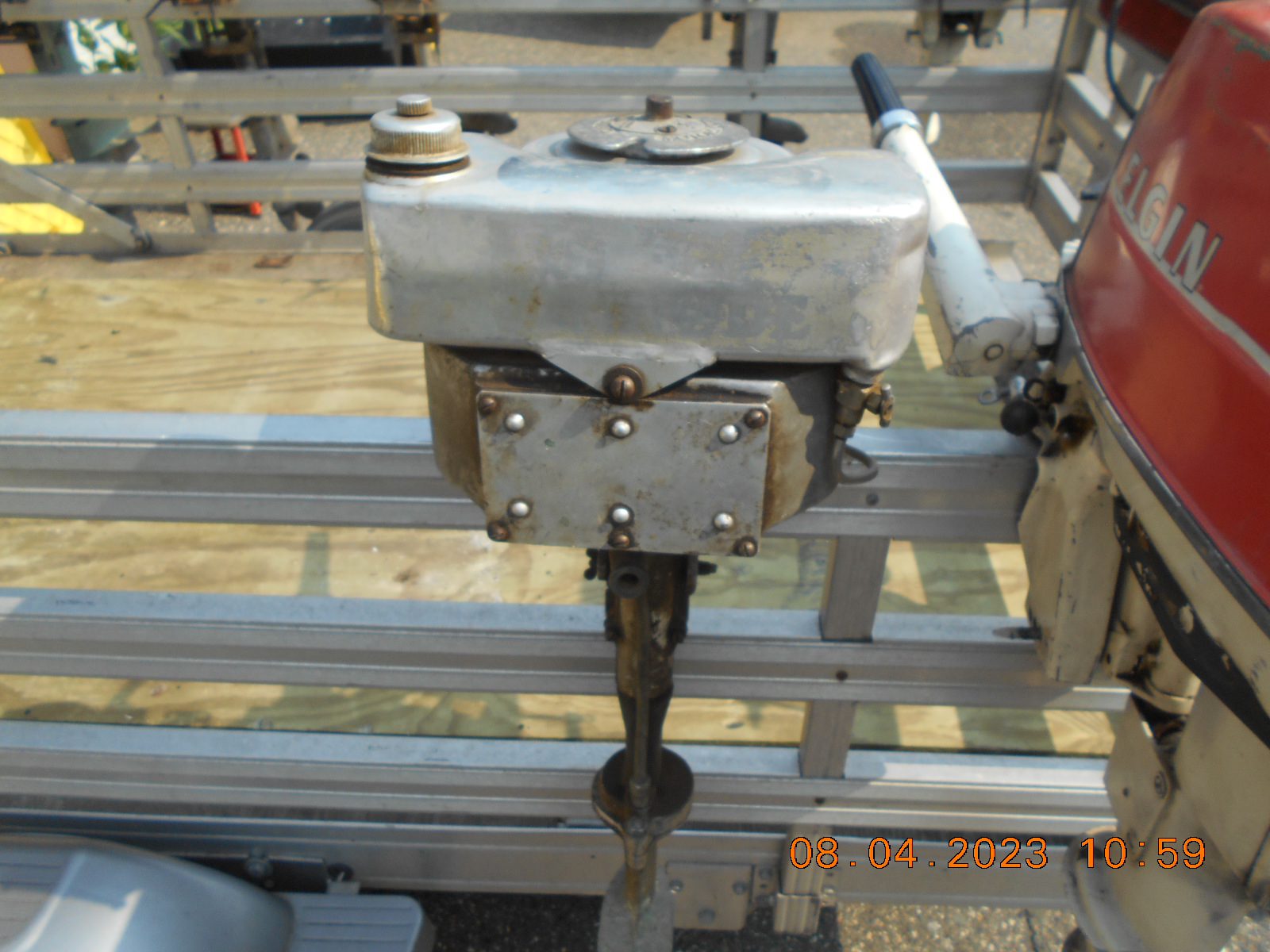

This followed me home from Tomahawk. Other than a missing
tiller handle, it looks hopeful.
I can find no model ID number on the rope plate, nor any
on any of the core plugs.I did find number 4070053 stamped in the tiller mount, but
even that seems too long for a serial number, and not sure that
they stamped parts numbers?There’s a faint “Evinrude” decal on the back of the motor,
and the rope pulley only says “Outboard Motors Corporation”.Any way to ID this motor for sure?
In researching on the Net, the closest thing I can come to is
a circa 1932 Evinrude Lightwin.Thanks.

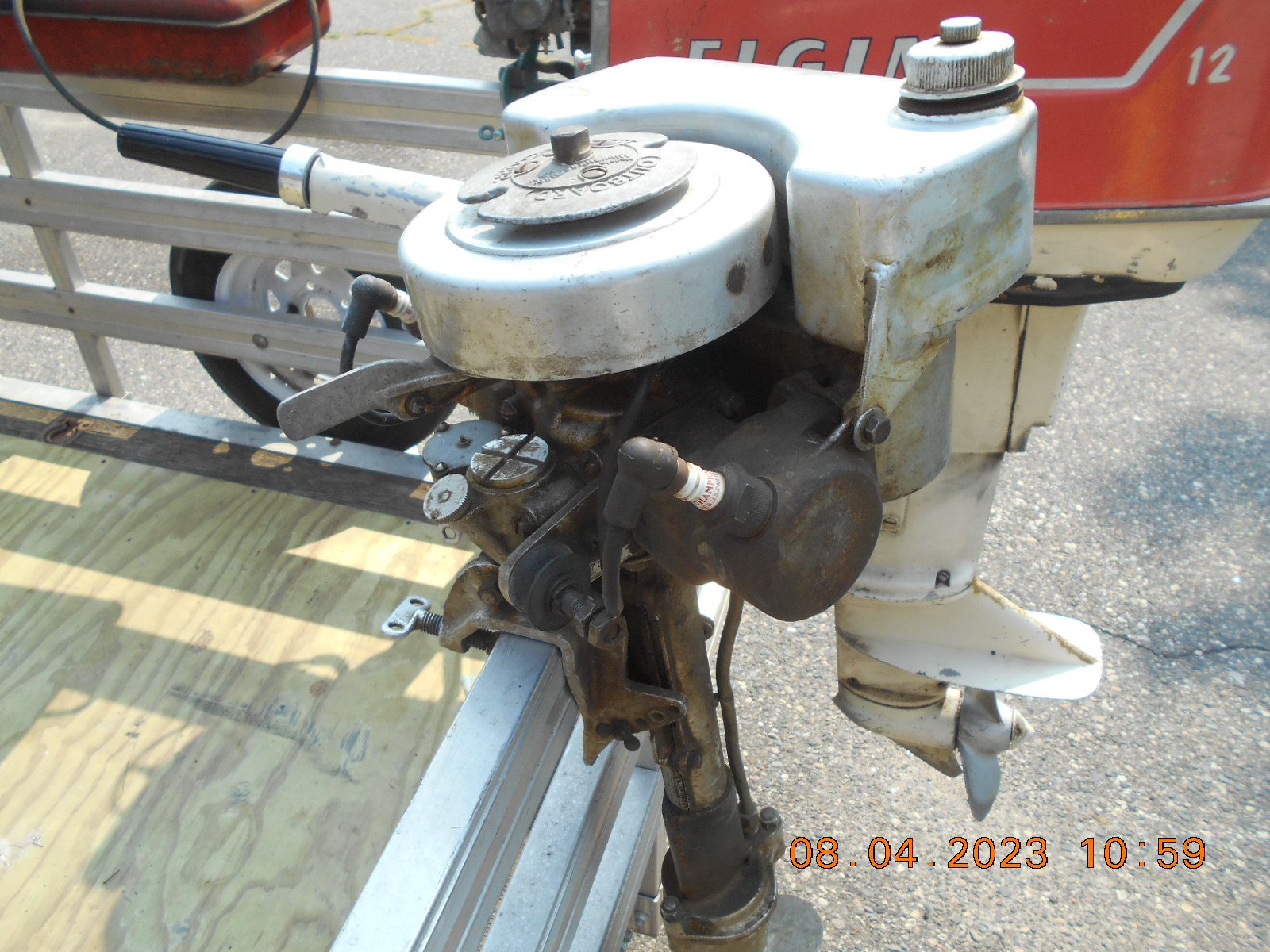

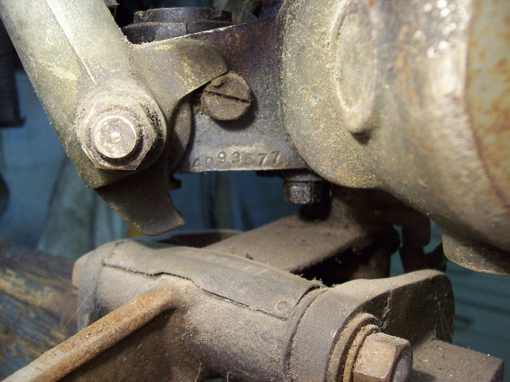

August 5, 2023 at 10:51 pm #278852This first picture shows where the model/serial number is stamped on a similar 1932 model 409 4HP Sportwin with brass lower unit. It is stamped on a metal tag in front and on the tiller bracket.
The 2nd pic shows a 1932 Evinrude 4HP Lightwin model 407 which should be your motor.
The main differences are sometimes the decals.August 6, 2023 at 8:33 am #278859Thanks Harry. The tiller bracket model / serial number on your 409 photo is
in the same spot I found mine. Mine doesn’t have the brass tag on the
transom mount……. I’ll have to look to see if there’s rivet holes for one.
