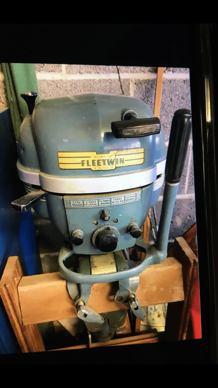

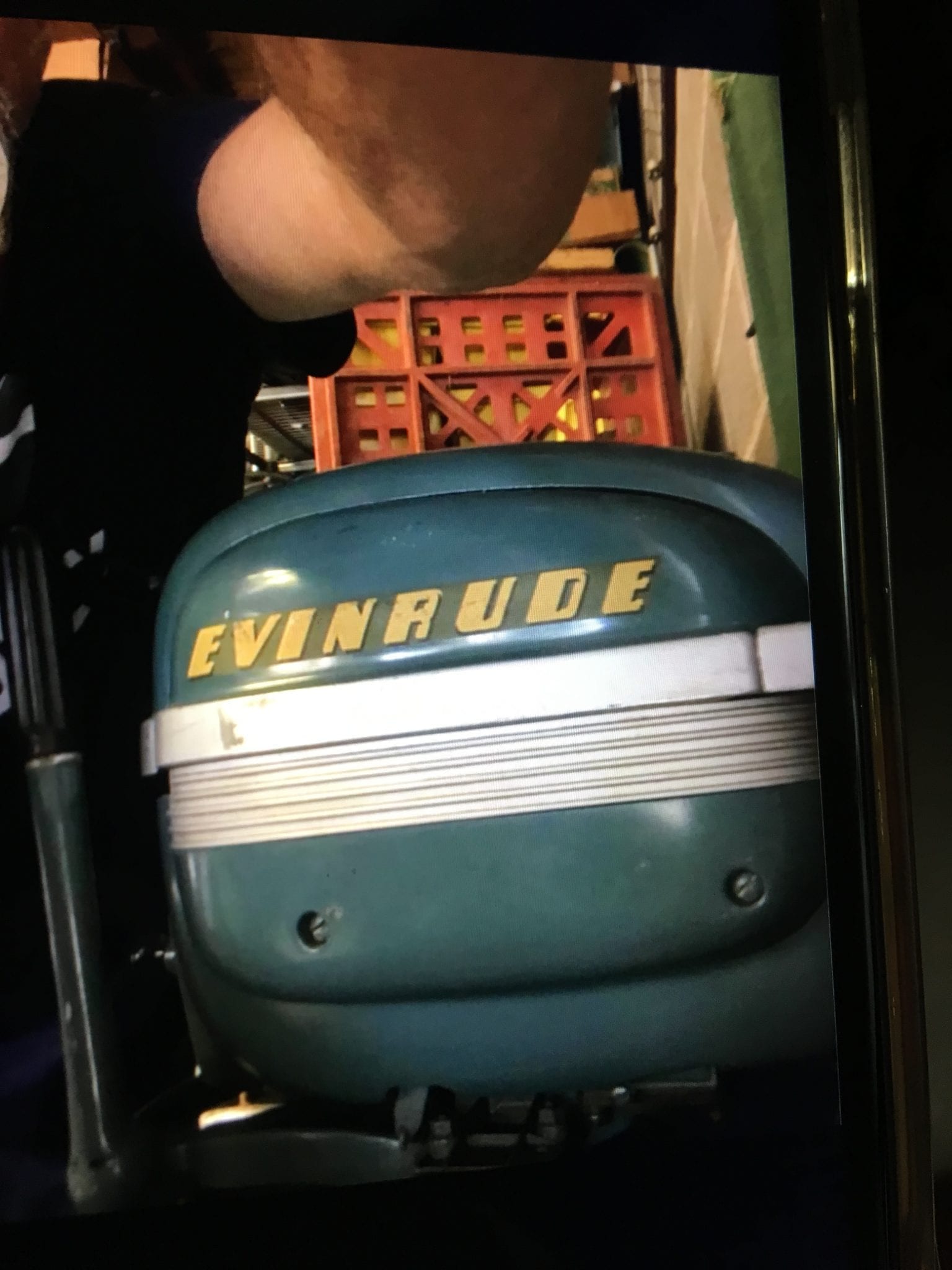

            I didn’t think it had the universal magneto. But if impossible to find ignition parts I may pass. I like to make them run. Not looking for a wallhanger. Other than pulling the flywheel , any way to know what ignition it has? I have pics but not a model number at the moment.

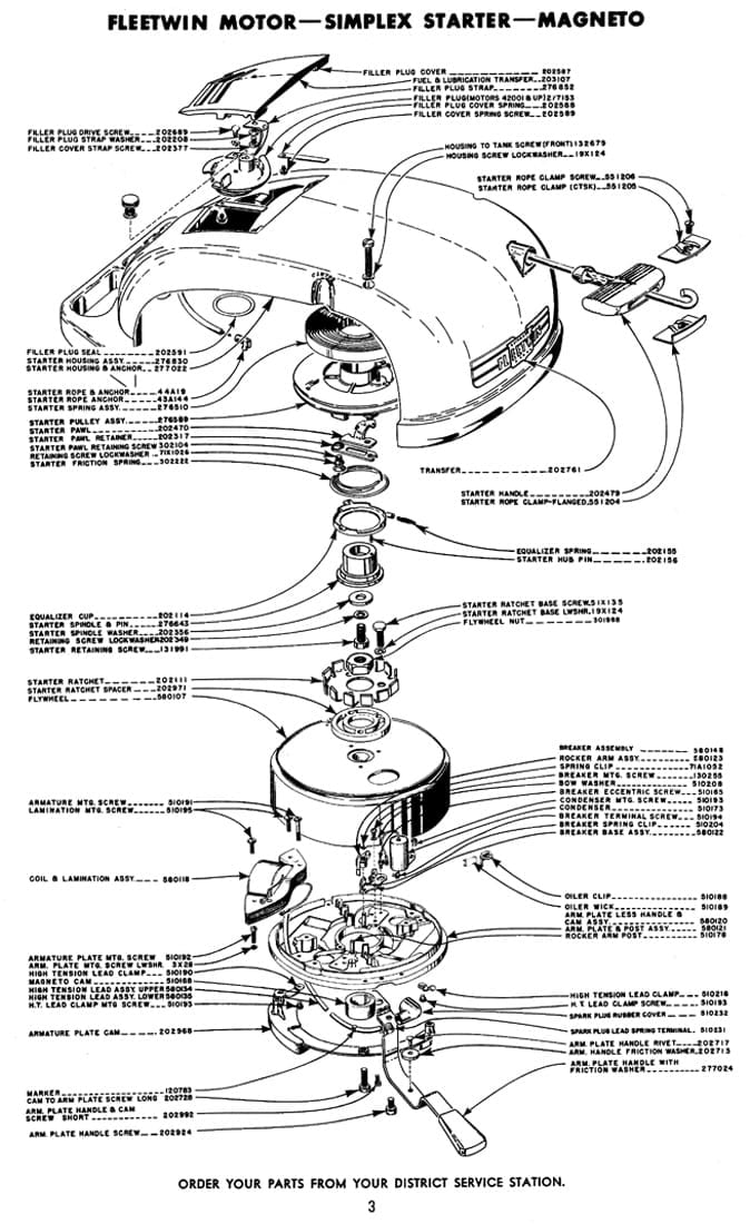

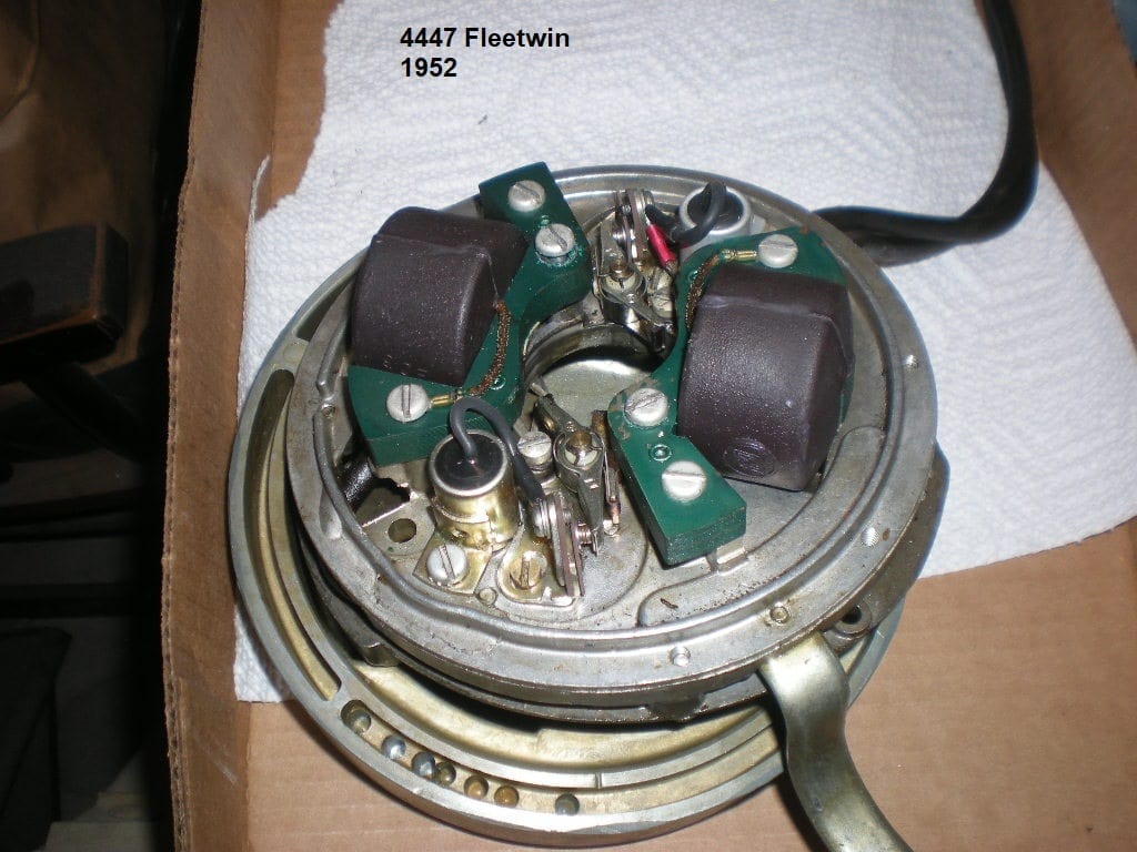

              1952 Fleetwin model 4447 is what I have.
              4447-magneto
              52FleetwinB
              #218248
              Dale
                Yup just like Buc says, my ’52 has the standard coils also! The low speed adjustment is left hand tread. Not a bad motor, the gearcase can be a mystery! That motor looks good, it has a screw driver in the handle. You probably know that!

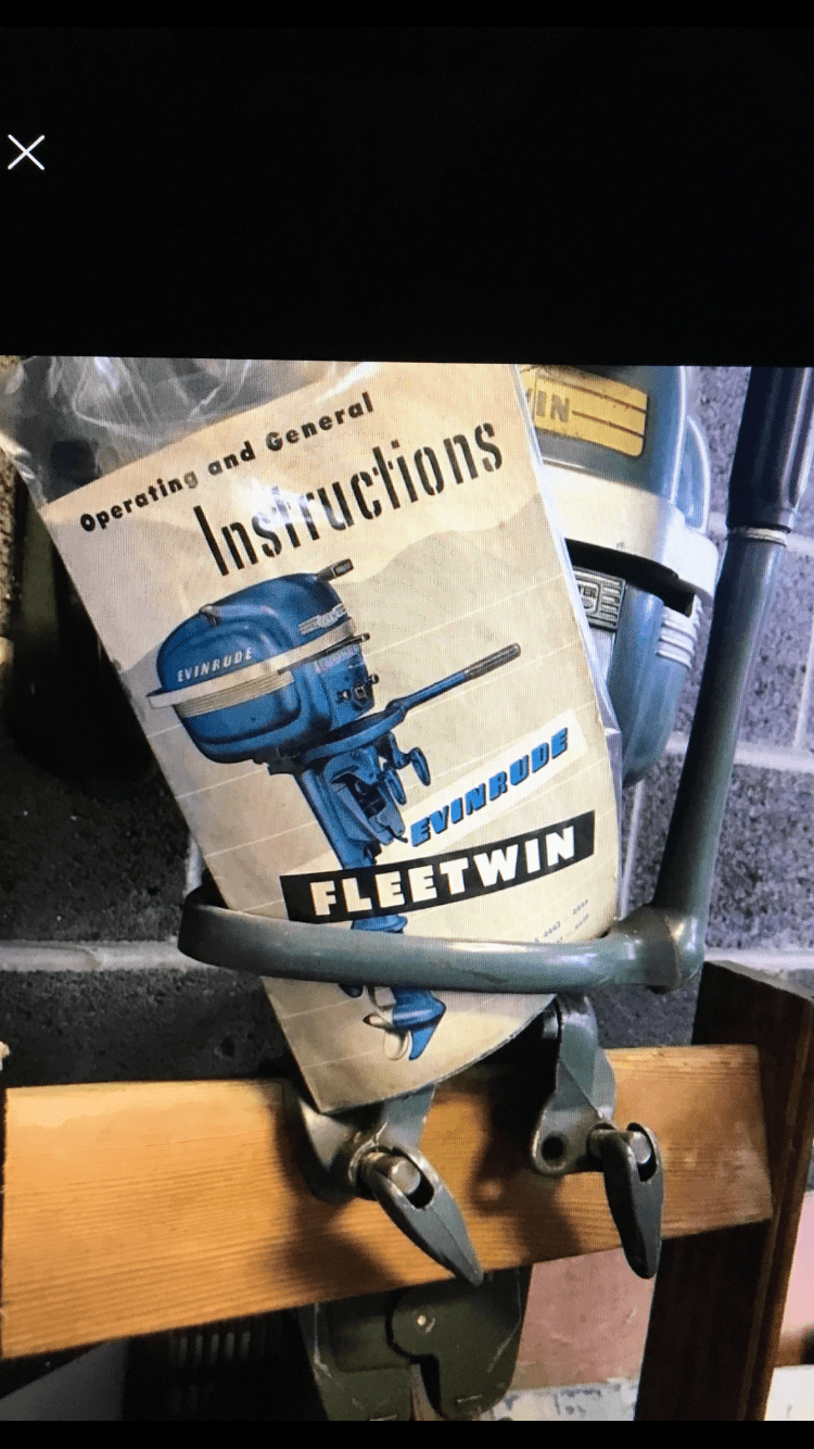

                  This is model 4443. If my search was correct this also has the universal magneto And I had forgotten about the screwdriver in the handle! I think it may be worth a shot
                  #218254
                  Tinman
                    Well, couldn’t pass it up very clean motor One owner I’ll Post some more pics once I get home and cleaned up And the screwdriver in the handle is pretty cool! And came with the original owners manual. Have to learn more about the carb. And figure out the impeller.

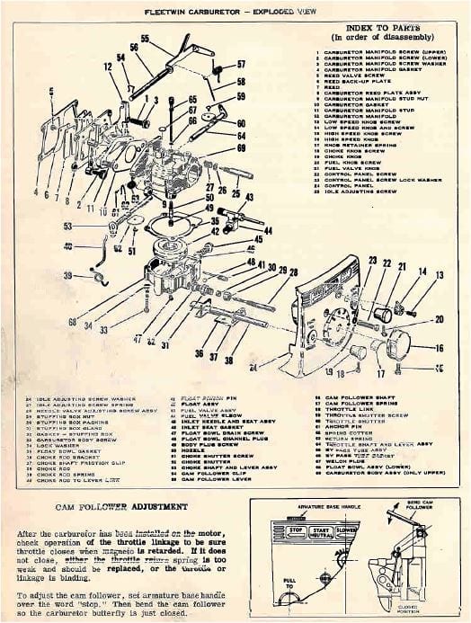

                    #218256

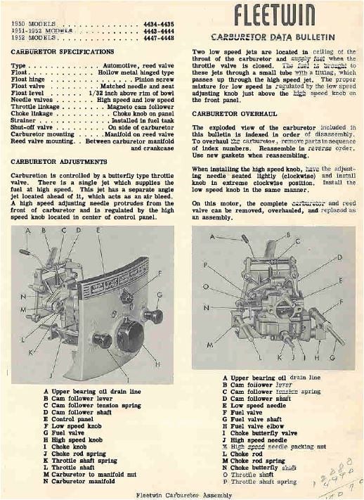

                      I’m quite sure your motor has a Tillotson carb on it. Maybe not though.
                      4443-Carb-2
                      4443-Carb
