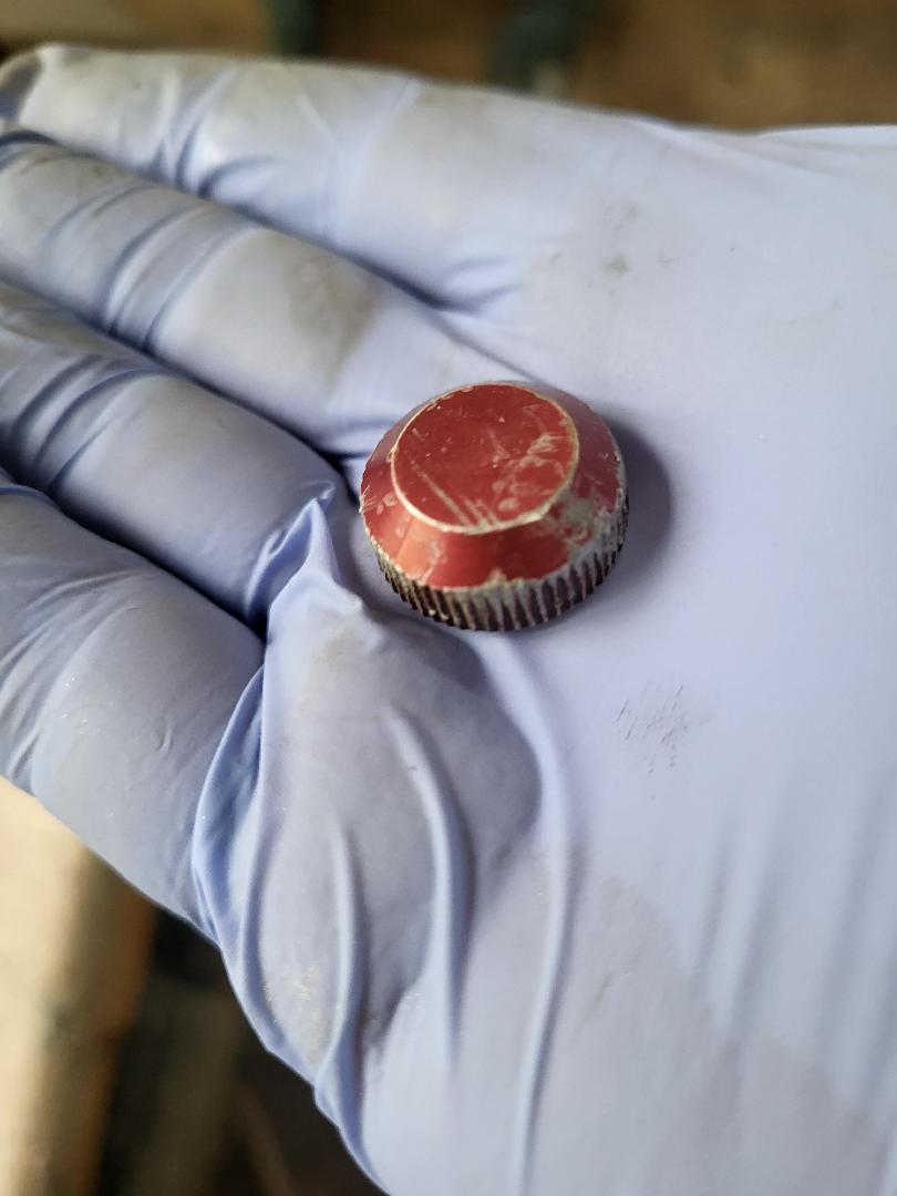

Anodized aluminum.
June 15, 2022 at 6:19 pm #261533
After polishing spray with several light coats of transparent
candy apple red. Pretty close but not as durable.
Tubs.A "Boathouse Repair" is one thats done without having tools or the skills to do it properly.
June 15, 2022 at 8:39 pm #261541tubs I got the idea from you and used it on my 58 Evinrude 35 hp where the chrome is actually painted red in a thin stripe. It worked great. Kinda pricey at advance I believe is where I got it
It's a jungle out there.
June 15, 2022 at 8:46 pm #261542
You can get small spray cans ( Testors)
used for painting model cars, planes, and the like.
June 15, 2022 at 10:11 pm #261543I use nail polish from the dollar store for touch ups on motors and…cars ….. lots of shades available …you can even mix colors
June 16, 2022 at 6:22 pm #261559I have red spray paint but I thought that that paint looks way too thick on the knobs. To me, the original color on the knobs looks very thin. I don’t know how to “anodize aluminum” so I was hoping there was a spray paint that would very closely match.
June 16, 2022 at 10:41 pm #261572The red transparent or translucent paint is what your looking for it has a “chrome red” lid. Advance has it or as tubs said restore brand model car paint of same color

June 17, 2022 at 9:19 pm #261608It was supposed to say testors brand but it didn’t.
